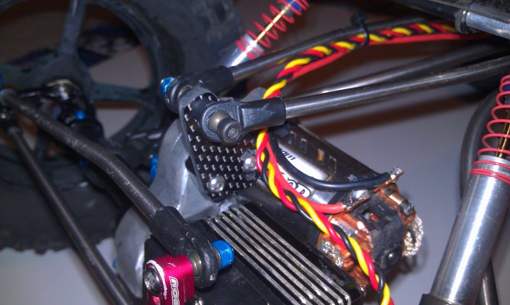

However, you are going to HATE that servo horn sticking up there like that. It will get hung up on any undercut you push the truck up against. Why not rotate the servo 90* and let it sit between the motor and tube?
No way it will fit there, unfortunately.

That was my first impression as well when I measured it. After I mod the case and move the motor I will know for sure. I may even be willing to get aluminum tubes for the long sides and notch the hell out of them to get that 7980 to fit.
For now I am not worried about it, I think I will manage just fine with the servo horn sticking up.

That was the original plan, and it still may happen. First I need to get ahold of the jig and mod the case to move the motor up and back. Then I will know how much room I have and if I can notch the tube enough to fit it in there. Time was short and this was my remedy. I will have to deal with it for now.

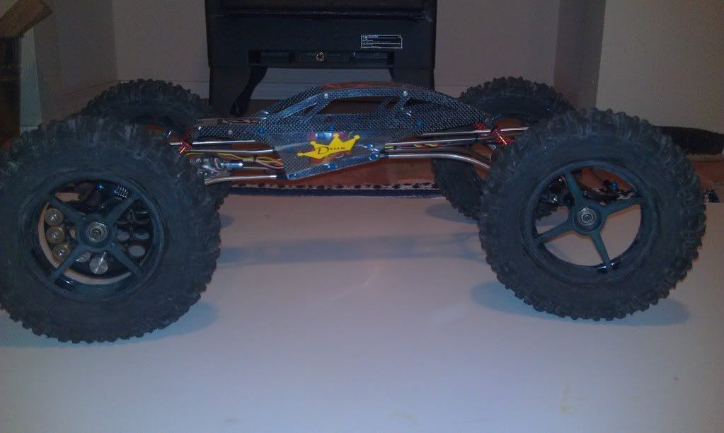

I ran the super at its first comp yesterday. It worked well. I am liking the light weight, climbed right up some stuff other guys could'nt. 6oz of knuck weight per side seems perfect. I need to order a pair of BRXL's for it becuase the FXR's wont hold it.
Figured it was time for an update. Nothing has realy changed, but it is all working well and holding up just fine. I did finaly get the aluminum rod balls and got those installed and have a new RTR weight of 6.37 lbs. I stilll have some steel hardware that needs to be replaced with titanium. And I still would like to change out the FXR's for some BRSL's to help with the rollback. And I am realy wanting a set of Infectious RC carbon wheels and some new super boss claws. My thinking is that with the carbon wheels I can possibly get down from 6 lbs, 6 oz to and even 6 pounds. :shock:

I made a few changes.
1. I followed the brilliant work of D-lux and swapped out my large 2nd Berg gears for large 2nd HR gears. (Thanks again Jeremey for trading your HR 2nds for my Berg 2nds). The HR gears are 52 tooth and 48 pitch compared to the berg gears witch are 42t and mod .6 pitch. The reduction in gearing is huge and just what I needed. Its nice being able to source 48p pinions easily. I am running 12t pinions. I only have a small amount of runtime on it so far around the house but can already tell the huge improvement in torque and drag brake.
The gear swap was very easy. It only required cutting the spacer off the large 3rd and using loctite to hold the bearing onto the end of the small 3rd. D-lux has a full write up and how to in his super thread.
2. TCS had a sale on SDS 300 3rd gears so I picked up a pair and tossed them in when I did my gear swap.
3. I finaly threw on my new and improved D-lux CF upper link mounts. I ran his delrin mounts previously. They are spiffy. Lots of adjustability.
4. The 7980's went to Hitech for warranty. Both servos had issues with the spline shaft "wobbleing" a bunch. They replaced the middle cases on both servos and they are 100% again.
5. I got bored and decided to take the dremel to the blast wheels some more. I did it more for fun and looks than actual weight loss. It shaved a couple grams per wheel. They are still plenty strong and I have no concerns. Just hope I dont catch a stick in there.
We have a comp this weekend and I cant wait to run her. The RTR weight is at 6lbs 4.8oz. Thanks for looking.
