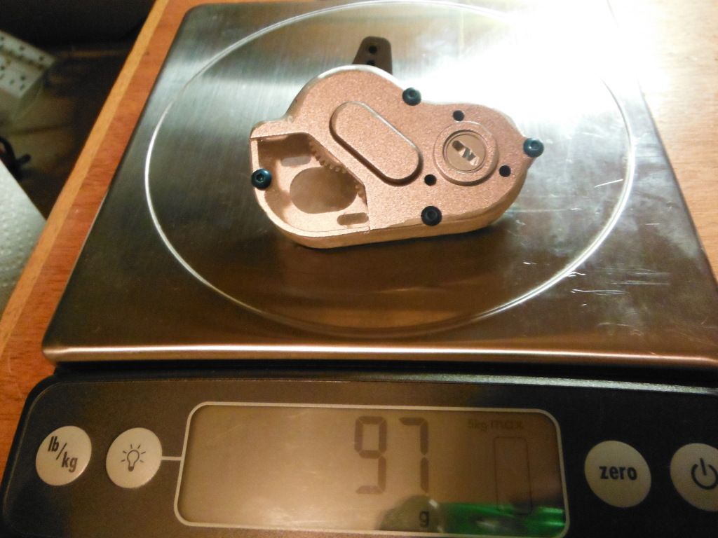

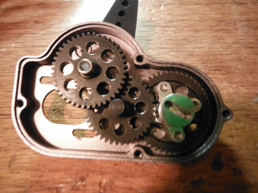

*Gearbox: Berg V1 with drilled stock gears, (Thanks JB), RC Bros lockers, Mann 2nd gears, and CKRC 3rd gears for now untill John's stock of SDS 3rds are availible. Dlux case cover. Dlux adjustable upper link mount. And case milled by Dlux. (thanks Erik).

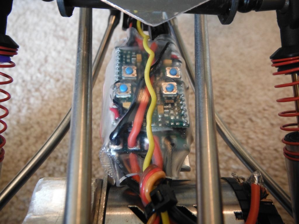

3. ESC's: Dual Tekin FXR's decased and wired/shrunk down with a pair of CC bec's in there as well. Mounted on Rowdy tray. (I had fun with this).

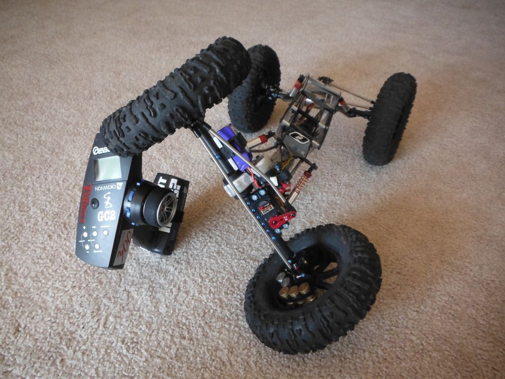

RTR weight with 12oz total of knuckle weight is: 6.36 pounds.

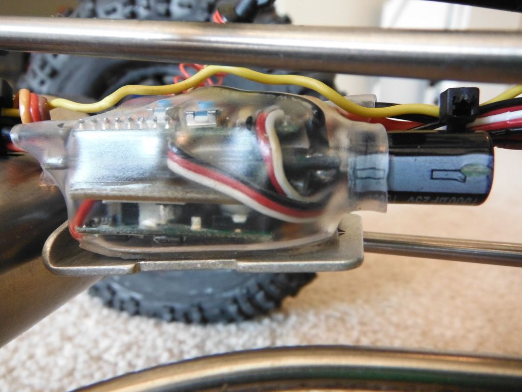

Dual FXR's, Two BEC's, One larger capacitor. Decased and consolidated by myself. They seem to be working fine. And I can still field program them if needed.

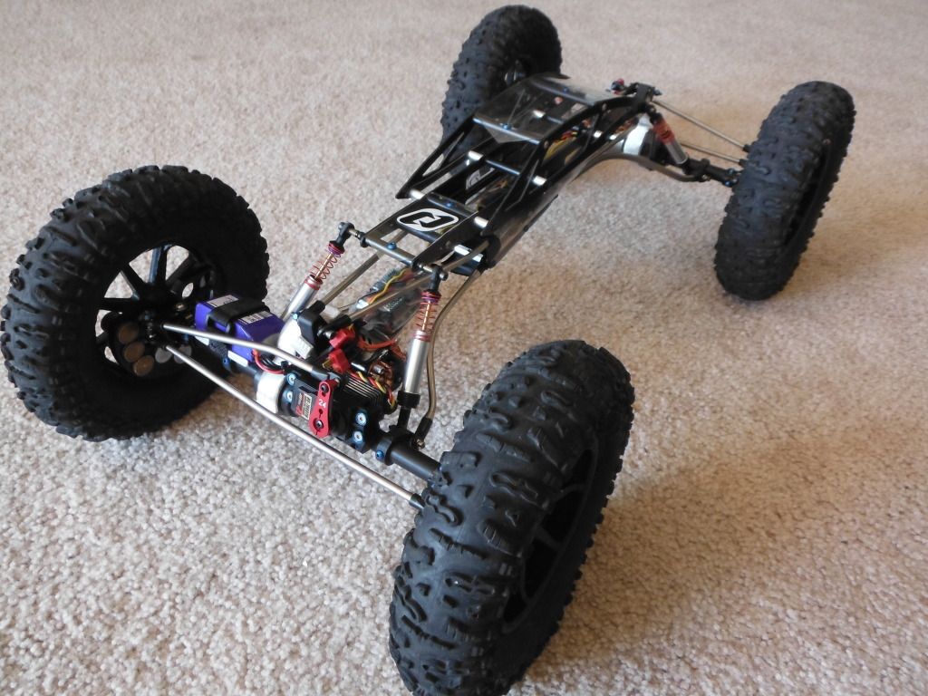

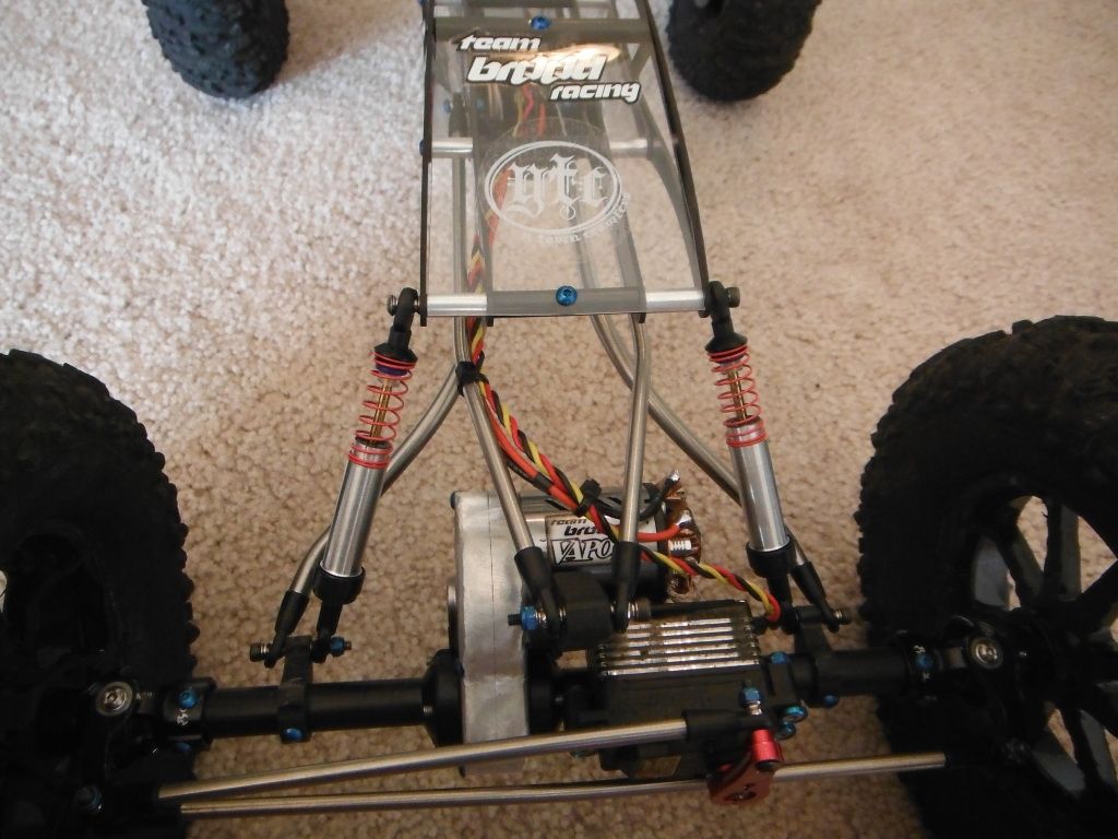

Here is a pic of the AX10/Bully/Berg hybrid setup.
Here is the gearbox full loaded with upper link mount. (thanks again to JB for drilling the gears).

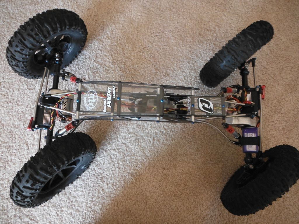

And a pic next to his 4 pound baby brother.

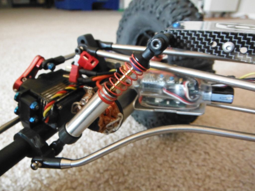

However, you are going to HATE that servo horn sticking up there like that. It will get hung up on any undercut you push the truck up against. Why not rotate the servo 90* and let it sit between the motor and tube?
Looks great!
Does the upper link mount contact the ground before the servo horn? That is the only thing I could see being a problem.

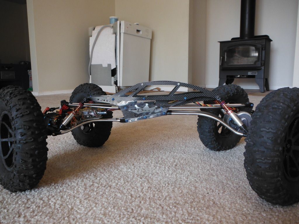

Looks like you used the same wide like the Superbullys???
should be around 14" track wide right??
That was the original plan, and it still may happen. First I need to get ahold of the jig and mod the case to move the motor up and back. Then I will know how much room I have and if I can notch the tube enough to fit it in there. Time was short and this was my remedy. I will have to deal with it for now.
Looks great!
Yes, the upper link mount will contact the ground before the servo horn.

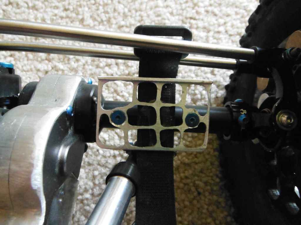

Great build or rebuild. Can you post picts of your battery mount?
Here you go. Its my very quickly made, artsy fartsy hand carved lightweight mount.
Yes, you are correct. Erik, Dlux did it first and I used his parts and design.
Looks a plate bolted to the lower link/shock mount "thumbsup"
Pretty much, although it is spaced just above the mount and mounts into the tube.

Overall I think you should be 1/8" narrower than a super Bully. It should just be the difference in case thicknesses and I think that is the measurement. "thumbsup"

I dont remember where I was at with the bully for track width? But with this setup I am 14 1/8" sidewall to sidewall.
