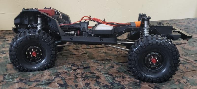

Thanks. Cleaned up the wiring, don't have the Rx installed yet. Need to setup the steering servo. No dig or od for this rig I may set it up later, its locked in low od for now. No tape on the ESC but its secure. This way I can plug into it easier I noticed when pulling out the plug protector and reinstalling it, it was a pain.

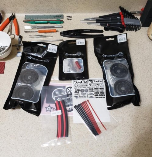

I had a feeling that I would have a similar problem that B-MOW71 had with his wheels and the VP 12mm stepped down hexes. I was right, the VP 12mm stepped down hexes will only let the wheel engage about 2.5/3mm just up to the set screw. So I ordered Gmade aluminum 12mm wheel hexes "8mm" after figuring out what offset I needed. My rubber should be here tomorrow too.

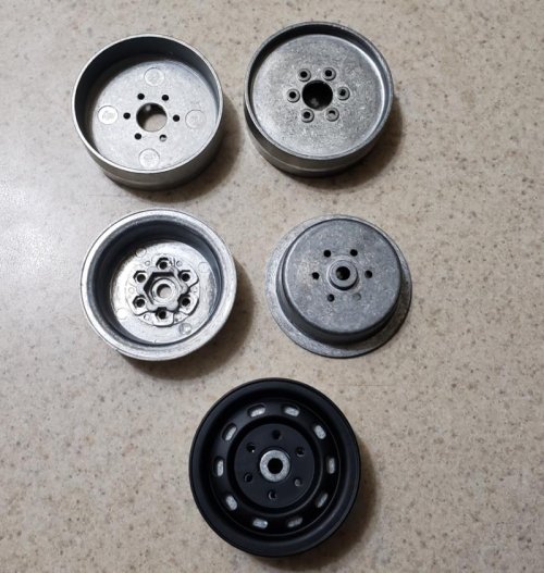

Here is a closer view of the wheels. The finish is bare metal, I just took a look at a set of Boom Racing 1.9 steelies and they do have a better looking finish. These wheel will work no problem but I'll need Gmade hexes to match the wheels. I plan to paint the inside of the wheels black and the outside that you can see looking through the face plate that is black dessert sand to match the body.

The wheels don't have removable hubs and aren't stepped inside to match the hex. The wheels will go on but only up to the set screw of the hex. So I ordered Gmade 12mm hex at 8mm thickness that are flat to the outside. They will be here today, I'm waiting by the window drinking coffee. "thumbsup"

I think there cast due to the pigment and the way they have built in hubs. That would also explain why I had to clean up the lug nut holes with a pin vise. There nice and heavy, can't tell you how much they weigh the only scale I have is a RCBS reloading scale. Grains not grams could convert but the wheels are too heavy for the scale.

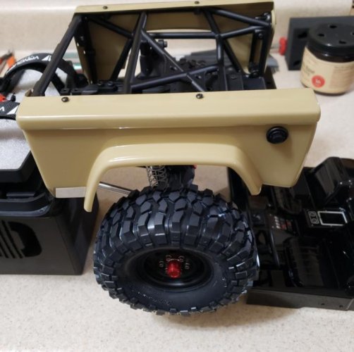

Good day for painting, still drying. I didn't mask the rear lights, I have a plan.
