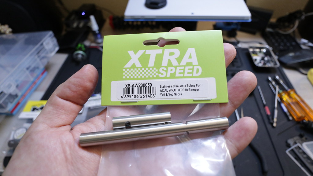

Xtra Speed Stainless Steel Axle Tubes

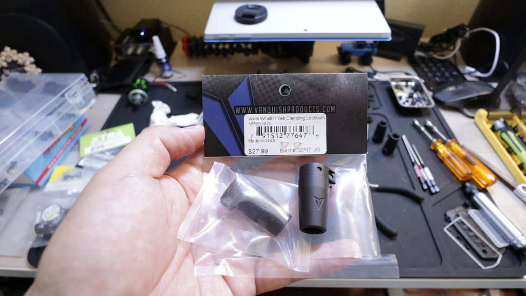

Vanquish Products Aluminum Wraith/Yeti Clamping Lockout

Time for the Xtra Speed Axle Tubes
Axle tubes are in

Vanquish AR60 Rear lockouts

Xtra Speed Axle tubes going into the front axle
The tubes are all in
