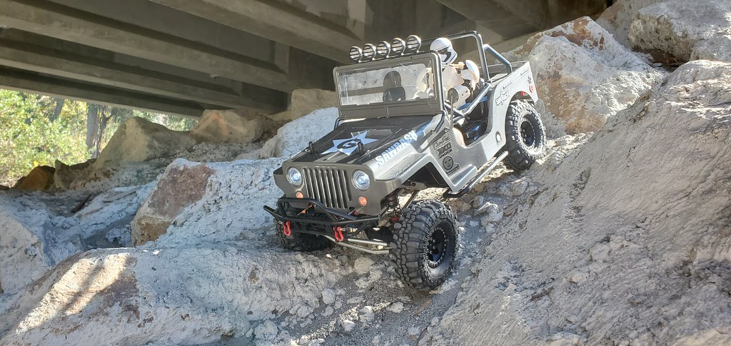

Why are your knuckles on upside down/ on the wrong sides? One of the benefits of the zero ackerman knuckles is that they also allow you to mount your steering linkage up higher, out of harms way.
I've been following along, so I don't know why I just noticed...
Hah! I forgot all about that! I think this was something I wanted to revisit a couple years ago, and just forgot.
The reason I have it upside down is because of the draglink/servo horn. If I raised it the right side up, it would cross over the servo horn + draglink. This was actually my first crawler kit, and back then I didn't have as many parts accumulated as I do now. I think the servo horn might be too long, but I used it because it's what I had.
Now that you've reminded me about this, I'll need to check if it is just the servo horn that is causing this or if I can raise the servo up higher without hitting anything on compression so I can flip the knuckles. I really don't remember!
