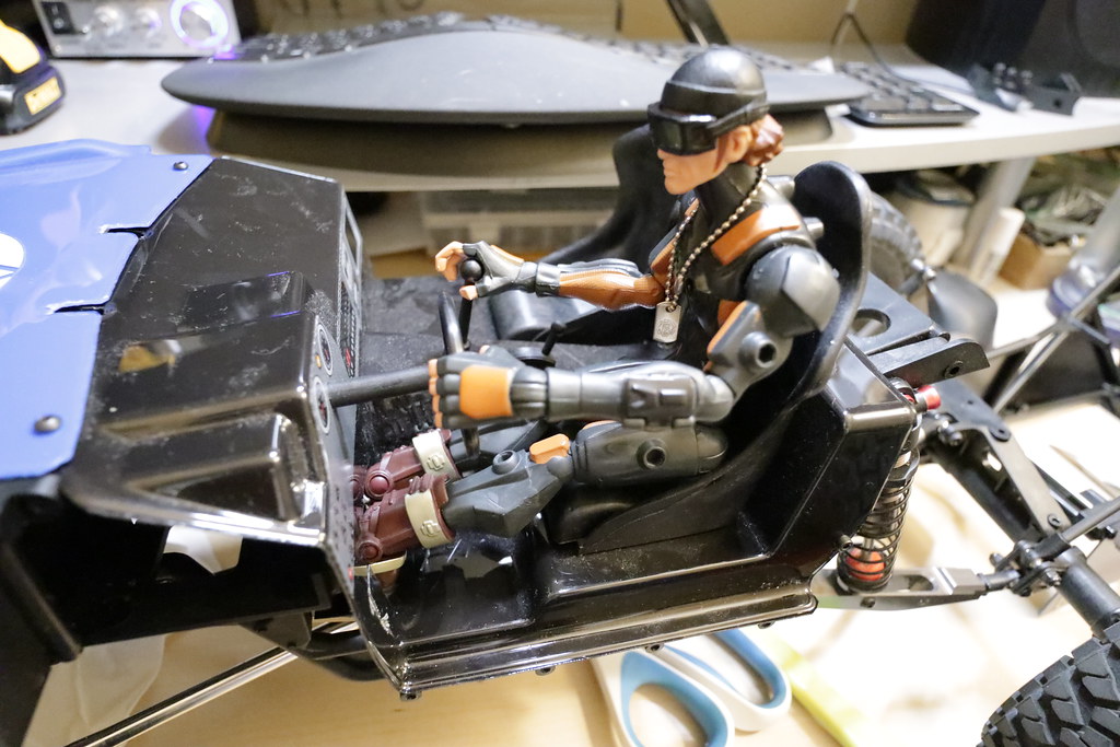

Finally decided on a driver for my GOM.
Tunnel Rat from GI JOE Sigma 6 line
On Another note... I spent time thinking about how to protect the shifter slot for the 2-speed transmission.
Do I cover it with lexan, somehow make a rubber boot?
In the end, my head was already fatigued from work and I just thought... 3M Tape.... piece of felt.... it'll work. LOL

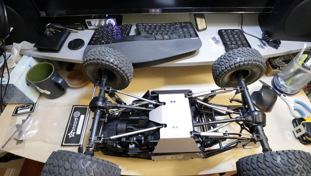

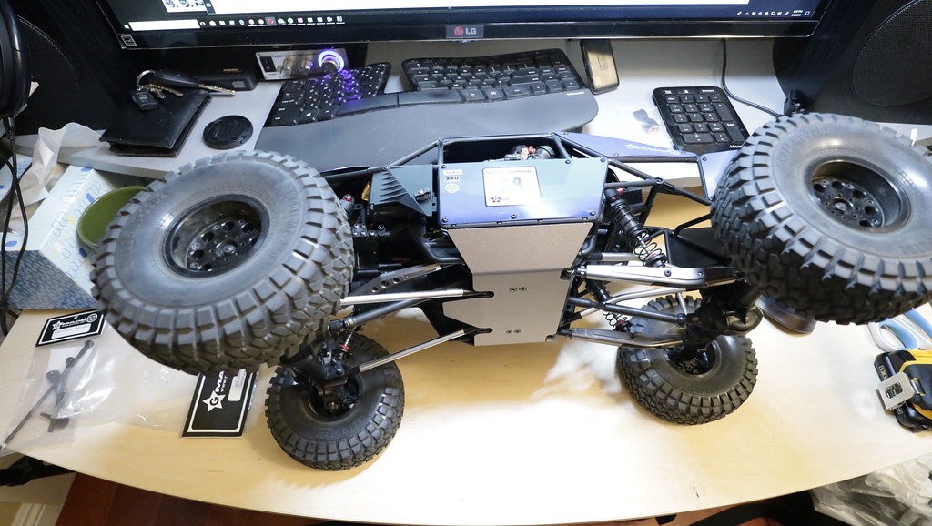

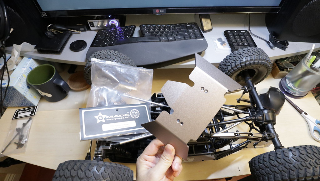

Finally installed the last 2 upgrade parts that I have on hand. (Although I'll probably upgrade some more parts as they are released in the future).
First was the GMADE Aluminum Skid Plate (available on eBay) to give the bottom a little more protection and give the bottom sides an angled flat surface to prevent getting hung up. It also has a minor protrusion to protect a little of the 2-speed transmission area.

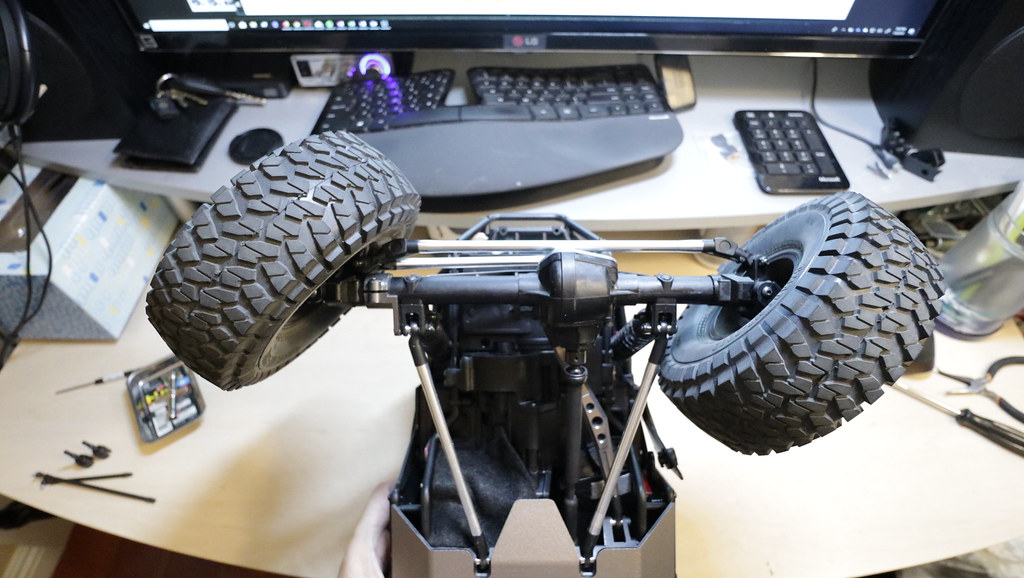

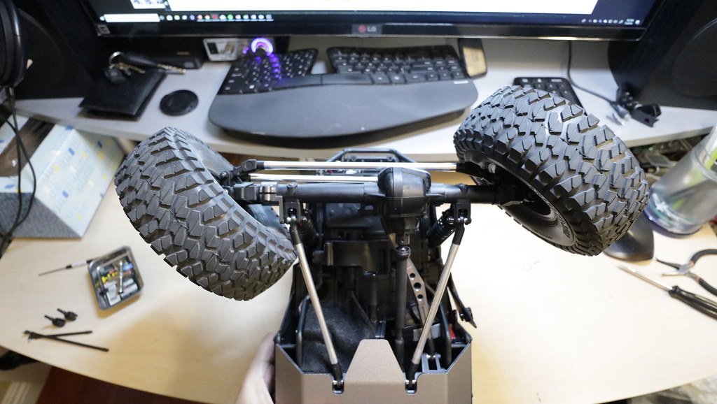

Also got around to installing the GMADE CVA/CVDs. Holy Moly what a difference in steering angle!!! I'm going to need to spend some time adjusting my steering end points.

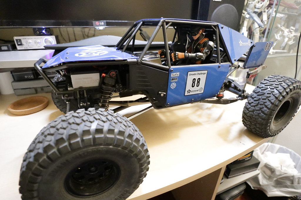

My fave driver figure ever - I normally can't stand any of them... very nice looking GOM!
Wow that is a pretty big difference in steering angle from those Uni's.
I dont think that felt mod is bad at all, it should have good flexibility and do a good job of keeping crud out.
Great work Soze!
