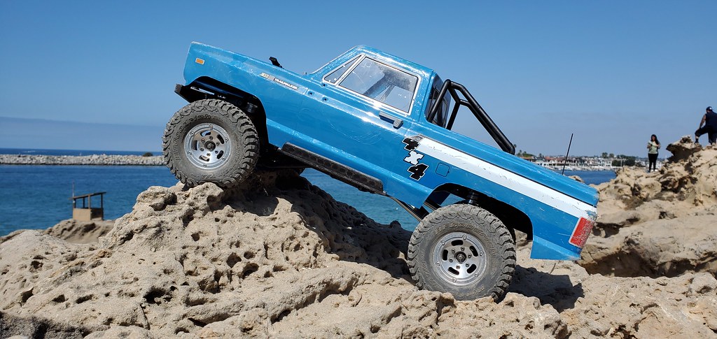

This is the first run after I installed the Red springs in the front and the Club 5 High Clearance links. The links worked out great, but the Red springs might be too soft. I might just go back to the stock harder front springs. The softer springs look fantastic when just driving over terrain, but on technical climbs, it seemed to allow the skid to bottom out too easily.
It could be the combination of having softer springs and running class 1 sized tires though. If I ran 4.5-4.75 sized tires, the red springs might actually turn out great. This being my class 1 tire sized rig, I'd probably need stiffer springs to prevent bottoming out.
