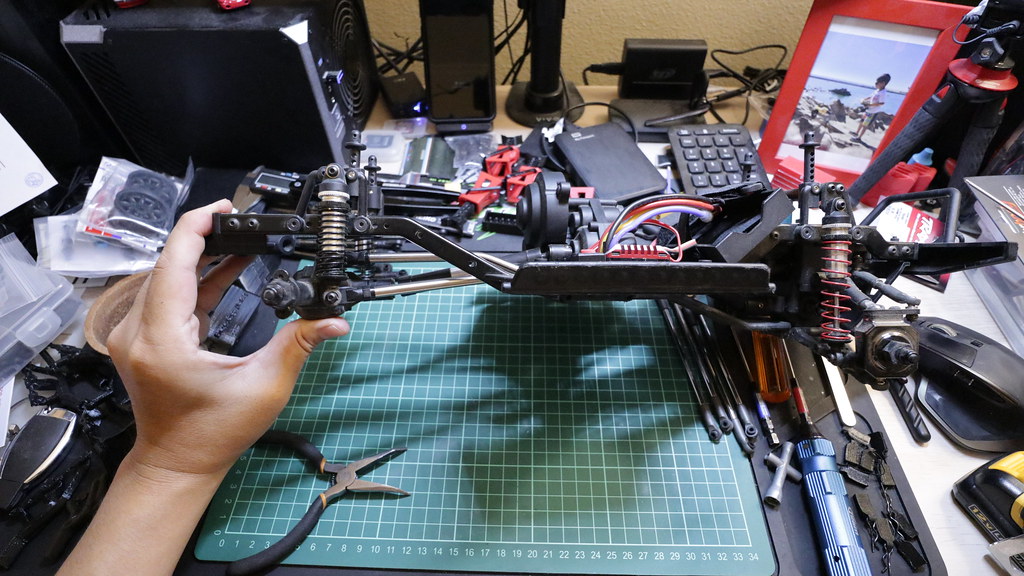

Just catching up on my Trailwalker updates...
Alright so this run was bittersweet for me. I didn't get much footage for a reason.
I threw on the Gearhead RC Slot Mag v1 wheels (Thanks Jato) and Pro-Line Class 1 BGF KM3 tires in G8 Compound.
First the good... This day kind of opened up my eyes to the capability of the IFS setup when it conquered 2 very difficult lines that I thought this setup had no business doing and didn't expect for it to. Holy smokes it got the wheels turning in my head on how to tune the truck to make those lines more consistently.
Now the bad... I didn't get any of those difficult lines on video! None! Nada! (Don't worry, I got another video coming from the following week where I did capture it on video).
Also bad.... The reason I didn't get much footage is because the damn rear upper link kept pulling out of the rod-end! Like 6 times! This has never happened on my Sendero. Needless to say, I'm going to be switching out the rod-end for something else, but eventually, I'll switch out the links altogether.

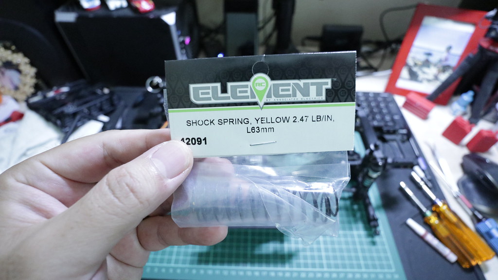

I added some weight to the front using SSD Brass knuckles for the Element Enduro (eBay).
As usual SSD makes some real beauties for brass weights.
I also added stiffer Element Enduro Yellow springs (eBay) to the rear of the truck to counteract the stiffness of the front IFS setup.

Yes, I sorted the issue. I'll post about it in just a minute.
I'm using the Pro-Line 1.9 Class 1 BFG KM3. They work really well for a class 1 tire. I haven't found a 1.55 tire I like yet. I wish Pro-Line made 1.55 tires in their G8 compound as I'm a real fan of it.
Alright the latest updates for my Enduro Trailwalker.
- Club 5 Racing High Clearance Links for the Trailrunner (because it's rear links only for IFS setups) (eBay)
- Associated #7430 Red Springs rated at 3.9 (eBay)

These red springs are what Aaron Lane from Element RC used to test his IFS design. They're softer than the springs that come with the IFS. You can also see that they're a little shorter as well, but that's ok, because you can just spin the spring retainer down so that they don't pop out.
