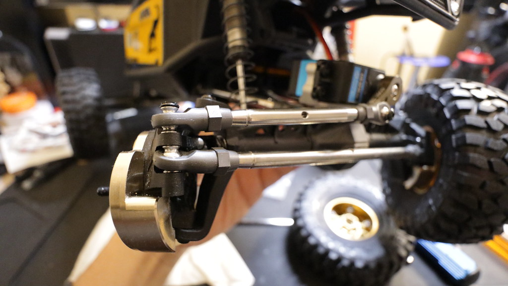

Moving onto the rear link risers, you'll need to source some 3x14mm screws that don't come with the part.
Fits pretty well
All mounted up
I might have to lengthen the upper links to take care of that driveshaft angle.

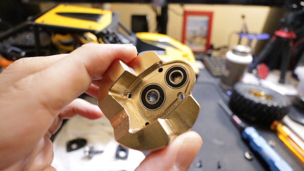

I also got these recently off of eBay.
Brass portal covers
So I think everyone knows they're sold by Vitavon, but I think these are probably from the same factory with different branding (So far I've seen Vitavon, TBS, Hot Racing?). Mine happen to be branded TBS. I put in a best offer for $20 and got them.
I think these brass portal covers were originally intended for the stock wheels. You'll have to make sure whatever wheels you are using has enough inner diameter clearance to use these.
Clearance with the stock wheels.
Type of wheels where this part will not clear!
Luckily the wheel I chose to use has enough clearance to use these portal covers.
Everything fit really snug, so that was good!
All mounted up.

Why did you choose to raise the rear upper link ?
What is the expected behaviour ?
I suppose you want to change the anti-squat, and everybody has his own theory on the right amount of it. Which holes do you use chassis side ?

My clutch seems to be working fine with stock setup, but I don't bind my Capra much at all so there really wouldn't be reason for it to slip.
On the chassis side, I still have the links at the bottom hole. I plan on testing the different holes both chassis and link riser sides to see what I like best.
8:40
On this one, you move up diagonally and the angle is steep enough where the front right will lift if the rear squats. The risers seem to have helped preventing that from happening.
12:03
This one is steep and you throttle it up at the bottom. Without the risers the Capra just tends to flip backward going up that incline. The risers seem to keep the front axle down when throttling it up, and the weights help it to hold when it gets up there.
