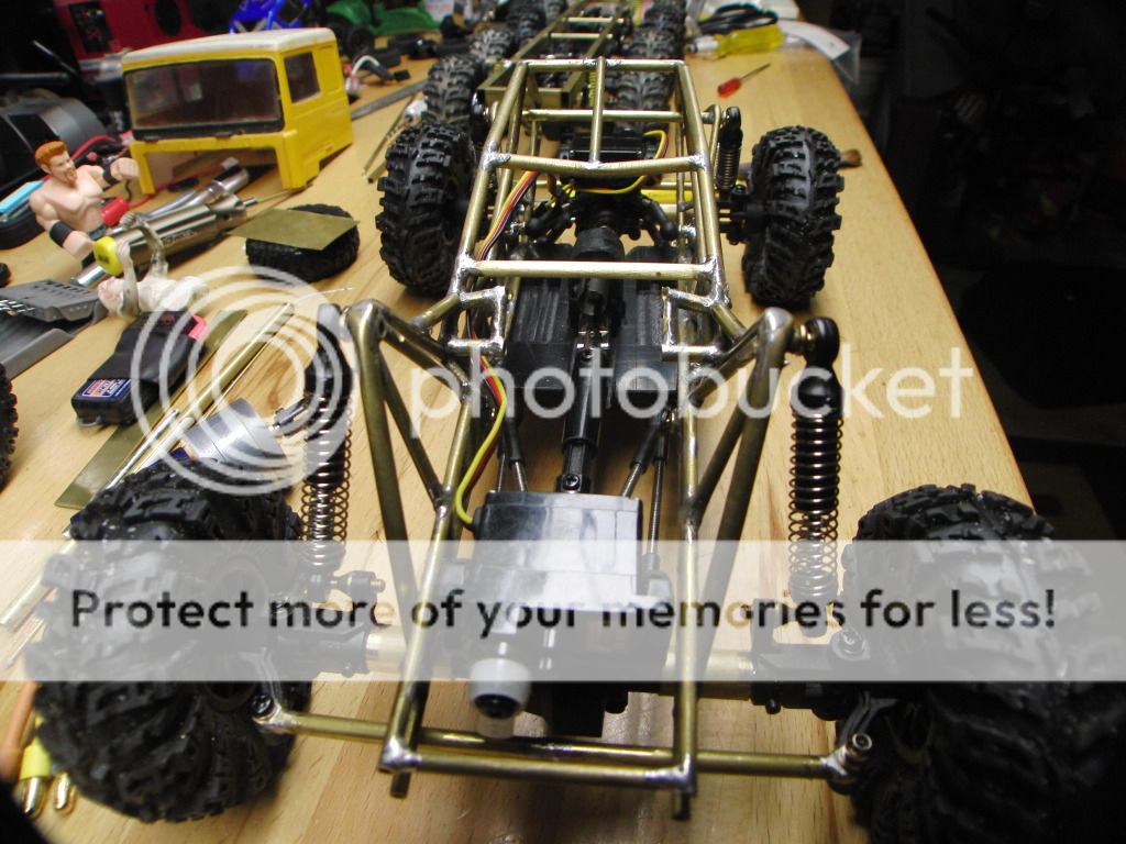

Change of plans with the power plant went with a ezrun 18t can on the gearhead...All I can say is this combo was mind blowing on the bench testing with 3s....Plans are to drop in a quark 22a esc & run 4s, I can't wait for the first run!
afghafasfpwbnsasgfhbcxzv ... Sorry just cleaning the drool off my keyboard .... Amazing work ! What wheels are those ? They look badass !
this think give me alot idea!! you work is sick!!! 4s ? did you ever broke sumo axel parts??? I start a built with powerfull powerplan, i will order parts i think so!!!! but i never broke mlrc part!!!! i cant wait see wow you will do for the engine!!!
how do the wheels work? pin drive or hex drive?
Epoxied stock hex on the back side of the rally rim "thumbsup"

It took two weeks for my delrin to get here from PA :roll: So I got a little work done on the skid:
Everything sit'n low in the chassis 8)

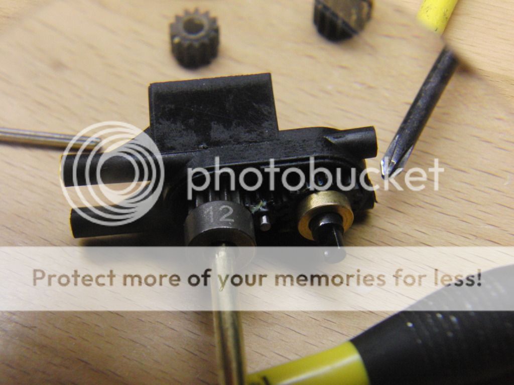

You got details on the t-case setup? Is that motor gonna rip this thing apart?
It is a sumo trans converted with some 1/8 rod & losi 12t pinion that was always the weak spot on my others:
That motor is a monster & on the 9.7:1 gear reduction with 4s it just might rip it apart ;-)

You want to finish it off :ror: finding room for all the electronics is a real PIA...
I did get the driveshafts done & the skid reworked its a tight fit with that big motor & GR unit but it should work out....I hope to do a test run soon & yes it will be on video "thumbsup" just incase it explodes :lmao:
