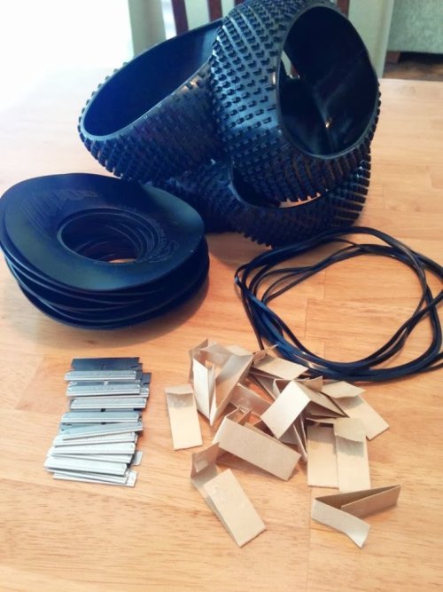

Cut another set of silver Voodoos a week ago. Still need to glue them. First set is quite worn and I changed my mind and didn't reverse them and run them. I'm afraid if I do the pins will evaporate in an instant. I thinks this tire will be unidirectional for best performance. I fear they will fall off a cliff when reversed after moderate wear.

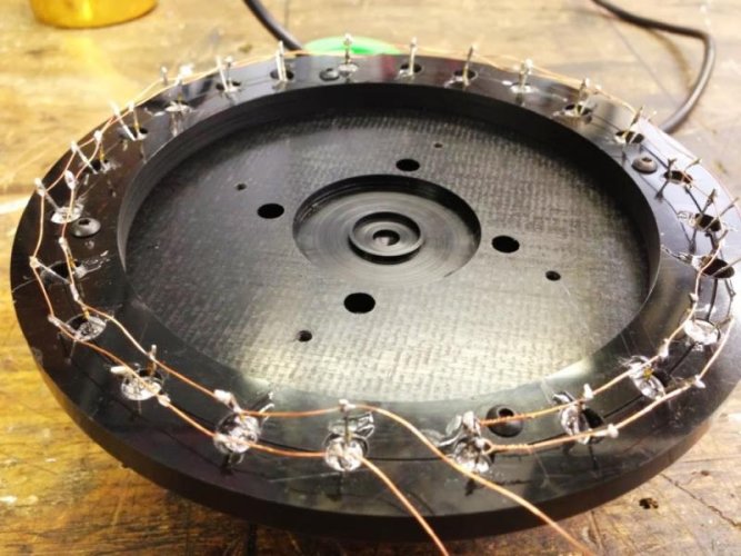

Given my aging eyes I wanted an iluminated magnifying glass. Nothing out there looked good for the money so I made one using an old lens I had lying around. Gluing my next set of tires will be a lot more pleasurable now.

Slide 4
I inserted the LEDs at different angles so they had different focal planes to prevent the center from being a black spot regardless of how far away something is. Soldering was actually a breeze.

What you powering the old man lighted looking piece with. Lipo? What voltage? If it's what I think I got something here they work better for you. Been in my way for a while and no good to me...PM Sent"thumbsup"

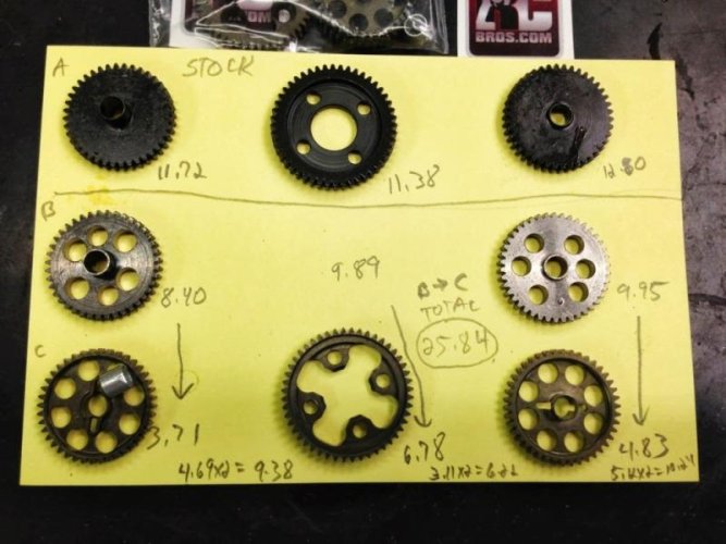

RCBros antigravity gears
Thanks William! Great looking gears.
Holy moly these things are minimal. Kinda scary when you hold them in your hand vs a stock one. As with all things new I'm a little nervous but at my next servo change in a few weeks they're going in. In the picture are the weights of them (C) vs some stockers (A) vs ghetto drilled version (B). I didn't have a spare big B gear that wasn't green loctite-ed to a locker so I just did the subtractive math. The weight difference (2(B-C)) is almost an oz (25.84g). It's more vs stock. Let me know if you need more decimal points.
