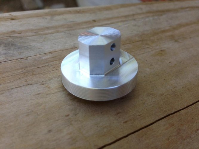

The start of the housing, endbell with integrated prop mount. Because of the design I couldn't pull off a finished part in one op unless I purchased a few more live tool holders. No worries, we are only producing 5 or 6 units in this batch.
Next up is back side operations for the shaft and magnet jigging.
The hard line that is visible from the milling path exit is only a surface texture reflection, there is no variation to the surface height as it appears.

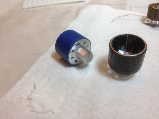

The housings are the jig. All parts are 200c and saltwater spray resistant. Curing overnight for tomorrow's bench testing.
