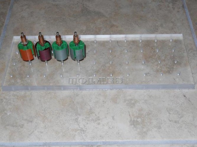

Now I need to do some direction swapping or reprogram my hand held controller to reverse directions. I thought I had it all done but when I started doing operations it was cutting the letters backwards.
I spent the morning playing with my new toy and getting used to incremental and absolute G Code modes. I made a simple armature plate out of scrap acrylic to help with production, it was easy and a good first project to get my feet wet. Now I have a big mess to clean!
On to the next project! I suppose I should read the documentation for the Mach3 software and CAM programs too :ror:

you can largely ignore the existence of incremental mode. Once you get used to your cam software, everything will be based off absolute.. its important to understand the difference, but eventually you'll get to a point where its VERY rare to use incremental, and even then its usually just for simplification of a sequence.
I used CAM software in absolute for the lettering, and the holes were done through keyboard input. I wondered whether whether drawing it in cad or typing the Gcode would be faster, and just started typing while I was still wondering. After the first row of holes I got tired of entering the new X coordinate and switched to incremental so I could just repeat the last three moves over and over in sequence. Drill, raise, move 1", repeat. I could certainly see the benefit in banging out code manually for many parts.
