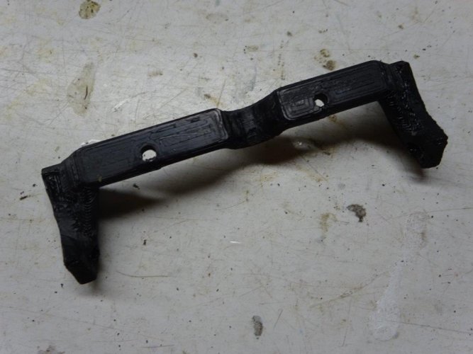

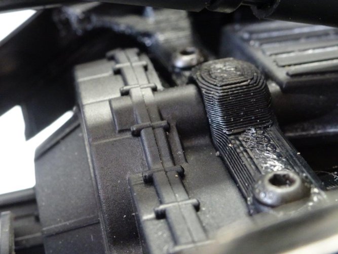

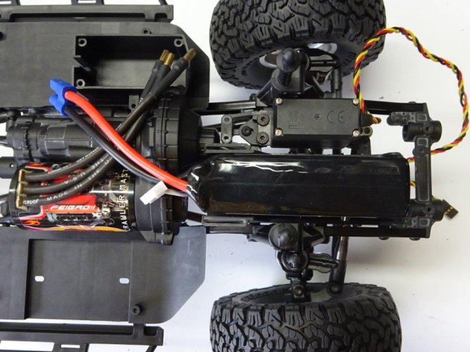

In a related note, now that we have the NC60s out, Nick and I are cooking up something sweet for this rig (that's code for I had an idea and gave Nick some homework :ror:). So stay tuned...
While I definitely applaud the ingenuity, I feel like a laser sintered version of that mount is going to be a stronger option long term. I just had a 3D printed part that I printed at home on a maker bot fail, because of the way it's printed, so watch out for the longevity!
All of our production parts are sold directly through our Shapeways store and printed on SLS printers. The original prototype of the TF2 low profile skid printed in draft mode on Nick's printer at home took a ton of abuse without flinching, but we know that small changes to printer settings at home can make a big difference in durability. We don't want to take any chances with our production parts, which is why they all get produced on the Shapeways SLS printers. "thumbsup"
You're right, there is a big difference between an SLS and FDM/FFF part. FDM parts are done for prototype development and fitment testing. Once you know the FDM part will work, the SLS part can go into production.
Lots of the glamour of owning a printer at home is just getting it to print (that's the hobby in itself). People who are selling parts off of their home printers are generally doing it out of one material and from one supplier so they can keep the same settings. For example, lots of the cosmetic parts out there are done in PLA. That offers generally good detail and strength, but the main thing is it's easy to print with.
Long story short, it's important to use the right tool for the right job. FDM/FFF = R&D and pre-production samples and SLS = production parts.
