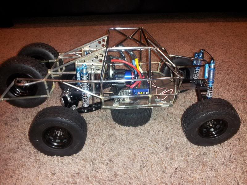

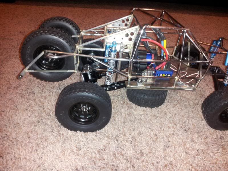

I did a little work on the truck this morning. I got the rear suspension buttoned up. I have axial soft and medium springs in the rear (red and green) and 40wt oil. The bypass shock has the stock spring in it and a few drops of oil just for lube. It feels pretty good for a starting point. This thing is heavy! 9lbs so far. Those RC4wd wheels weigh a ton and this thing has 6 of them.
I got the front suspension mocked up. I need to do some grinding on the protrac arms to increase droop and I also need to braze some cage sections in for shock and upper link mounts.

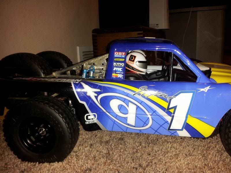

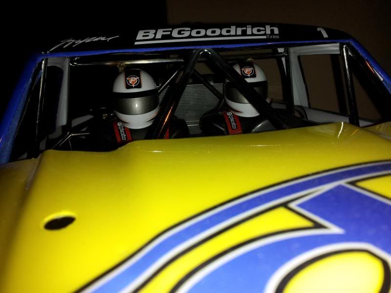

I will be making side panels and using the Apache cockpit on this thing so none of the electronics will show. I am kind of getting the itch to work on this thing again.

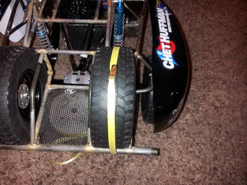

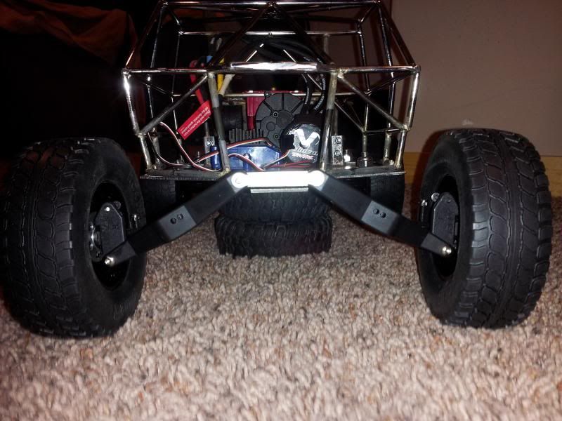

I think I made good progress on the front over the last couple days. I figured out how to get RC4WD rims to play with Slash 2wd front spindles, got the arms clearanced for long travel, swapped out shock ends for long travel and got the wheel base figured out.
