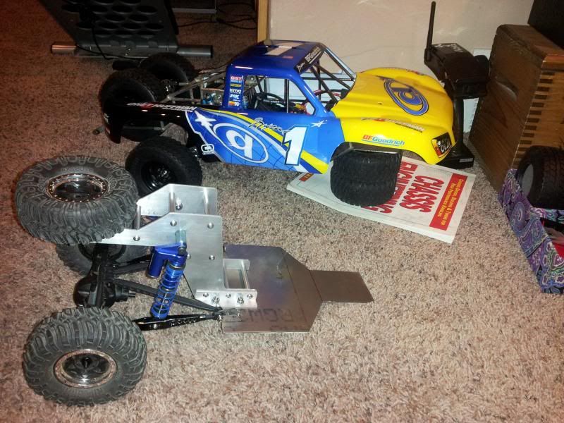

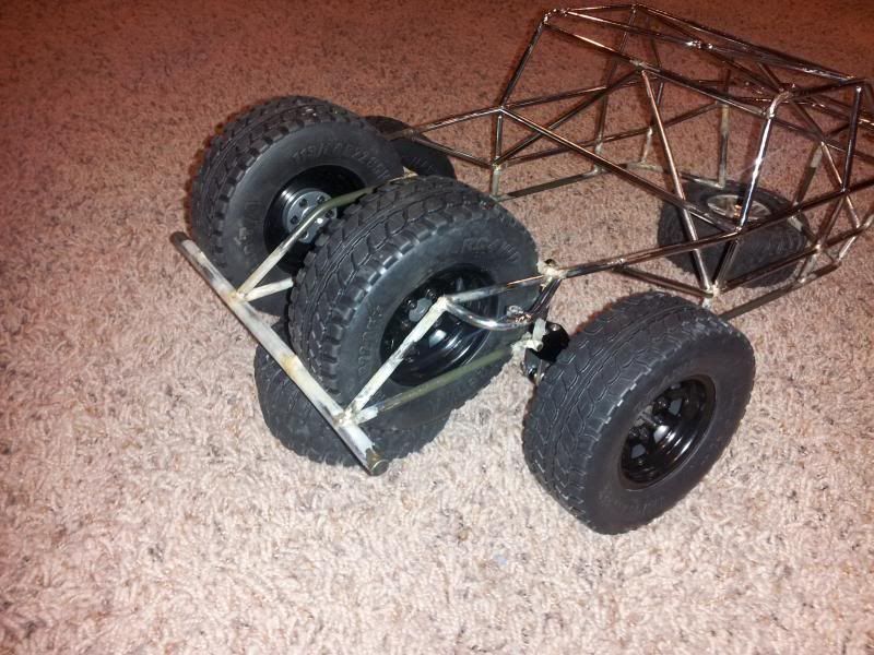

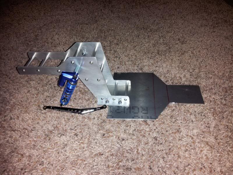

I was reasonably happy with it until I scored a Brushlless Slash 2wd with the RC4wd cage on ebay for just a couple hundred bucks. Now, The RC4wd cage did not fit on what I had built, it was over 1" wider than my steel base plate and the rear suspenstion structure interfered with the cage. I shelved the original build and started over with a new steel baseplate.
The cage won't work without modification becuase it is meant to work with a stock traxxas chassis, it's not tall enough to work with my design, so I had to add 1" to the bottom of the cage to lift it up into the body.
I bought a mpa gas torch and some tubing and taught myself to braze yesterday
Shameless plug for a good book.
I am trying to figure out what amount of anti-squat to design into the rear suspension by moving around the rear link mounting ponts.
Thus far I have the RC4WD Steel 2.2 wheels and their Dune TAs, and Integy Wraith rear axle and some HR Twin Hammers rear lower links.

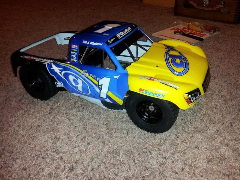

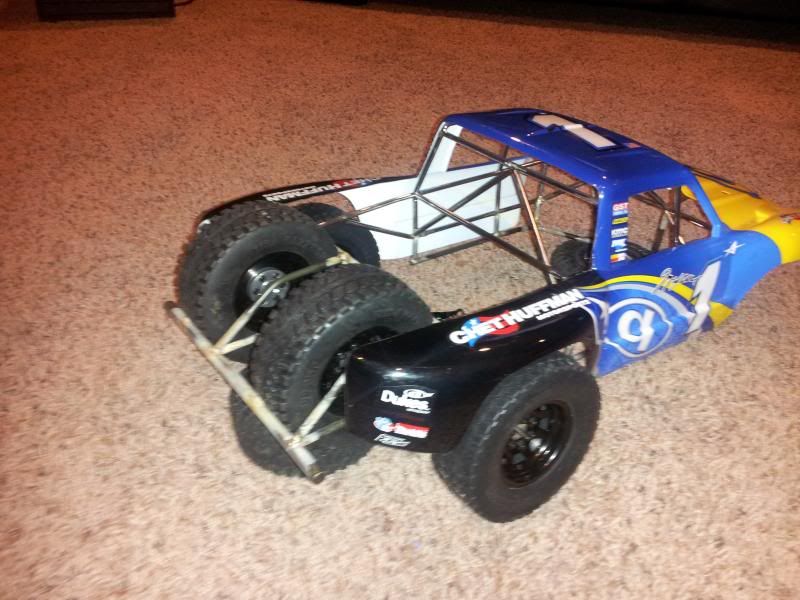

The donor truck came with a brand new but butchered Welchel body. It's not my first choice but it's un-used and I fixed it up with a little trmming last night. Hard to pass up on a $60 body when it's already in the box.

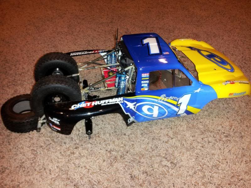

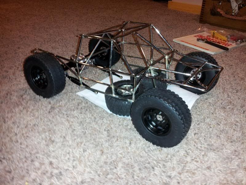

I spent some time this weekend and built a tire rack and rear bumper.
I have my new baseplate almost finished. I need to snap some pics of it.

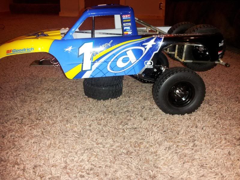

I made some progress this afternoon.

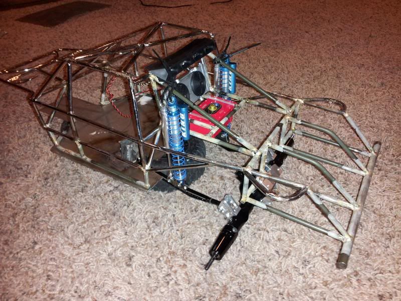

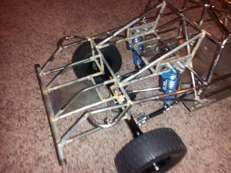

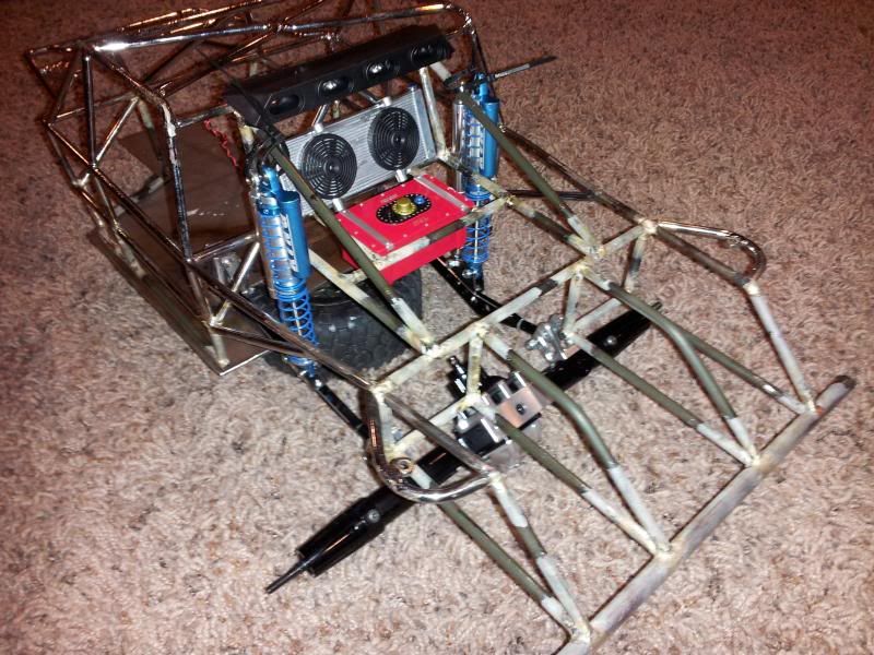

Rear cage is almost done, need to figure out a shock mount. Fuel cell support is in. I didn't take the time to buff the burned paint off of the tubing. I really like the EXO rear light and radiator. I painted the cap blue, too bad you can't tell.
My honcho front bumper donated some metal to the shock mounts. I think they look pretty darn close. I'll back them up with a 5/16" tube and bolt though the plate and the tube for the shocks.

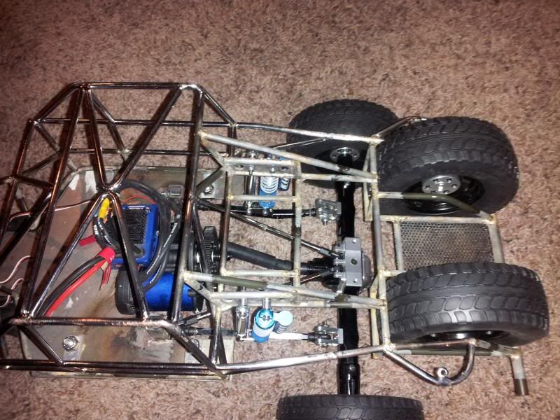

Any issue with using stock scx10 transmission and center drive shafts on this build? I only plan on running a 2s lipo, but this thing is going to weigh 9-10lbs. I used 3s lipos on my old slash 4x4 and they were really crazy. I don't need to subject this rig to that kind of torture.

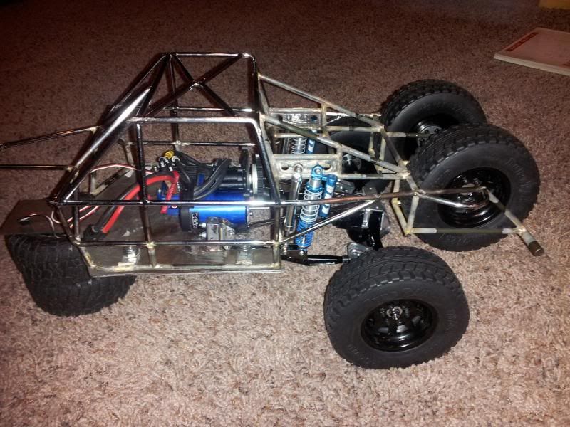

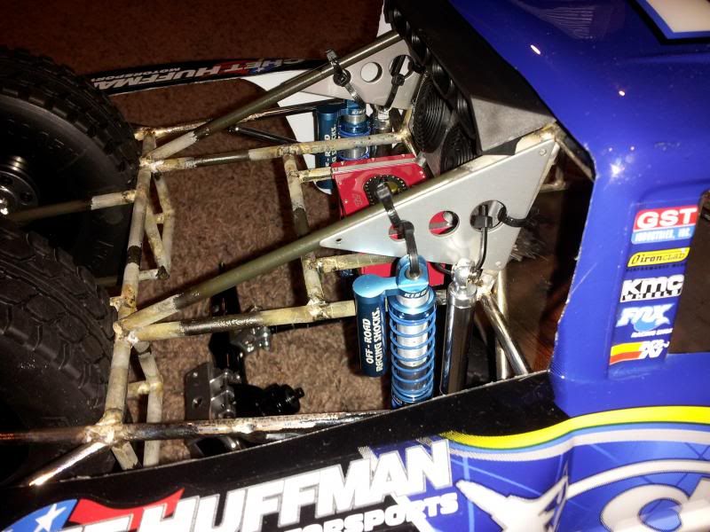

I added an SCX10 transmission, shortened driveshaft, velineon VXL brushless and speed controller tonight. I also started playing with spring rates. I believe I am going with 40mm axial SCX10 springs Green and Red. The stock king springs are simply too light (1.1lb/in) springs.
Droop check again! I only need to limit the rear a tiny bit to keep the driveshaft spinning freely at full droop. I shortened the 110mm Kings with 100mm Integy shafts.

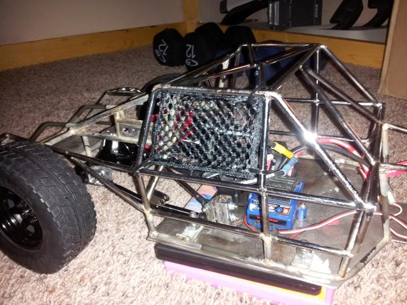

My fiance made some window nets for me last night. I wanted them to have a little slack in them so they move like a real net. To keep its shape she put a little wire in the net to keep the edges rigid.
This is sweet. I had an idea to do one but didn't know where to start so I put it on the build wishlist lol. Looking good can't wait to see it done.
I got my slash pro-trac front arms last night. I have been spending most of my time getting the rear shock length and mounting points correct. I want 3" of rear travel. I want the tires to just kiss the inside of the body at full compression and I want to use up all of the driveshaft angle I can. I think I am finally there.
