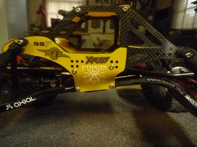

Been doing some testing and tuning. Had to try the yellow panels. Moved the front upper links into the extra lower hole on the chassis. Seems to give it some extra life! Still have a couple issues Im working on. One is when using dig, the rear pulls all the way down while the front only pulls down about a 1/4". The other is, the suspension unloads when standing the rig up for verticals. Maybe ya'll can help me out. Im not sure what to do to correct it.

Have you tried mrc silvers in back? I didnt like mini silvers on rear, seemed a touch to soft. You could also lay fronts back one hole. This is assuming the fronts over powering the rear on verts.
Try lowering your rear uppers one hole on the chassis. Try to make them as horizontal as possible. Raise your front upper link mount at the axle with a small (2mm) spacer. See how that does.
