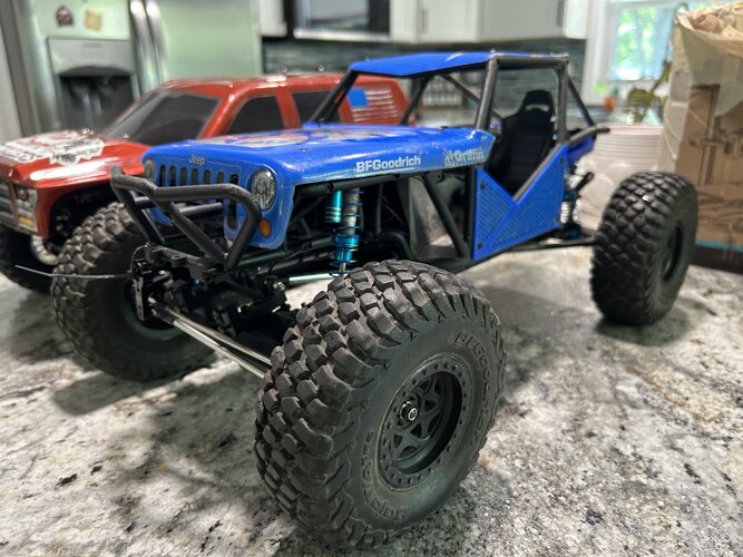

Enough sap. After looking for a long time I snagged up the one I’ve been looking for.
A blue poison spyder!
Bought it off another member. Already had plans for it as soon as I saw it and purchased it. I honestly should have started with just a blue panel set and complete cage because I already had the skid, ar60 axles and a 2 speed trans (it’s Amazon but I had it on another scx10 platform. Works well for the price!

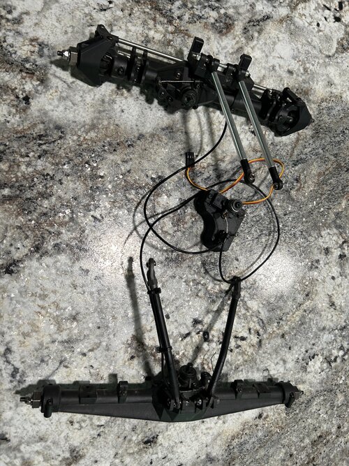

Stripped it down to parts I don’t need for this and parts I do need.
Parts not needed:
Fast backed cage and partial panel set
Rc4wd locking diff axles (going to a buddy for a trade on some pitbull 2.2s)
Chinese kings, Chinese shafts and a stripped trans. Opened it up to two stripped gears, glad I had an extra. I’ll rebuild that one in the future. I have 3 ax10s in the house that can use it and maybe I’ll add dig to one of the others.

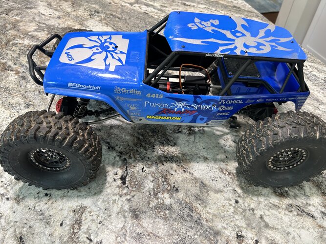

Complete cage and panel set arrived! Pretty clean considering its age. Few scratches here and there but a good cage to build off of!
Also got the spawn body in the deal, so that’s a plus.

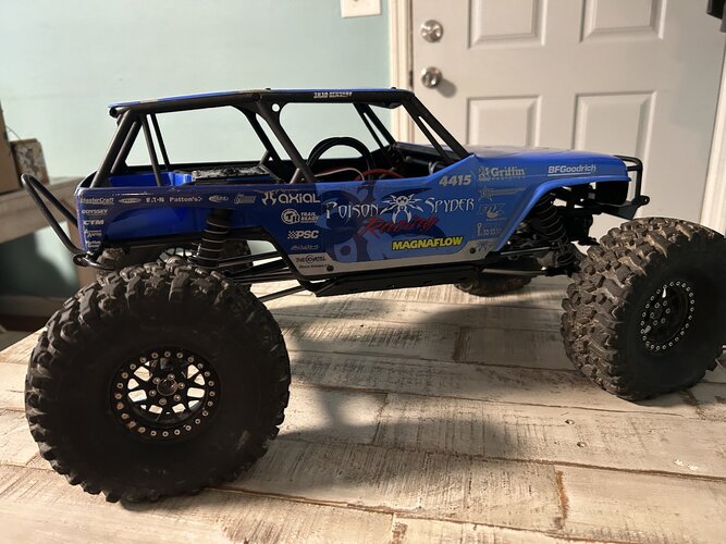

Making progress with the rebuild. Missing a few things, front truss and rear link mounts. I need another pair of factory wraith shocks.
Doesn’t have rear shocks on right now, the squatted truck is not staying lol
Everything is gonna get fitted and then removed for a deep cleaning. These shocks have years and years of buildup on them.
Dig trans is in but I need to put the interior in to trim that as needed. Gonna try to shim it up so I don’t have to cut but we’ll see.
Decided to keep the rear tray that was on the other cage, likely stick some scale stuff in there. I also need to source some original wraith light buckets. I think they had two light buckets on the bumper and two red reverse lights.

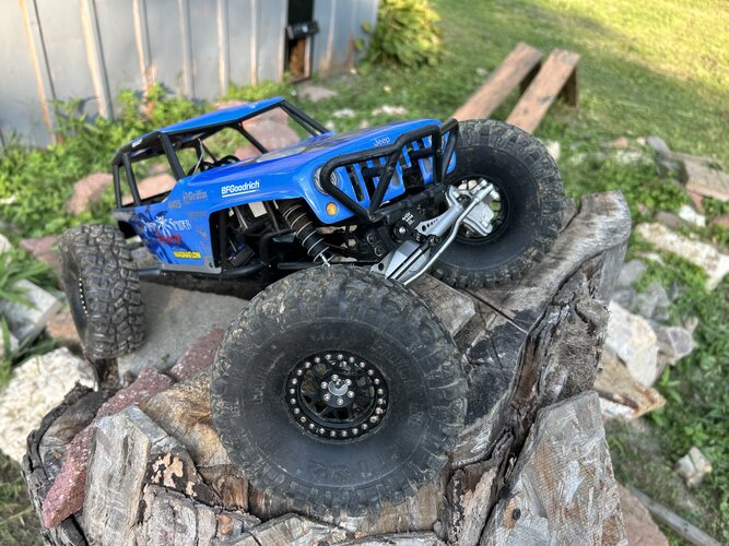

Little test n tune on the backyard course that needs some manscaping around the rocks…
Still lots to do with it but I just wanted to see how it ran.
-Need to change pinion to a 16-17 right now it’s a 10
-needs a stronger dig servo bracket and tune the remote for that

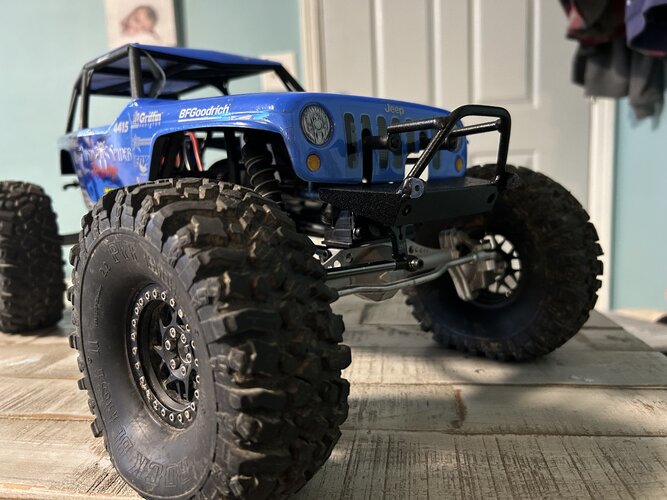

Went to a local swap meet and ended up with a TON of scaler fab bumpers, sliders, etc. along with vanquish and incision stuff (guy bought out a hobby shop) so I decided to toss the scaler fab front and rear bumpers and sliders on the wraith. Looks pretty good, however, that front bumper just doesn’t do it for me. It needs light hoops or something…
also, worked up a deal for my son to trade his ascent as a roller for a wraith as well. Ended up pretty good in the trade with the upgrades already on it and he kept his fusion system, that is now in the wraith.
He does have a stinger style scaler fab bumper that he took off for some reason lol
