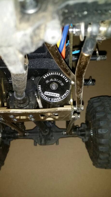

Ok. So heres a new list of mods on my now Everest 10 Rock Racer. Could almost pass off as a Formula Offroad buggy/truck. Heres the list of whats been done:
Aluminum servo horn
RC4WD SCX10 aluminum steering and servo links
Metal locking diffs front and rear.
Hot racing hardened aluminum center transmission gears.
Axial out drives in the stock Redcat tranny case.
Boom racing 20mm wheel wideners.
Proline Interco Super Swampers TSL SX with regular size 2.2 sponges from my badlands.
Custom made 6061 aluminum gold annodized bottom chassis plate
Custom made 6061 aluminum steering hubs.
Redcat aluminum c-hubs.
Redcat Volcano 100mm aluminum shocks.
1/8 scale Hobbywing Waterproof SC8-RTR brushless Esc
3650mm (540 size) 5900kv 4 pole brushless sensorless motor. ($30 chinese motor. Forgot the brand, but rebuildable)
Switched around shock and link positions. Running the shocks on the outside helps with the major torque twist this little beast has. Spings are dual rate and alot stiffer than stock.
Sprayed body inside and out with bedliner. It helps big time.
Integy 40c 7.4V 5000mah lipo battery.
Think thats it for now. I will post video footage soon. You guys need to see this thing move. I am confident in 30 to 40 mph with it now. I know I dont need this to be a super speed demon. But was impressed none the less.
