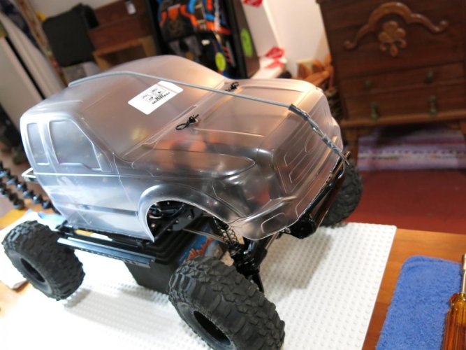

actually the DSM Tow Hook I use to hold the body cab down though soon im modifying the cab to clip on the chassis and the tow hook will still either coiled up on the links or over the body they are great for towing and wincing but also for holding rig bodies down!!!! But I can tow pretty easy!!!
and yes the noise on the Spur gear its a little noisier with the metal but the honey grease quiets it down significantly but im going to test out the plastic and do a comparison but I felt I was a little stronger with the steel spur......
Ok. Makes sense. I was wondering about being a hood tie down as well.

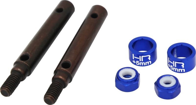

Hot Racing Steel Axle Shafts I pair them with KYX Traxxas TRX-4 Hardened Steel Front Portal Drive Input Gears

Regarding stub axle play.....
Look at your hex pins. Not all of them go through to the other side and secure.
Brand new I swapped out stock hexes for brass ones and reused stock pins.
A 3 months later (maybe....something like that) I noticed some bad play with the stub shaft.
Tore everything apart and noticed some “odd” oblonging of the hex pin holes in the stub shafts.
At first I thought the hex pins had broke on the non threaded end because they were not all the way into the hole in the stub. Only one side was secured.
Ordered up new hexes/pins and some vanquish trx4 stubs.
The new pins are on the right.
The new pins go into the other side of the stub so it is supported on both sides. The stock did not.
Tightened everything up pretty good. Very minimal play.
Something to check out/consider.

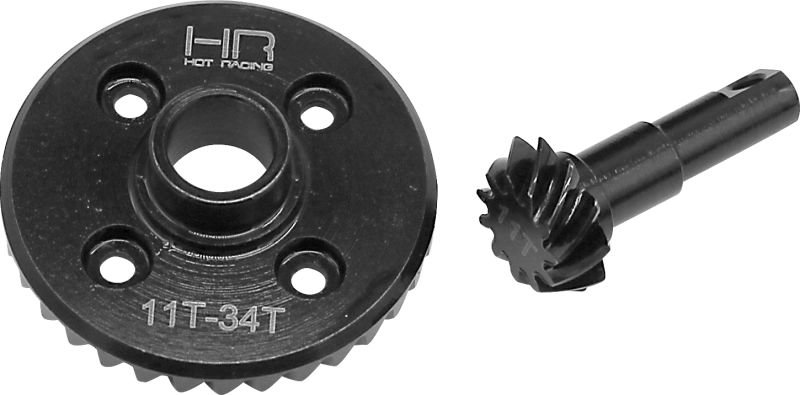

Awesome man yes I think your right the front portal gears are aftermarket Yeah Racing See pic but the problem wasn't visible when I did the front only when I did the rear and the rear gears are Traxxas stock portal gears so ill post pics of what I got other now im a stoner and I bet you I missed or messed something!! BUZZZZ........
and my stub axles are great everything looks nice and clean and smooth it those Traxxas gears!!!! im going to open them back up and post some pics....
also the shafts wobbled so bad when I turned the stub axle it made the casing on the portal hard to hold...... I know the back is the main problem I have....
im going to also tape the tires and check the overdrive gear in the front.....
front has the over drive and both front and rear have Traxxas 8061 and 8062 shafts and gears..... BUZZZZZZZ.......

Nice!!
Hope it’s an easy find and fix.
I want to say the total front overdrive with the over and under is 22-25%. Something like that.
I had both in mine for a while and wasn’t too keen on it. It seemed to work better with the lower front overdrive of one or the other.
That being said I’m going to revisit that as my new to me Gspeed has 32-35% front overdrive and I like it a lot.
Always something to tinker with. [emoji106]
Plus taking those ring gears off is a good challenge for your 1.5mm drivers. [emoji1787]

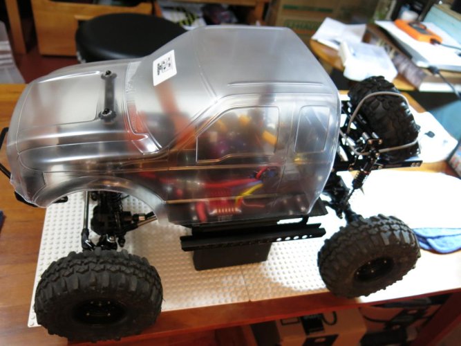

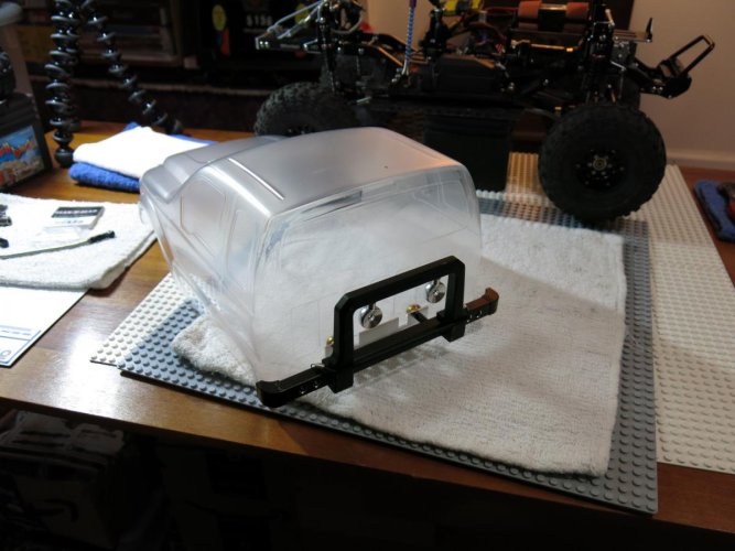

Re: RCBee TRX-4 Honey Comp Crawler Build Body #3 CoMB Crawler

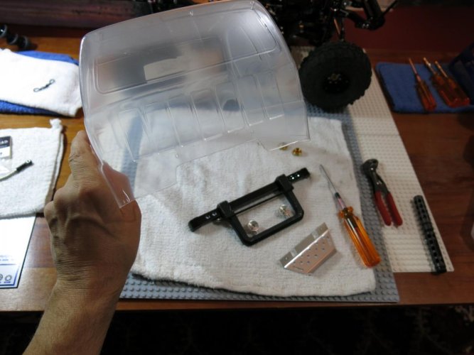

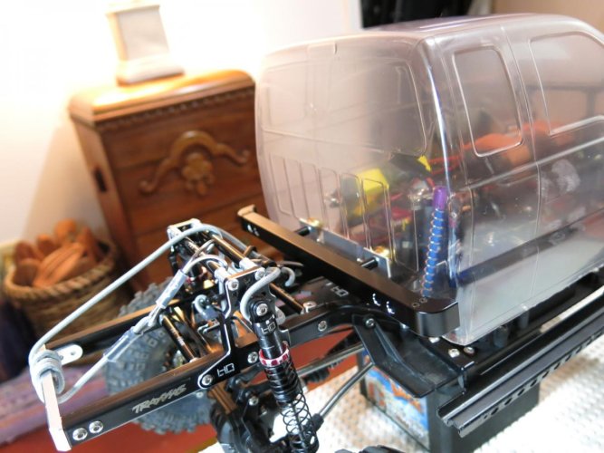

im making in this post Half Cab body#3 of 4 half cab bodies im making for this rig and a TRX4 sister rig with 4 wheel steering This one is the Ford F250 from Proline Nice body as usual I already ****ed something up and made the Body post holes too close to the rise on the hood and the pins will not fit!!!!! so anyway everything else looks good and I already have installed the back mini bumper to the cab body I tried the larger but wanted a smaller look and I had this Samix part I never used for shocks and it fit pretty good and now im fitting the Rack and light bar from Gearhead RC... a couple pics of the Cab Bodies and The Basement Hive Bench and SHop. BUZZZZZ.......

Oooo!! I love the proline F250 body, glad to see you using it! That lightbar/slim rack will look great!
Nice workspace[emoji106] wish I could stay that organized lmao
Thanks Man... Buzzz Buzzzz....
looking forward to seeing it painted still thinking if im going to to do a 2 tone or 3 tone but im going to start taping it up soon!!!!
the workspace is getting better but for living with my parents right now its great space to work late..... BUZZZZZZ......
I personally would do one of these. I have always loved the King Ranch two tones. But I think these would look better as a scale truck, not a crawler.
