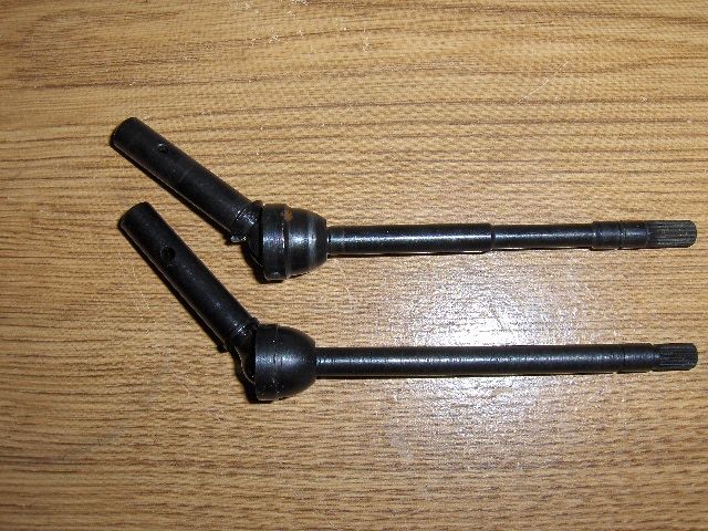

Comparison with the ThunderTech/MIP shafts:
The TTR shaft is on top, the RC4WD on the bottom. The shafts are the same length but due to the difference with the hex design the RC4WD shafts setup up just a hair wider. There is more angle on the RC4WD version but the CV action gets notchy at extreme angles. In practical application you would have to do serious modifications to take advantage of the extra throw. In the Clod and TXT axles I installed them in, with the "normal" steering mods for racing, they both provided the same amount of throw.
The "long" side inner shaft on the RC4WD version has the joint pin molded into it, unlike the TTR shaft which has a separate pin. What this means is there is a specific long shaft and a different short shaft whereas the shafts on the TTR version are interchangeable left or right.
Both use 8mm thick outer shafts. The pins for the CV joints is thicker on the RC4WD version. There's more taper on the RC4WD outer shafts to achieve the greater angles. How that plays out as far as durability remains to be seen, but the shaft is still thick in that area.
The RC4WD hexes use a larger drive pin so they are not interchangeable with TTR shafts unless you drill the TTR shafts out. The hex portion also carries all the way to the edge of the outer shaft so the width, from hex to hex, is slightly wider than the TTRs.
