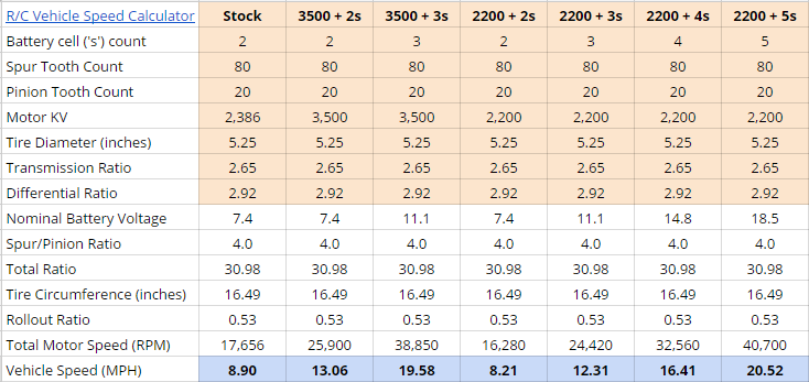

I see the 2700kV is out of stock. Here's a comparison of the theoretical top speeds for stock, 3500 and 2200. You can decide from this how fast you want it to be on different batteries. Additionally, you can always refine your speed further with different gearing. If I were in your shoes I'd get the 2200 and run it on 3s. Volt up, gear down!
I doubt you'll have any heat issues. My Puller Pro 3500 pushes around an 11lb Wraith on 3s with a two speed tranny and I don't have any heat issues.
