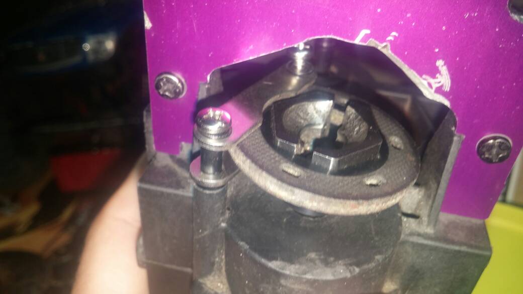

Braking:
Todays progress...
Installed this new transmission into beast & made up a set of custom brembos lol
And with this other transmission comes a massive steel brake hub!
My last one was a stock tranny and plastic parts including this hub.
Installed a plastic stock rollbar in place of what was the stock alloy rollbar. So much nicer on the hands carrying a 18+ lb pig!

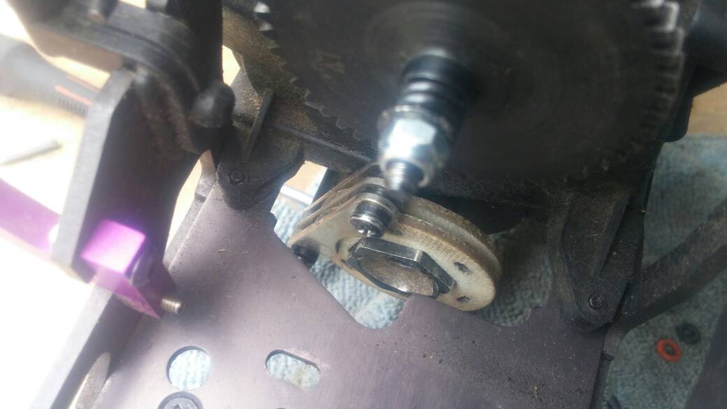

Savage brakes take #2: Lol
Brake fading with previous setup...fail!
Heres the next attempt for which feels very good manually.
Gone to using x2 carbonfiber rotors & x3 steel calipers. Also had to go back to using the stock piston.

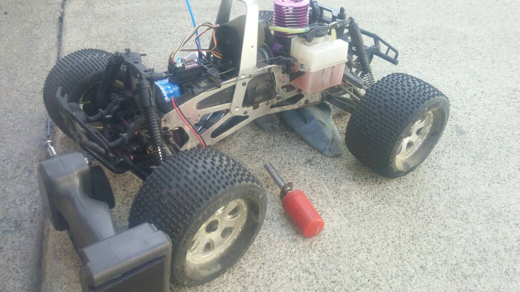

Midtank & Electrics relocation program:
And so it begins....
Custom work underway!
Steel plate.
Cut holes for servos.
Crossmember installed between TVP chassis.
Once this is complete ill move onto relocating my Th/Br servo next to the motor on the chassis.

Throttle/Brake Mod:
Started this in the morning...
As far as i can get until i pay my LHS a visit. Need hardware to finish this phase.
