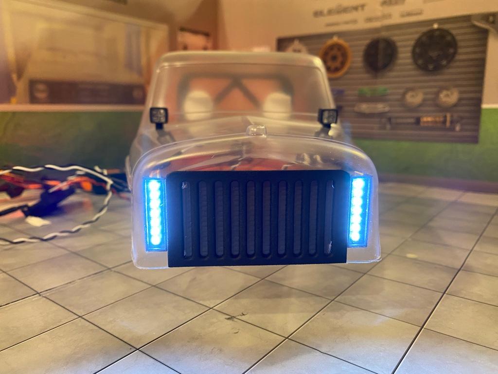

Next was testing the main lights for the body. Not sure if I’ll use the DG-1 or SQ-1 controller. I got inspired by the Trophy FJ build…

Then I had to try the lights again:
Excellent job!
Lovin' the black flash down the side, and the headlights shining through as if they were frenched in the body.
The paint shop didn't biff the Ecto! Paint turned out great!"thumbsup"
Them lights!:shock: Lovin' them lights! Great job on the design and 3D print work! And that rear bumper fits the look so well!
