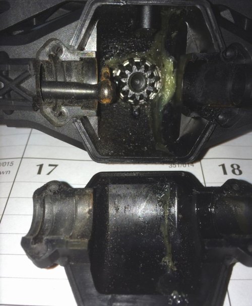

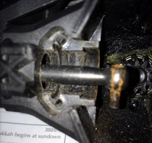

But on about my 8th or 9th battery through the XL, I found that it was starting to act funny, shake and drive weird. After closer inspection I found that the rear diff spun tight and bound up when rotating the rear tires. At first thought it was something wrong inside the actual diff case and side gears. But when I pulled it apart, I found that the inner dogbone/axle-shaft on the left side did the same thing as one of my fronts did a few days earlier. This time I took PICs to show what has happened. Because I didn’t catch it right away, the dogbones little shaft proceeded to move outward and basically tried to cut up/grind the inner axle housing. And when it did this, it sliced up the area where the diff cover bolts screw into, which weakened the housing. So now the diff or axle housing needs to be replaced, and also the axle diff cover too.
I’m not one to usually complain about RC problems and repairs, but certain things just aren’t acceptable in such a short period of time. So I took it to my local HS for them to take PIC’s of it and maybe somehow make axial aware of what’s going on with their product. (Plus I tried to get replacement parts warrantied possibly).
