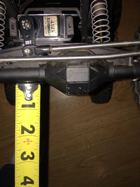

No racing this weekend due to weather.... spent a morning re doing the wiring and layout... moved to a 90mm rear shock, also threw on some JEC Wraith stainless trailing arms off of my bomber as I broke 1 on the B1b. Hopefully the 7075's will be here shortly! New layout pics
Really glad I went with the Wraith Length arms! Digging the 90mm/90mm shock setup. I also swapped out to the offset pill in the toe block for less castor, these changes have netted a much better steering feel. It actually is turning in fairly well. However running the standard sized 2.2 tires isn't going to be an option for me any more.

I found myself limiting suspension travel in the rear of my bomber to keep it from rolling in tighter corners. Finally had it to the point it just made more sense to swap to the 90's. At this point I'm not so sure I even need to run a sway bar. Truth be told if proline releases an Oversized XL Bogger for 2.2, I'm getting them and limiting my 90's:flipoff: With the 90/90 setup as is, I measure right at 5-5/8" of tire lift with all other tires making contact under its own weight. a heavy 5 15/16" without swaybar and me flexing the front arm to max.
