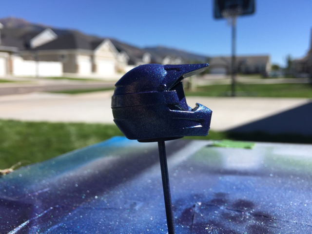

Last part of the body is the interior, usually I’ll mount up my Dinky RC interior that I’ve made to work with numerous bodies but lately it bothers me in my videos when the truck/jeep is driving by itself! I picked up an Axial Racing Wraith Spawn interior for pretty cheap, painted it up along with a motocross style head and mounted it to the body, it fits great and is only held in with a few pieces of 3m double sided tape.
