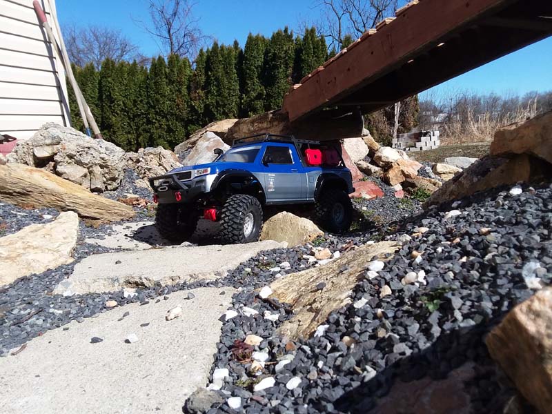

Out on the test course in the back yard...just setting the steering trims and ESC settings. I remove all the punch for a soft throttle tip-in, and set the drag brake to about 50%. Let's play!
Stock tires rub the fenders under compression just a touch. Nothing a little scissors work won't cure.
In 10 minutes of testing, I was proven wrong. I expected a rollover queen with a somewhat high COG, but the Sport was surprisingly sure-footed.
All that weight on the rear with the cage and scale stuff does affect climbing ability, but it's very manageable. Gives you plenty of notice before calling it quits.
On steep climbs, the rear suspension compresses and you get some 3 wheel action. I think the stock suspension is a bit on the soft side - almost has too much flex. Time will tell...
Testing's over, let's head out to a trail.
