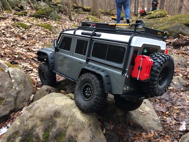

I like the Defender body, no plans to change it at this time. I did pull the rack off and spray the roof white so the body didn't look so bland. Really makes a difference imo. Also pulled the fake winch eyesore off and moved the bumper back 1 hole.

Steep rock. No lockers needed. Amazing.

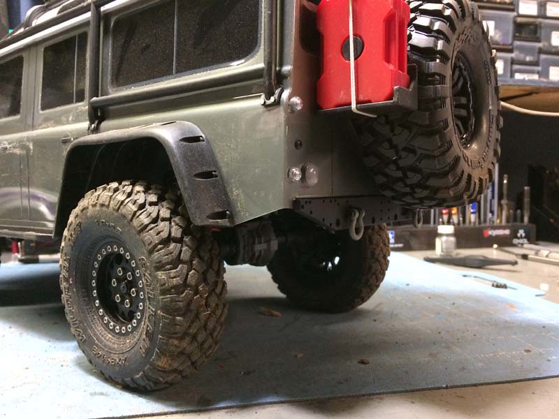

Rear also, but man that spare tire....
After a bit of brainstorming, I removed the spare tire and hacked up the rear rack. Kept the scale goodies and just relocated them a bit. Much better clearance out back now, not to mention quite a few ounces less hanging off the back of the body.
