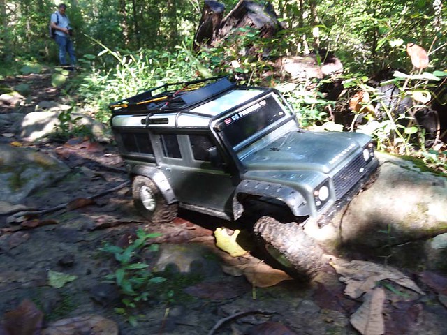

I usually run this truck as a second truck when I run 2 on the trail since all my others are on my GT3B radio - this is the only one I have on a separate radio. So it gets quite a bit of trail time. For this week, I swapped on some PL TSL's and Gearhead wheels - little more aggressive tire for the muddy conditions.
As usual, ran most of the day with the diffs unlocked, only locking up when I had to, which wasn't too often. With the weight of this pig bearing down, the TSL's gave incredible traction pretty much everywhere. I might have to leave these on here.
Open diff climb... unreal.

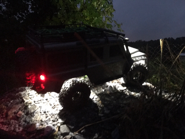

Awesome read! Similar experiences with my truck as far as the low voltage cutting out early so I already swapped out for a Hobbywing 1080. Only other issue I had was the steering servo and the rest have been improvements. You should definitely get the light bar if you do any evening running because it puts out so much more light than the headlights do. Nice to see the results you are having with the tires since that is something else that i am debating on.
I prefer nice headlights and some red rocklights front and rear, plenty bright enough to crawl and hike without additional light (always carry headlamp just in case) ime lightbars are usually too bright, glare off the body and blind drivers. :)
It definitely is bright, won’t argue that, but it does make it so you can see a lot more. I do have the rock lights also and like them too.
I never run at night, so I skipped on the trail bar and rock lights.
