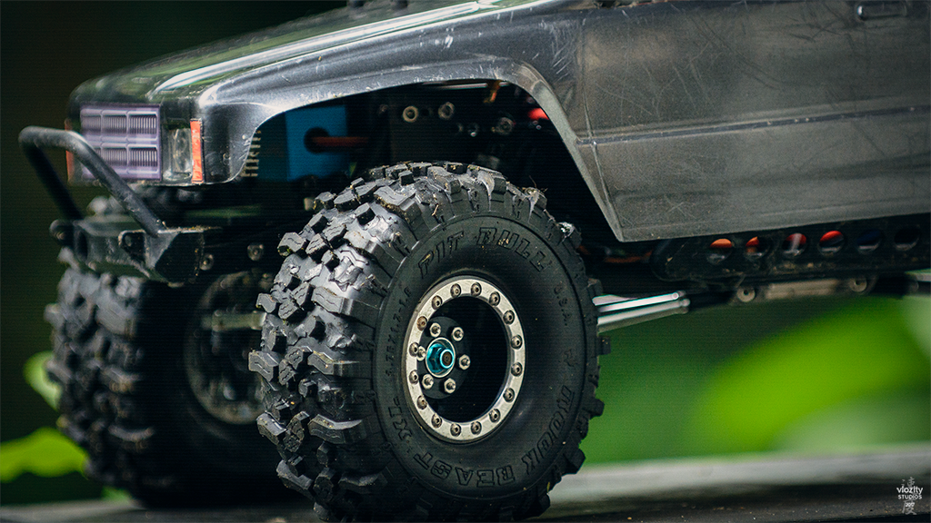

Thinned the stock tires of my maverick scout (hsp pangolin, redcat everest etc..) by removing a strip off the center.
The same happened to the stock beadlocks to make the tires fit better and get a somewhat more rounded profile.

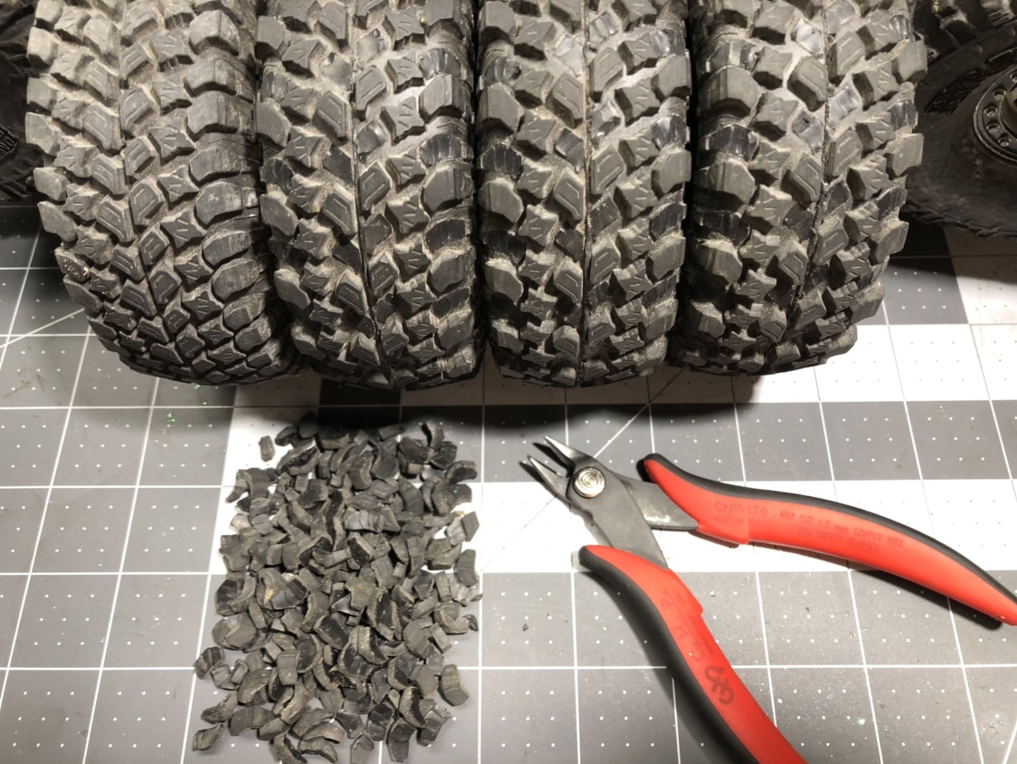

Cut my first set of tires! Cut out some lugs from the Vaterra Twin Hammer stock tires (Race Claws). Have not had a chance to test, but will be getting some trails this upcoming weekend. usually run a set of Proline FlatIron 2.2 non XLs.
Wheels: 2.2 Vanquish Products
Tires: 1.9 Pro-Line TSL Bogger w/ cut lugs
Foams: Crawler Innovations Deuce's Wild part no. CWR-3005 for the inner and Double Deuce part no. CWR-1087 for the outer
How much the removed lugs weigh:

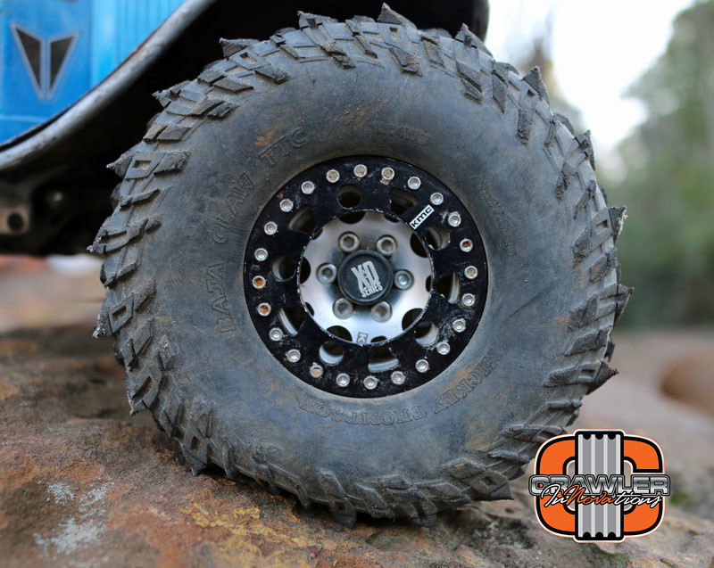

Vanquish Products 1.9 KMC Enduro XD222 bead lock wheel
Vanquish Products KMC Enduro 1.9 beadlock ring black anodized

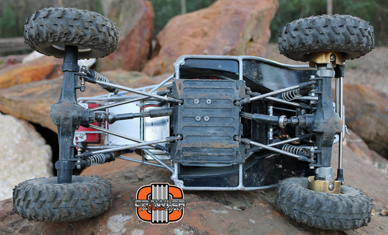

RC4WD 1.9 Mickey Thompson Baja Claw TTC Tire that has been cut n shut narrowed, sanded, with cut pattern
Crawler Innovations 4.50" Lil Nova Foams P/N CWR-2025 front; CWR-2026 rear

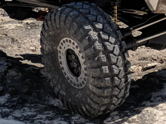

Axial 2.2 kr2 cut down to 1.9. I made my own cut about 3yrs ago. Kr2.5 bfg's decent all around tire. 4.3-4.65 tall depending on foams.
