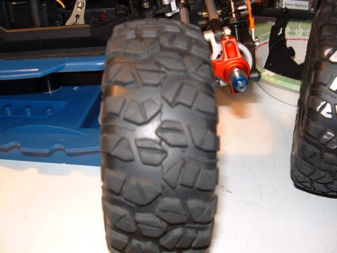

My first try at cutting tires and I did this to my U4's. It's a bad pic lol.
First I wanted more space on the outside lugs to help it in the dirt... So I removed all the smaller lugs. Then I trimmed the remaining outside lugs down on the edges so they don't catch as easy while drifting in the dirt. I then cut an angle out from the center lugs to give a little more void without cutting too much out. I also cut an angle on the outside edge of the center rows again to give a little extra space.

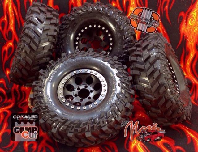

Rims: 1.9" Vanquish Products 8 Hole Shooters Bead Locks
Tires: Cut 1.9" RC4WD 4.19" Baja Claw
Foams: Crawler Innovations 4.25" Lil' Nova Comp Cut Inner with Medium Outers
..Uploaded from the lab @ the C.I. Compound...

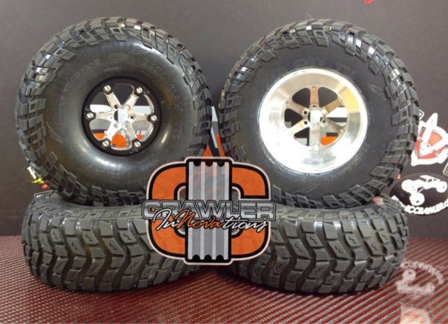

Rims: Crawler Innovations 6 Bolt Wheels in the 1.50" Width
Tires: CI Cut Pitbull 2.2" Growlers
Foams: CI 5.5" Double Deuce Comp Cut Inners with Medium Outers

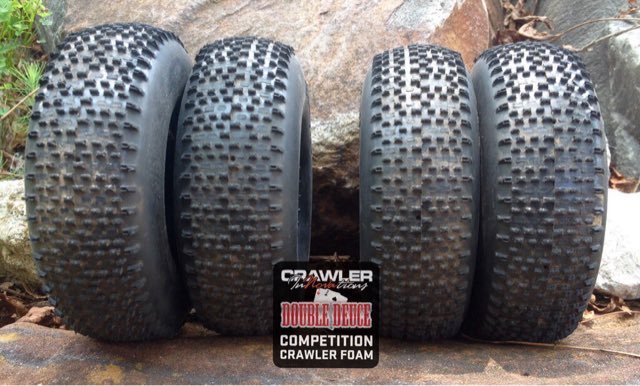

Not cut in your typical way but meh...
Rims: rare Vanquish Products 2.2 / 3.0" Short Course Bead Lock Set
Tires: Cut 3.0" bead RC4WD TTC Baja Claw Radial Tire Set
Foams: Custom CI Double Deuce dual stage foam set

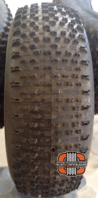

Tires: RC4WD Bully 2.2 Comp Tire
Foams: 5.25 Double Deuce Comp Cut Inners, Soft outer front, Medium outer rear
