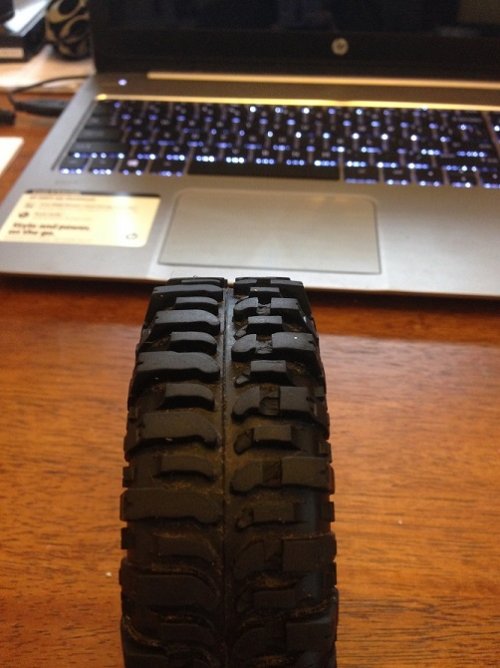

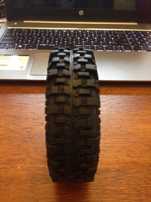

I found this pic and tried it out

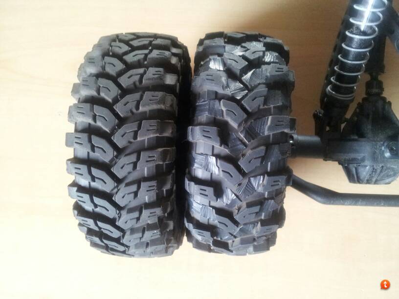

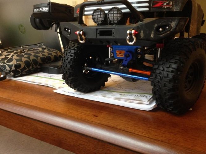

2.2 iroks w mod center lugs, rear every other lug removed, front w every other cut but outer edge lug retained. made soft tire super soft. not sure if front would be better like rear or not
sorry for sucky pic

cut every other outer lug and offcenter lugs in rear, shaved outer lugs and cut offcenter lugs in front. made tires softer and rear moves lots of earth fast.
Avoid the rear tire setup if you run mainly on rocks. Experiencing a ton of wheel hop with that setup but the fronts are money. Don't be afraid to shave the side lugs completely off the tire "thumbsup"
