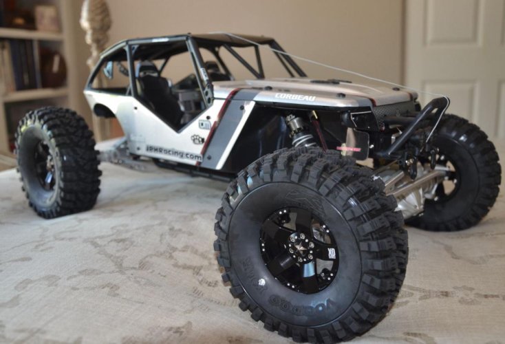

I finally decided on some OTTSIX Voodoo KLR tires.
I originally tried some Proline Hyrax tires, but they really did not want to fit the VP Rockstar beadlock wheels. The Rockstar rims are skinnier than my VP Method wheels. Has anyone else been able to make them work on the Rockstar rim?

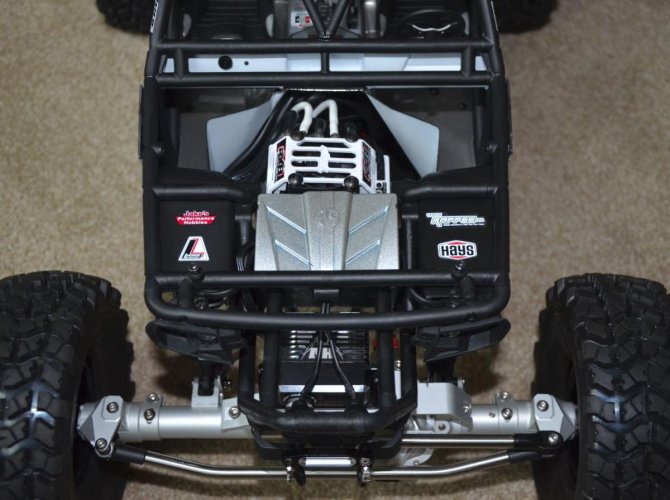

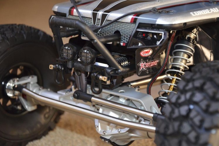

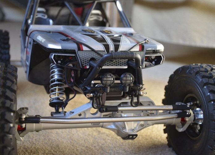

I was never able to figure out a way to make the frame mounted servo work decently. This Wraith sits quite low, and no matter what I tried, it was unhappy with the frame mounted servo. The steering was crap, and/or the articulation was bound up. I finally decided to just move the servo back to the axle. This brings it's own problem, as the servo/horn typically hits the cross tube on the front of the chassis, when the front compresses. I decided to try mounting the VP one piece servo mount backwards, to move the servo further back. This places the servo in the perfect spot (down facing photo shows this).
I did a few things to try and hide the servo as best I can, and I am quite pleased with the outcome. I think it looks very clean. By moving the servo back down, I can now mount my winch.
I still have plans to alter the cage in the back, and windshield section. And, of course, scale details are still on the to do list.

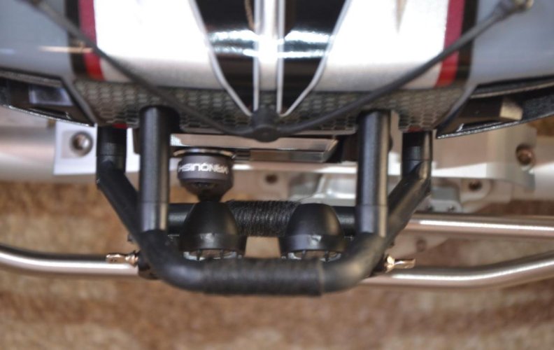

It may not look like much, but I have put in a lot of work into the front of this Wraith over the last week. I created space to add a front electronics box. I really wanted to be able to hide all the wires. It looks pretty simple but it sure was a PITA to find a box that could be made to fit in the space, and had enough room for all the electronics and leads. This Wraith sits very low, so the box had to be far enough back to clear the top of the steering servo when the suspension compresses.
I also added a winch fair lead, although I may scrap it and move it up higher.
LEDs - I finally hooked up all 4 front lights. I took the time to shrink wrap all the leads black, and hide them as much as possible. Once everything was hooked up, I turned it on for the first time only to realize the lights are RED! My LHS gave me the wrong color. F me! It wouldn't normally be a big deal, but I wrapped, sealed, and hardwired everything, and it will all need to be torn out and re-done with the correct White LEDs.
