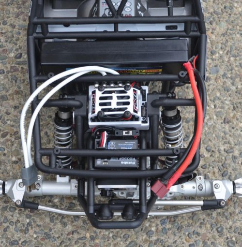

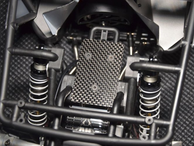

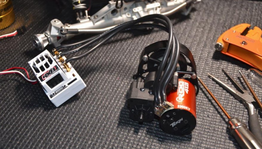

Tekin RX8 and a ROC motor installed. I had a hell of a time making room for the RX8 in a clean layout. I went back and forth between mounting in the front or rear. I ended up choosing front. I created a simple CF plate to mount the ESC and receiver on.
This is bad battery, just for mock up. Once I have a good battery, I will shorten the leads to clean things up. The way the ROC mounts to the VP motor plate barely gives enough room for the wire leads to clear the transmission. Has anyone else had this issue?
I like how the ESC almost looks like a motor under the hood. However it is not linking with the Hotwire no matter what I do, so it is possible it may be bad, which means more soldering.

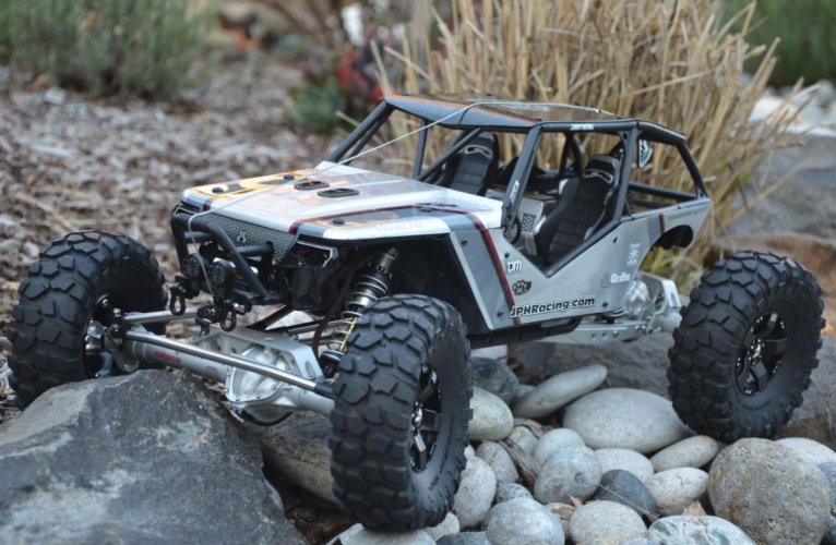

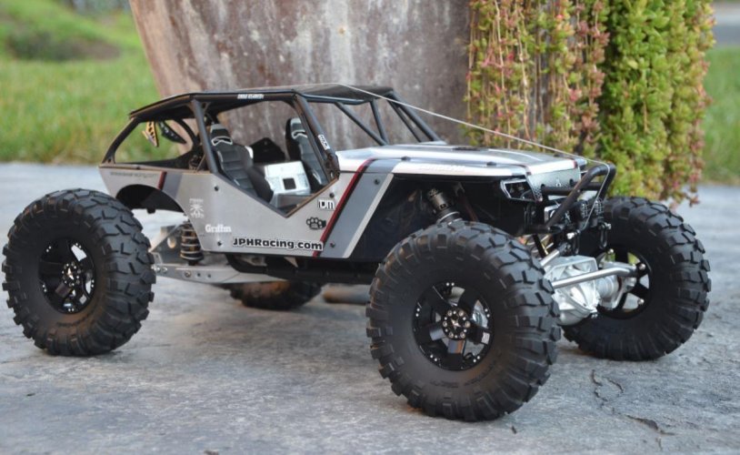

I was expecting the inner fenders to look more prominent than they do, but I am pretty happy with the outcome. I still want to get a set of 3D printed fenders that a member on here makes. They look so nice. I just don't think I could use his rears, as I needed to cut a lot of material to make these work, and his are much thicker.
Still have lots of ideas and details I want to add, but here is how she sits now.
