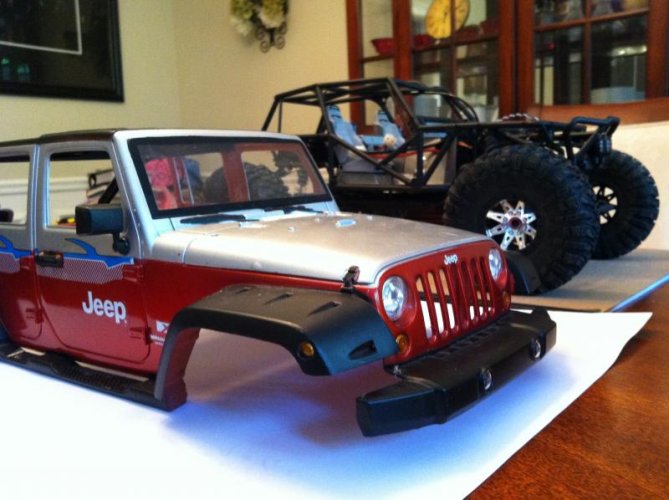

Heres the New Bright I started With...
Its off of the old chassis and ready to be worked...

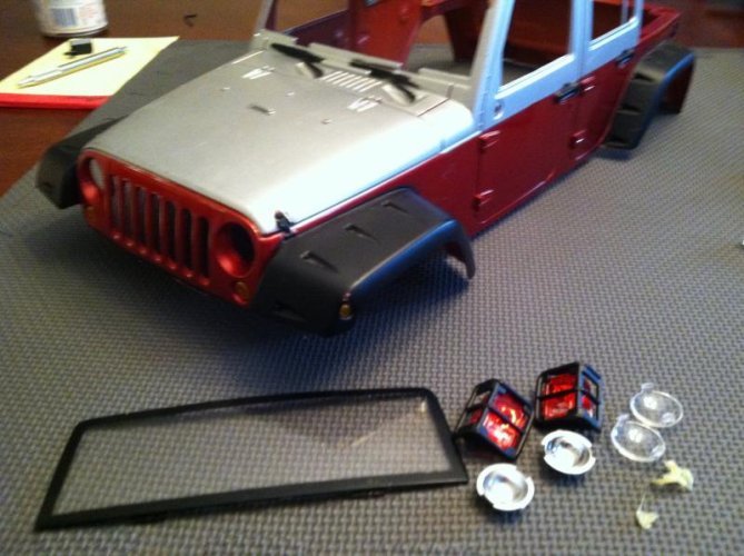

Started by trimming the bumpers and side-steps...
I would like to have kept the bumpers though to see how they fit before trimming... scale bumpers are hard to find... If you are attempting a similar build... keep the bumpers attached until you KNOW they are in the way... Then, if they are... cut 'em...

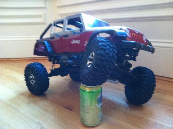

Here Is a pic during Initial fitting... Unfortunately to maintain Tire clearance for articulation and with the intention of leaving the fenders on, I knew I would either need a body lift or a suspension ilft... the body lift just looked silly... The top of the tube chassis was coming in below the windows...
So a suspension lift would have to be tried...and was easy enough to accomplish by just moving the shock mount down in the front like this..
Something similar, but a little more complicated was required for the rear, but it eventually didnt work out so I wont go into it further... but the truck at that point looked like this...
Which is ok if you like the monster truck look... I personally don't, and it wasn't really what I wanted for my rig... Besides I found out on the first drive it wanted to topple over even more than the stock Wraith, and the joints in the driveshafts were being severely over-stressed, Caster was way off too, so it just wasnt going to work....Back to the drawing board...

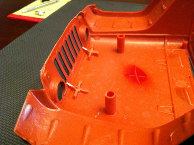

As for fitting the New Bright body, it actually was pretty easy to accomplish, as the tube chassis fits right inside of the New Bright body almost perfectly, and fittment is focused on the hood section. just trim out all the screw posts from the original model like this...
Be sure to trim the taller post too shown here before trimming....

Im sure some more talented modelers would find a better way to re-mount the rock guard, but I just zip tied it to the grille after like this..
I did purchase a second rock guard though, because I wanted to maintain the rigidity of the tube frame. On the extra rock guard, I cut the bottom bar section off and remounted it to the original points behind the grille, upside down which gave me my rigidity, and fog light mounting points back.
For the actual body mounting, I simply fit the body where I wanted it, and from the underside using a very tiny finger drill I used two of the original mounting points as guides, drilling up into the body from underneith. this allowed me to align the rest of the hood holes using the original body panels for templates.
I did use the 38 size screws for mounting rather than the original short screws, so extras had to be purchased.

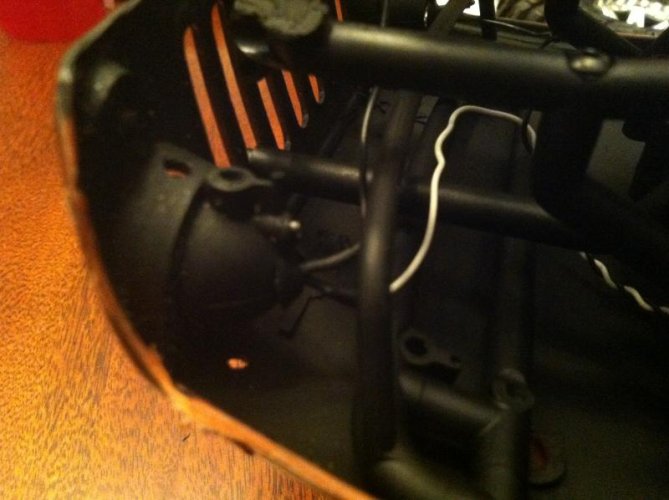

As for the lights.... The fog lights were switched for headlights, and vice-versa. Foglight cans (now headlight cans) fit right into the holes where the newbright cans were, but had to be glued into the holes.... the Tail light cans actually fit right inside the New bright cans, so I just glued them inside and snapped the cans righ back in.
This did lead to a dilemma though. With the battery in back there was no problem with battery access, and changes were simple, but once I moved the battery up front I ran into a huge problem... the LED's had to be unrigged from the cans everytime I had to remove the body to get to the battery, and re-rigged again after re-mounting the body.. This takes way too long, so I spliced these LOSI Micro battery connectors into the LED wires to allow Fast Disconnecting for body removal ...

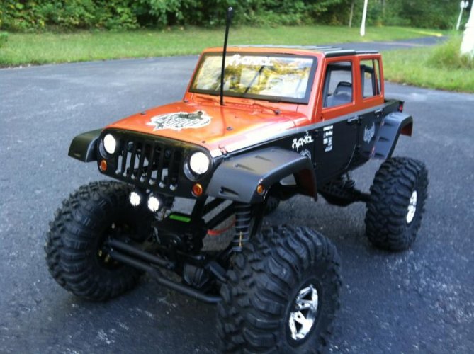

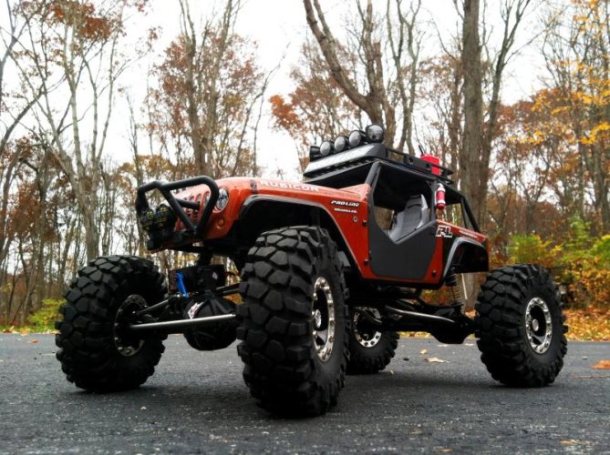

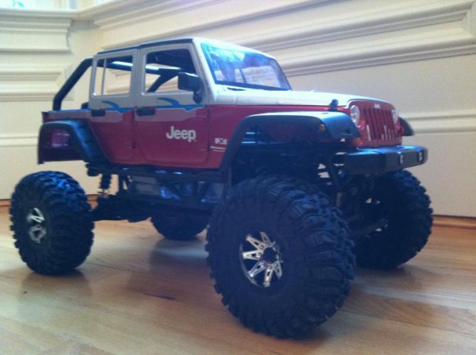

Ultimately I am happy with the build however after relocating the upper shock mounts back to the stock mounting points, I had to very reluctantly trim off the Fenders to keep the tires from rubbing. I thought I would not like the look, but I actually love it, so - Win! I may try and fit some 1/10 scale tube fenders on though, we'll see. for now though I like the finished look...

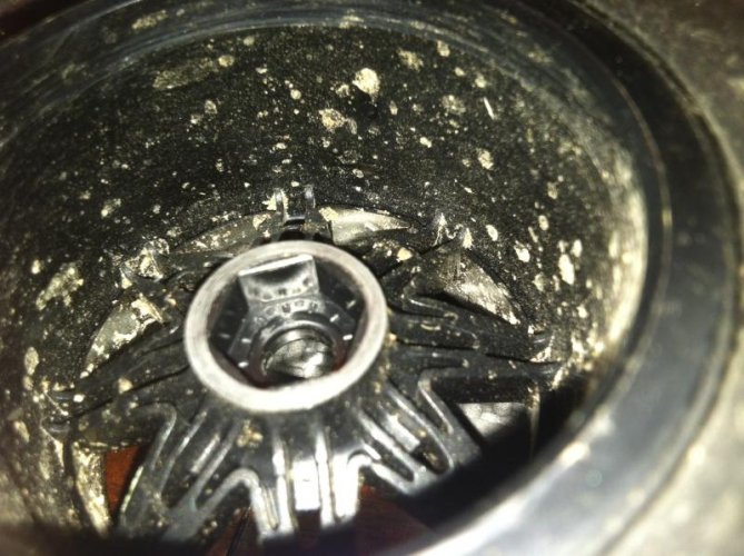

~Special Edition Black RPP 2.2 Beadlock Wheels (Required a little modification to the axel nuts to fit, despite being 12mm hex... Go figure)

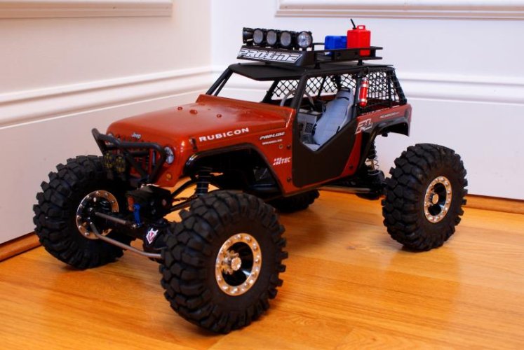

~Running on 6 Cell 5000ma Ni-MH Battery Moved to lateral position at firewall and relocated the ESC to the Passenger seat location, and left Reciever in original spot. (unfortunately body needs to be removed for battery access... I'm trying to work that out.... I still havent run the thing long enough to require a battery change, I usually run it down and then trickle it at 1.5 amps charge rate. This gives me about an hour of battery life.)
~Relocated power switch to passenger floor to make it easier to reach.
~Everything else is stock and has been working fine through about 10 packs without issue... So far even the stock 20 turn motor has not burned out although consensus seems to show that it will burn out before long. So far so good...

What exactly did you have to do on the axle nuts to make the wheels fit?
I had to use my dremmel to grind off the ridge around the post, and decrease the diameter of the post a bit. I also had to sand off some paint on the nut itself...
The shape of the back of the hub is different on the RPP than it was on the stock plastic Wraith wheel.
The little ridge on the nut had no recessed counterpart on the new wheels, and I didnt want to countersink the wheels, so this was a better option...

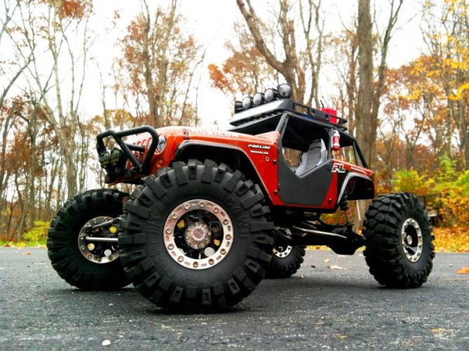

Well here it is if you would like to see it
Thanks again for the idea.
http://www.rccrawler.com/forum/axial-wraith/409647-64suicd-wraith.html
AWESOME! I'll go check it out! Glad you liked my work... I really wanted to make the front battery easier to access, but its a toss up between easy access and body rigidity... I chose rigidity, but I know there are alternatives... gonna go check out your build now... BTW Ive already swapped in a Proline body and accessories instead of the newbright. I liked it alot, but I wanted to try the Lexan body... Never did one before. I hate to admit it, but I think I like the Proline Body better...

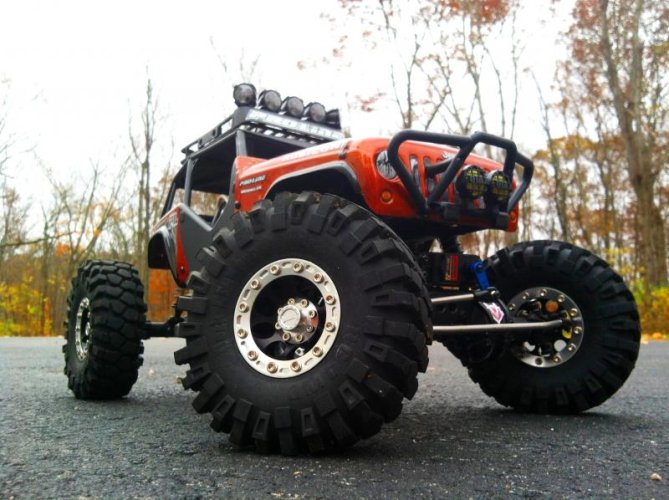

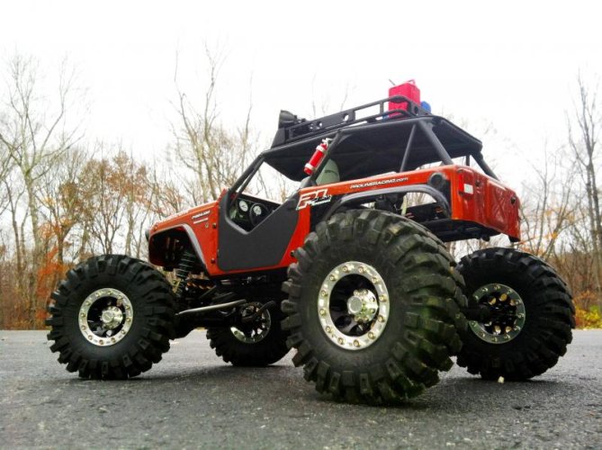

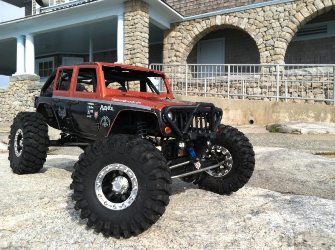

Love the Proline body on there. I'm working on trimming mine out now. Did you paint the outside of the doors matte black?
Yeah, i just trimmed off the protective plastic coating on the doors basically using it to mask off the area. It worked great, and looks more real. I hate to admit it , but i copied Prolines promo photos almost exactly on my proline mod. I just liked the look of it so much i couldnt help it. I did like my orange better than the yellow though...that body was a PITA to cut too. Used my dremmel on about 90%... Just too many sharp turns to make for scoring and tearing... How do you like my cargo net mesh? Its just plastic gutter guard from Lowes!
Who cares if you copied Proline. It looks great. I also used a dremmel on most of the body. Just put the first coat on mine tonight. Still have alot of work to do but glad to see yours all done up to give me a preview on how mines going to turn out.
