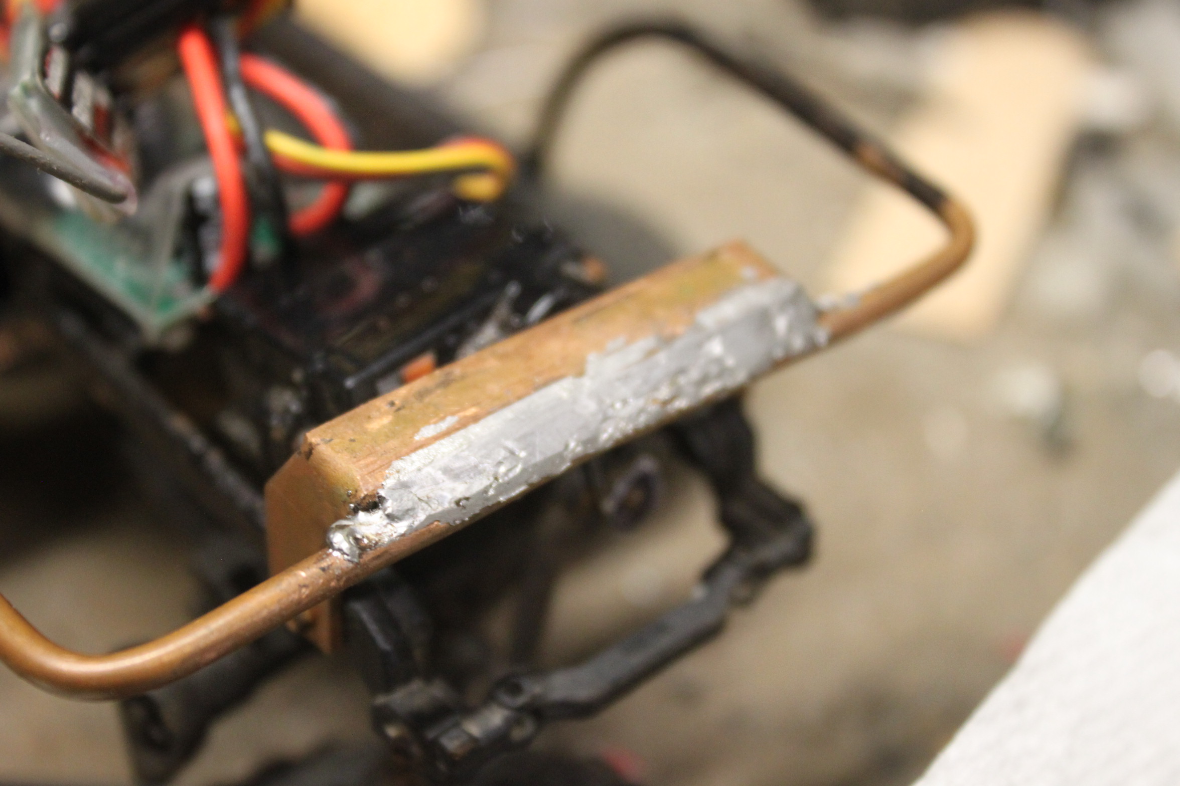

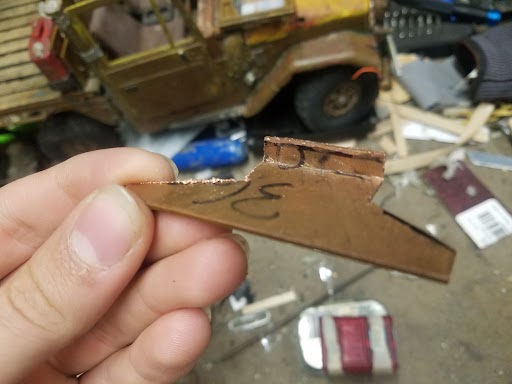

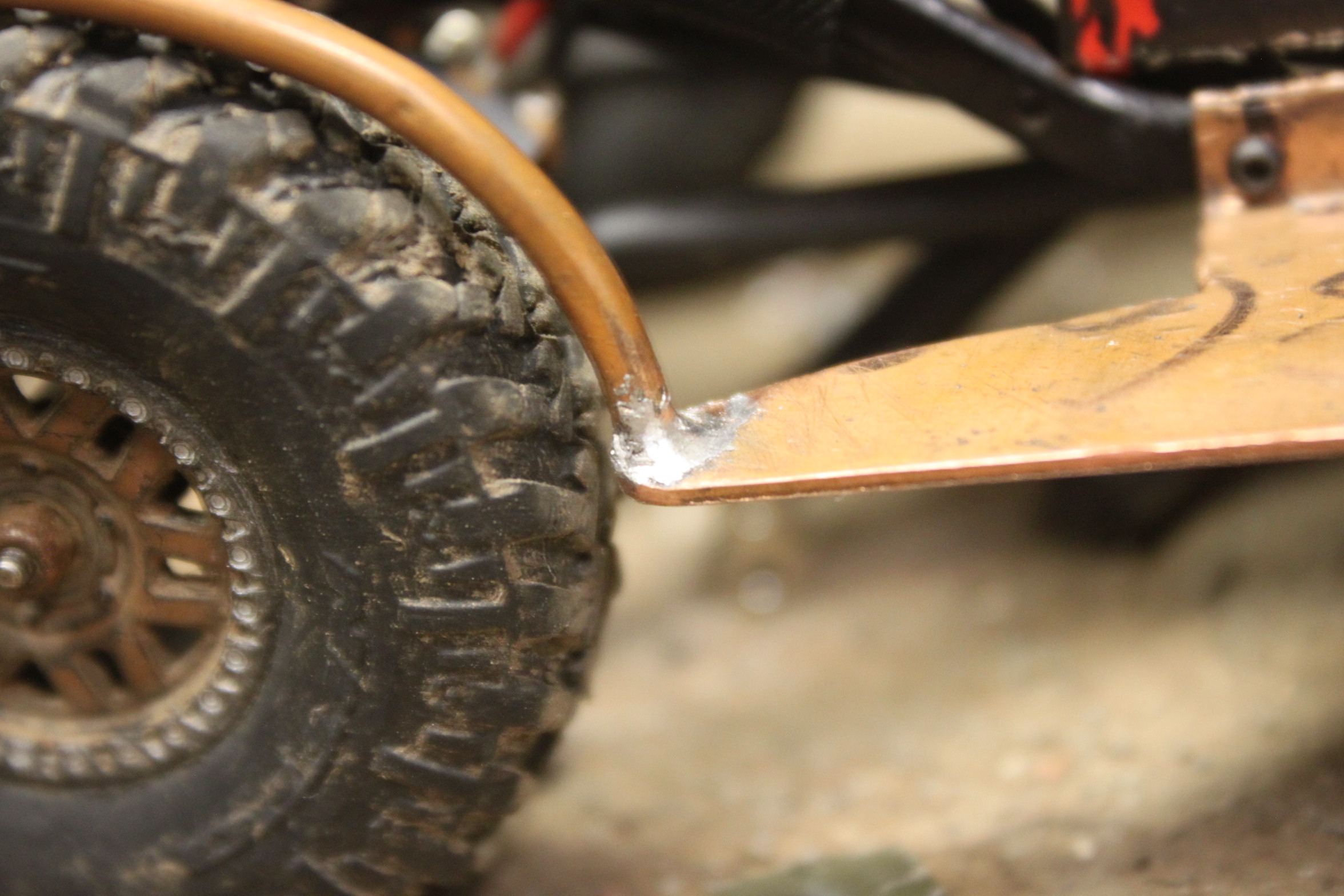

I am making some tube fenders/bumpers out of some copper tubing that I will solder onto some copper rocksliders.
The rear bit of tubing does not look very good at all but I am not very experienced with tube work. I will fill in the kink in behind the rear tire with some solder when I get to that stage.
I have ordered an esc to replace the stock esc that had seen a little too much salt water in it's lifetime.
-Eli

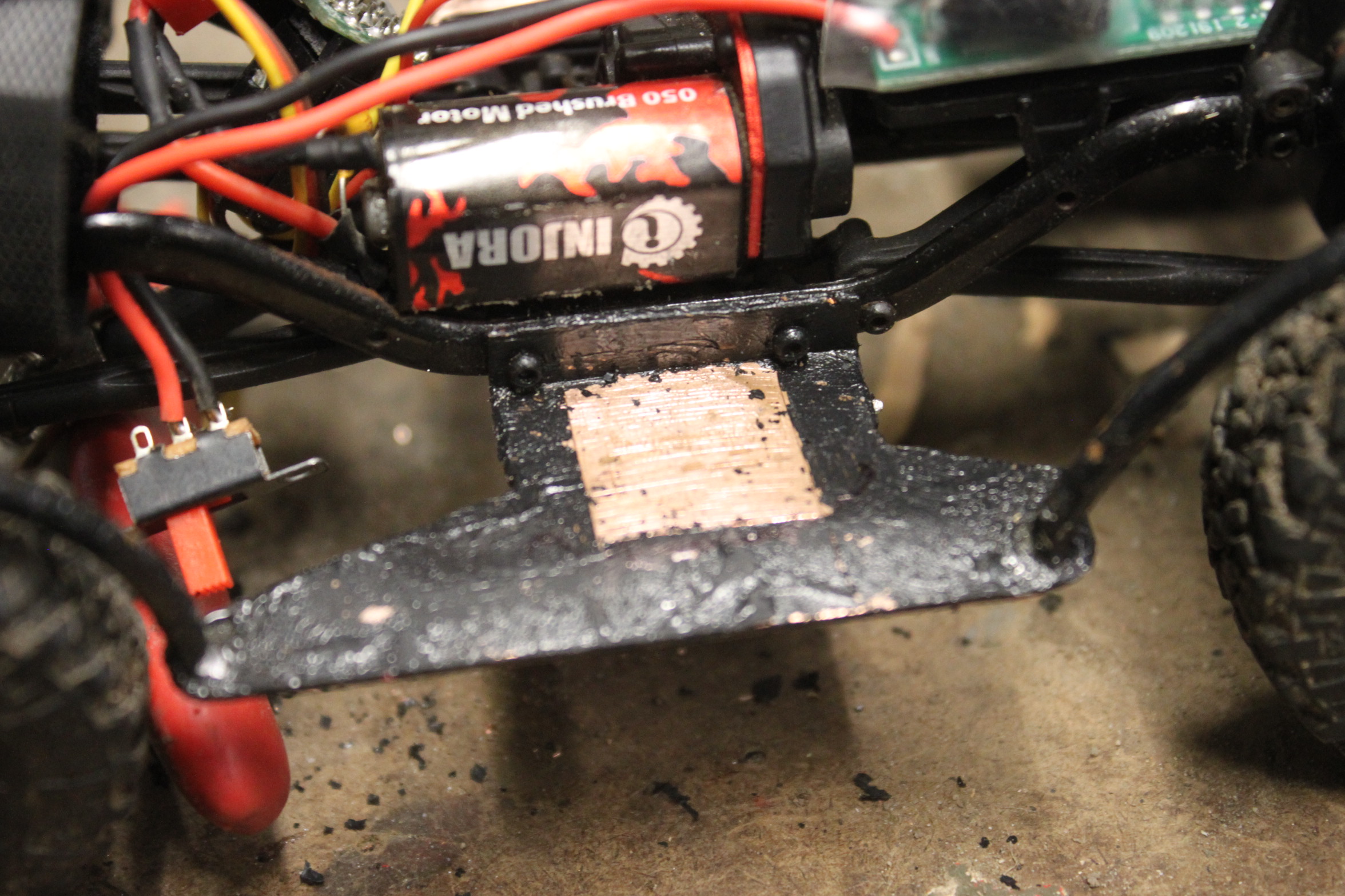

I have quickly gotten past the soldering stage, so here is a couple of un-focused photos:
(This was done with a soldering gun, which future me will not do again since all the joints were very weak)

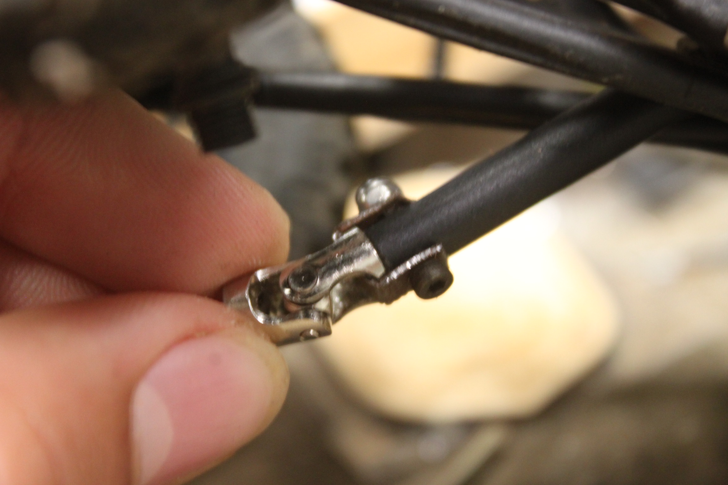

I also lost half of the stock rear driveshaft, so I made one out of some spare bits because I am cheap and don't feel like buying another driveshaft.

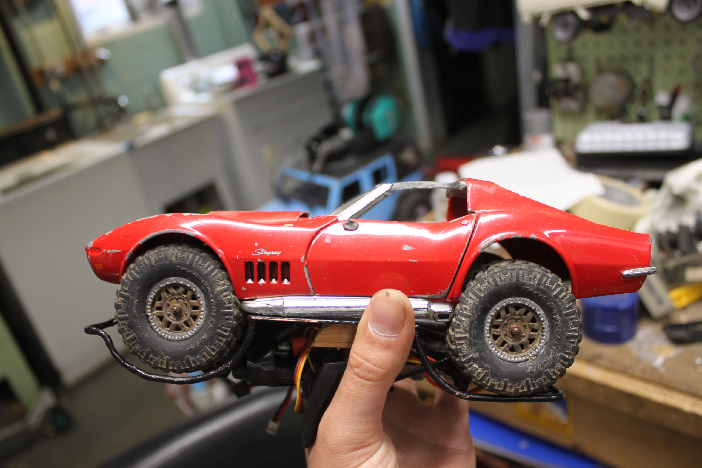

This might be a future project!

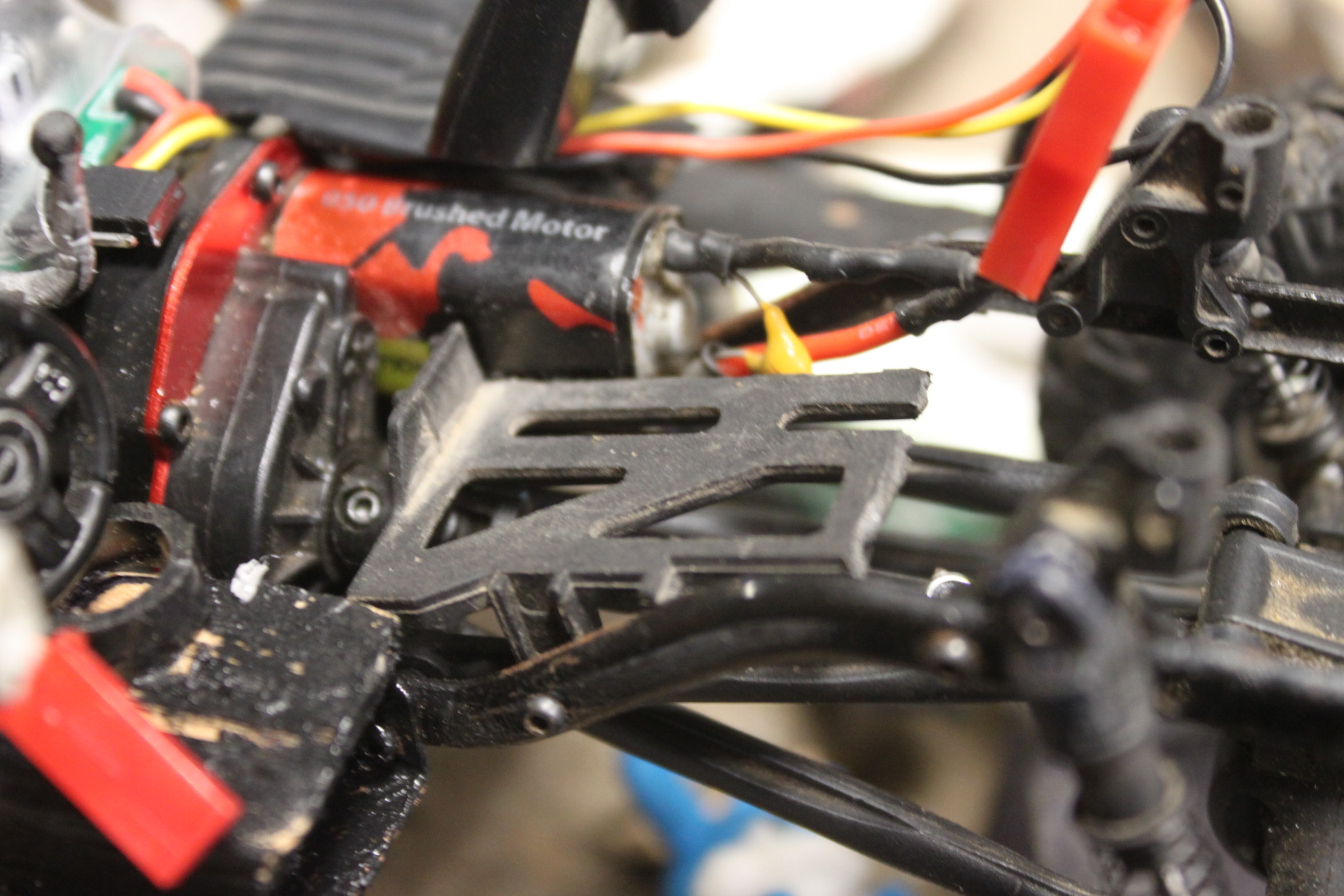

I also took the stock battery tray and chopped it so I could mount the reciever.

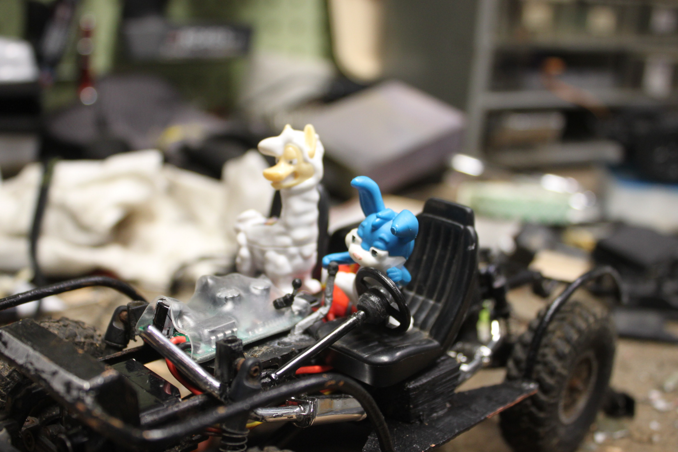

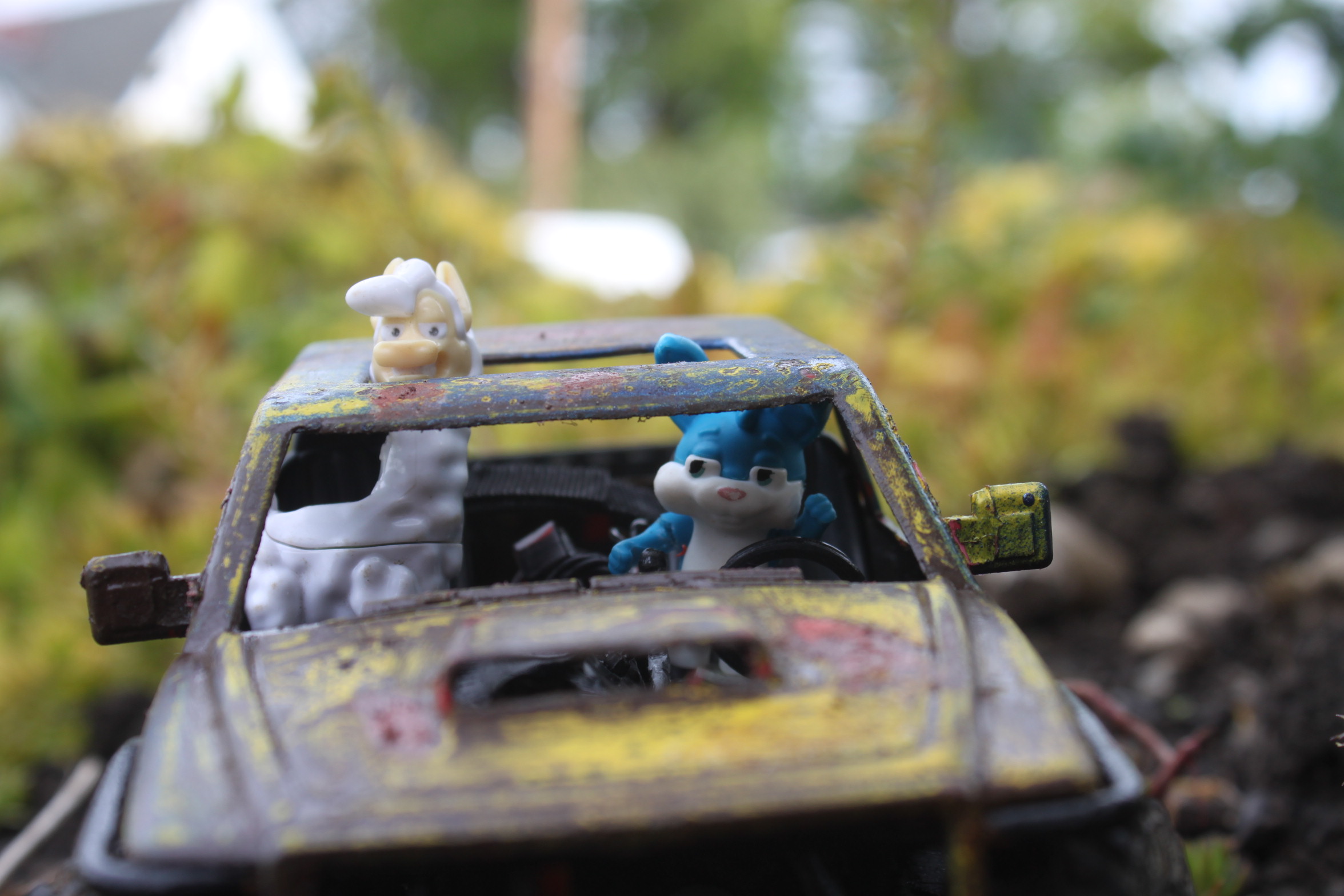

And finally, the reason the shifter and steering column were extended rearwards is because "Buns" and his colleague "Lenny" will be the occupants of this vehicle! (Don't ask how he uses the gas or brake)

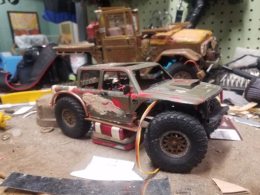

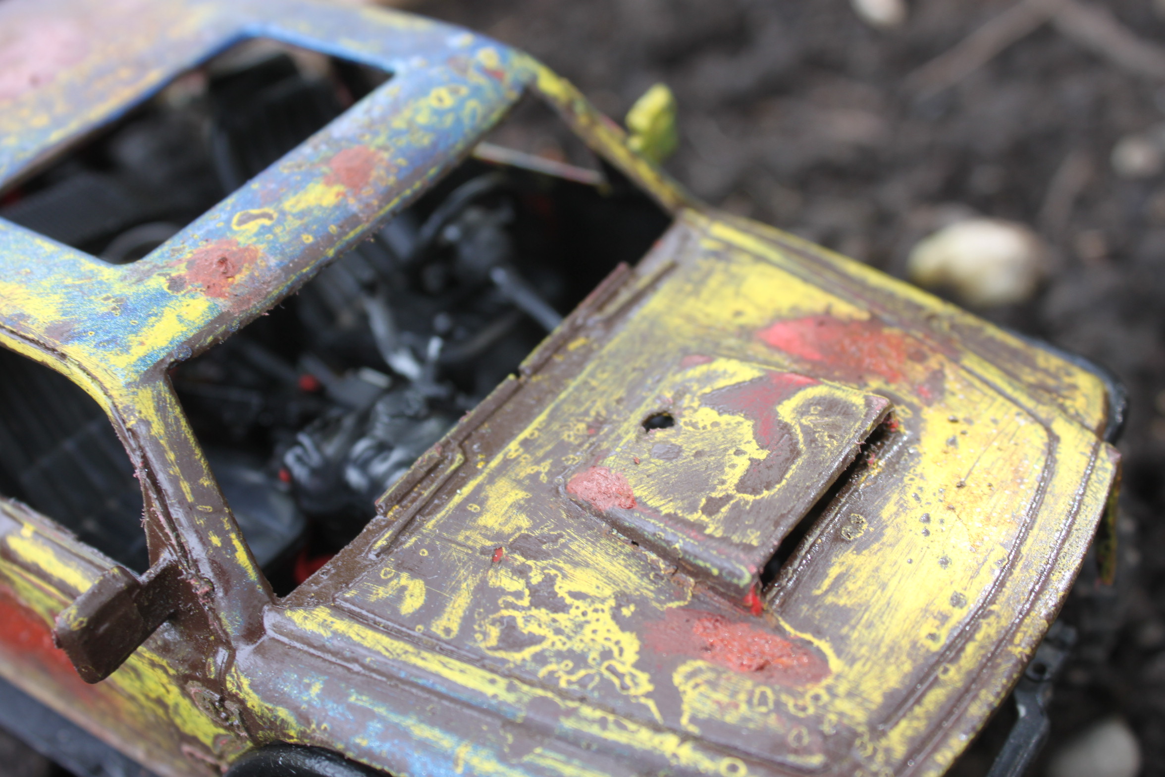

The body is in the "curing room" (cardboard box on top of waterheater) while the paint dries, it will be weathered with the salt method because I don't like nice trucks.
-Eli

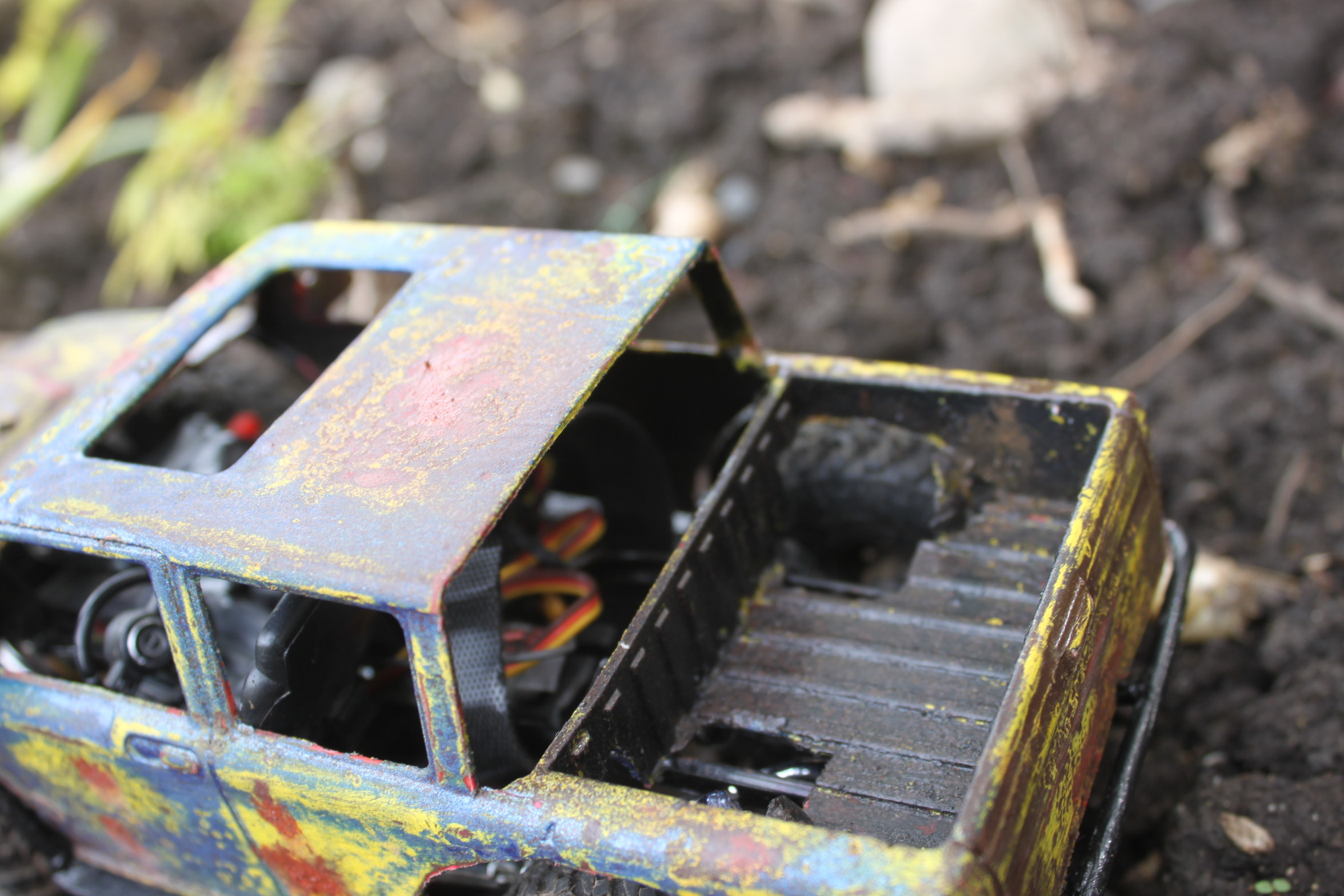

I got it weathered!
After this was taken I printed up the rear window surround to fill in that gap.
And, no, I haven't gotten around to making inner fenders for the bed.

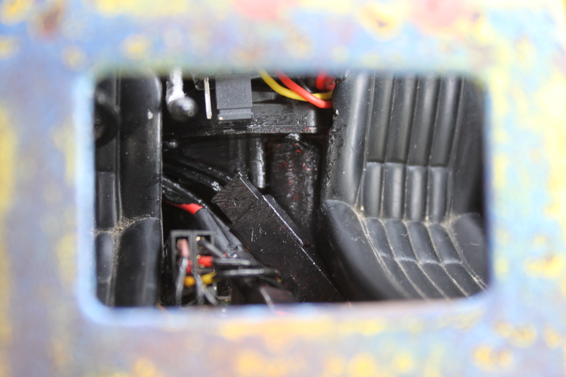

I also painted the wires between the seats and the motor black so they don't stand out. (I made sure to leave a little bit visible so I know the polarity)

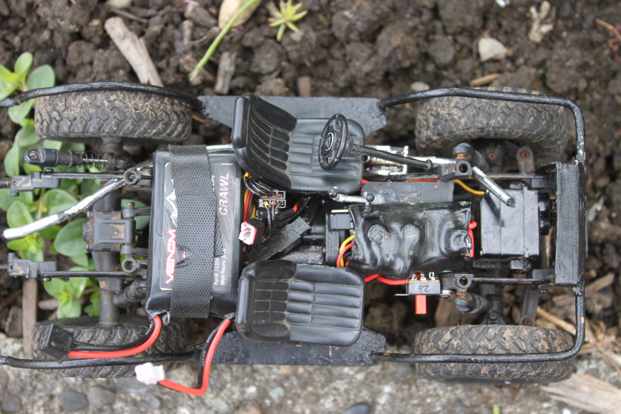

Here is a overhead view to show how everything is laid out.
And lastly, I got Buns and Lenny mounted up with some double-stick tape. I think they're ready!

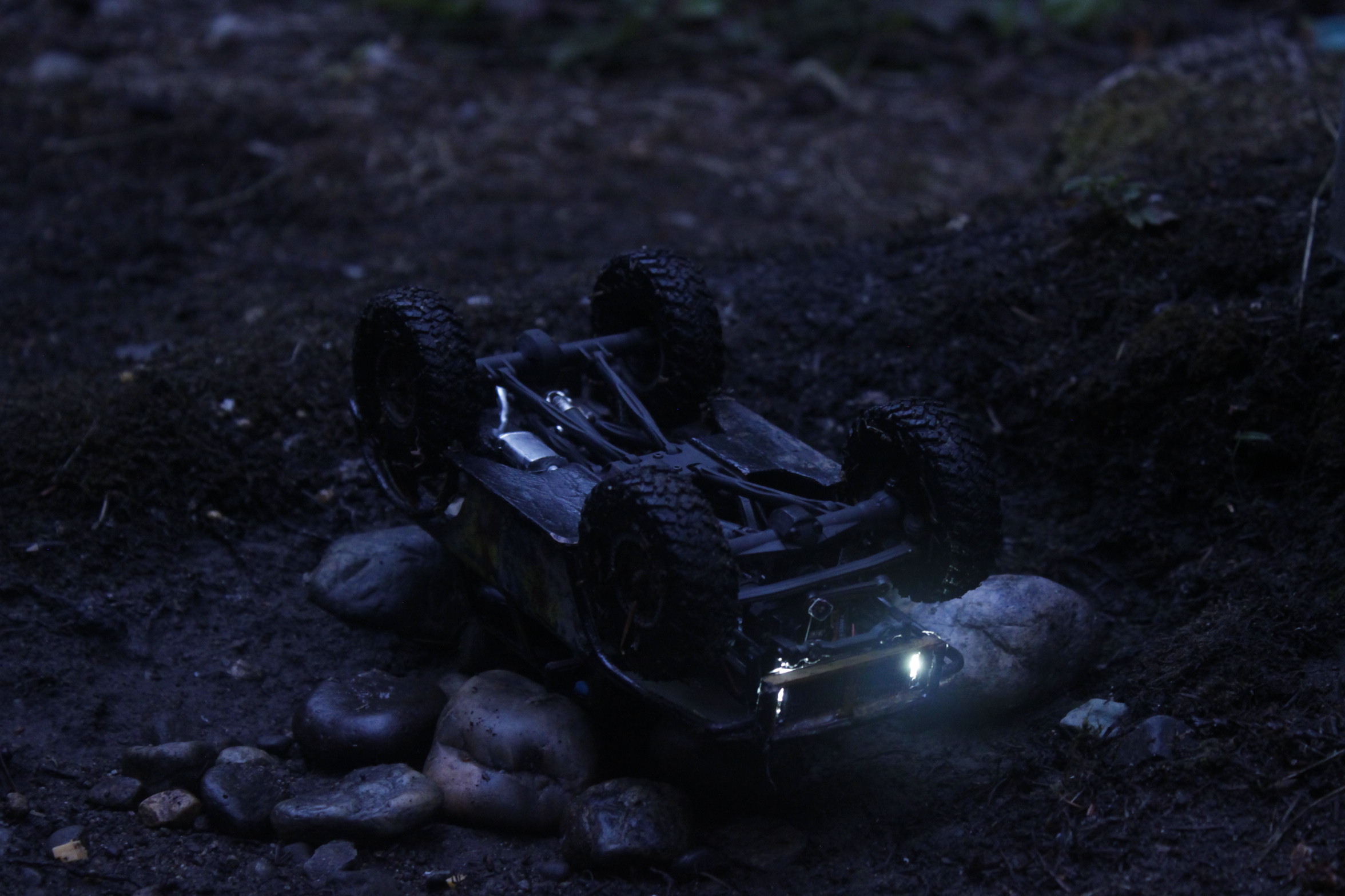

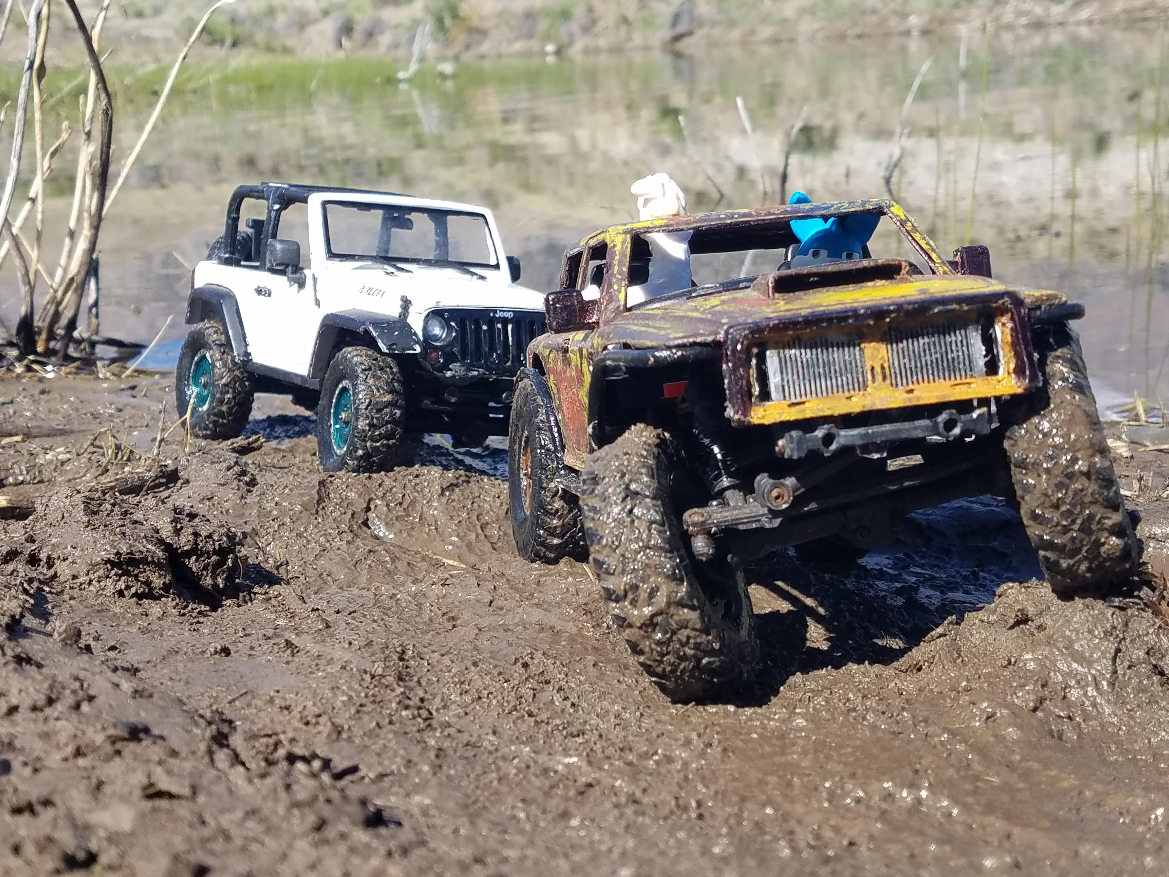

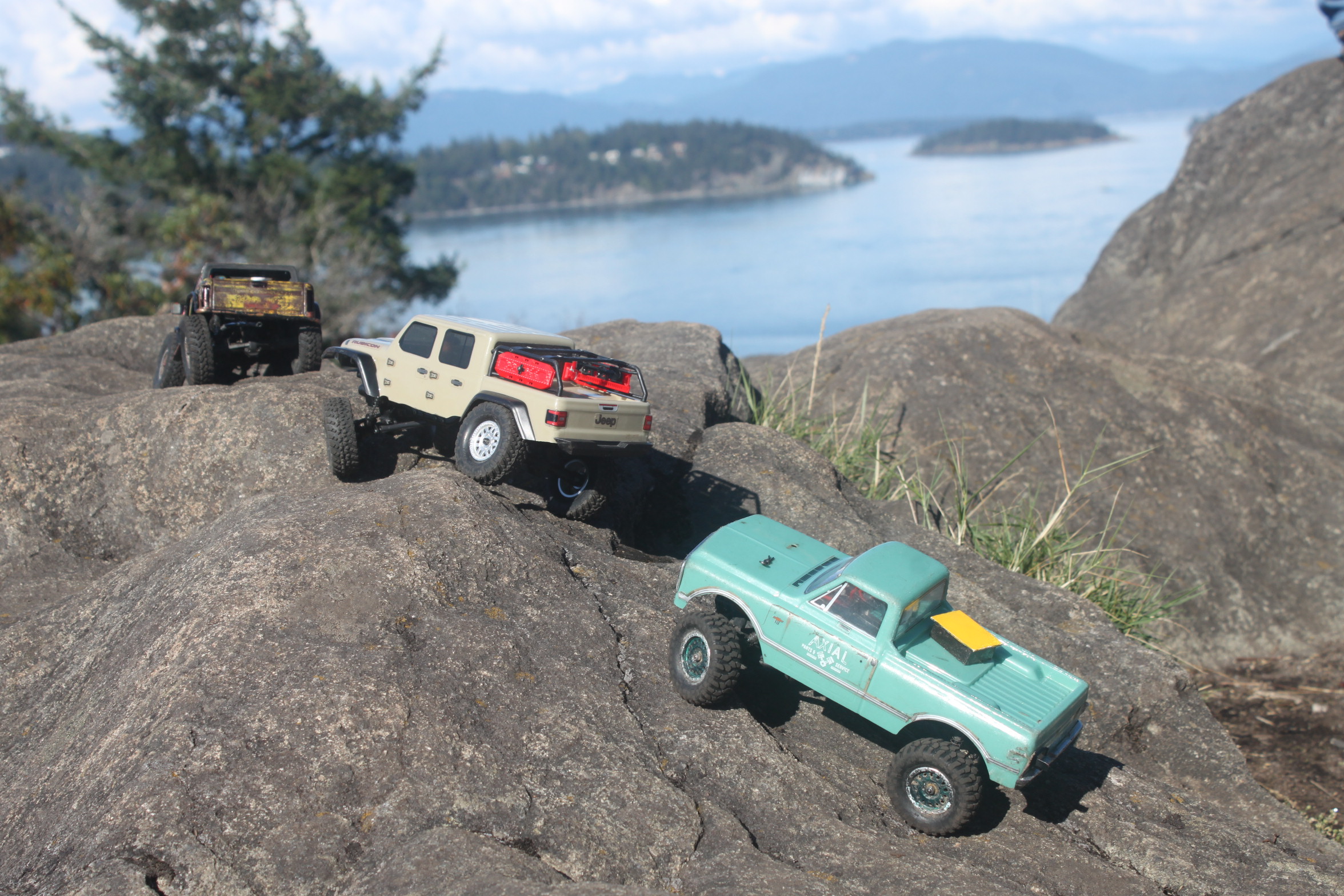

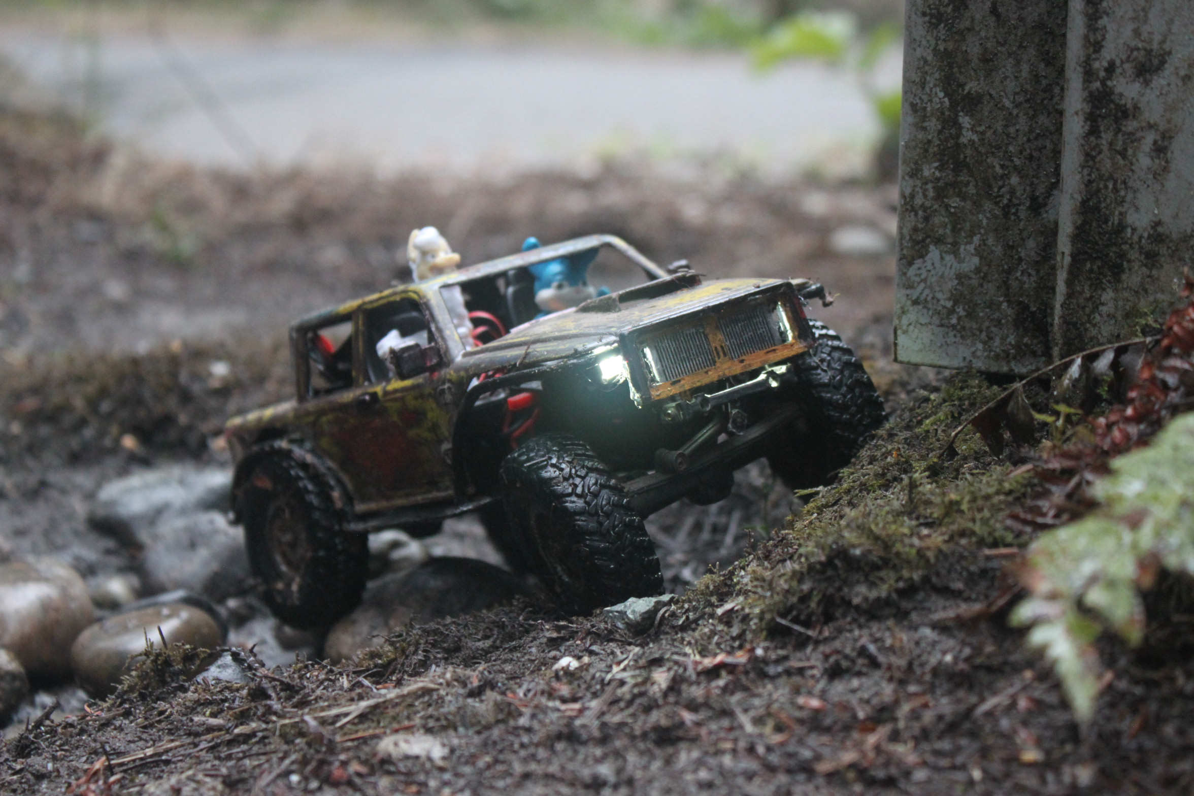

Here are some photos:

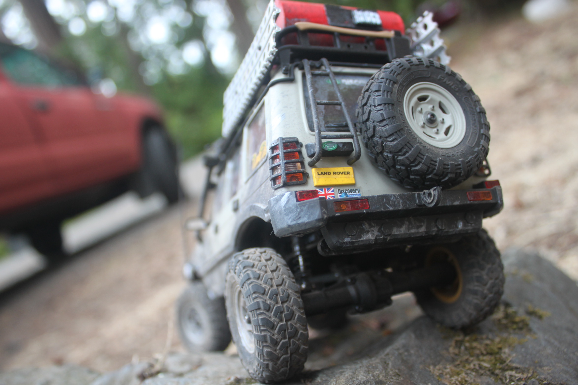

My younger brother brought his diecast body swapped Scx24.
The C10 is my brother and the GLADiator is our friend.
Benny borked it.
On the right is my other friends Fxc24M that he repainted and modified to look like some lunar thing.
It has been performing well except for the fact that the sliders stick out to the sides a little too much for tight, technical spots.
Rocks have scraped a ton of paint off of it though!
-Eli

Now that I have driven it for a while now, all but two of the soldered joints have broken! I think this is because the soldering gun didn't heat the copper properly, next time I will use a torch!
