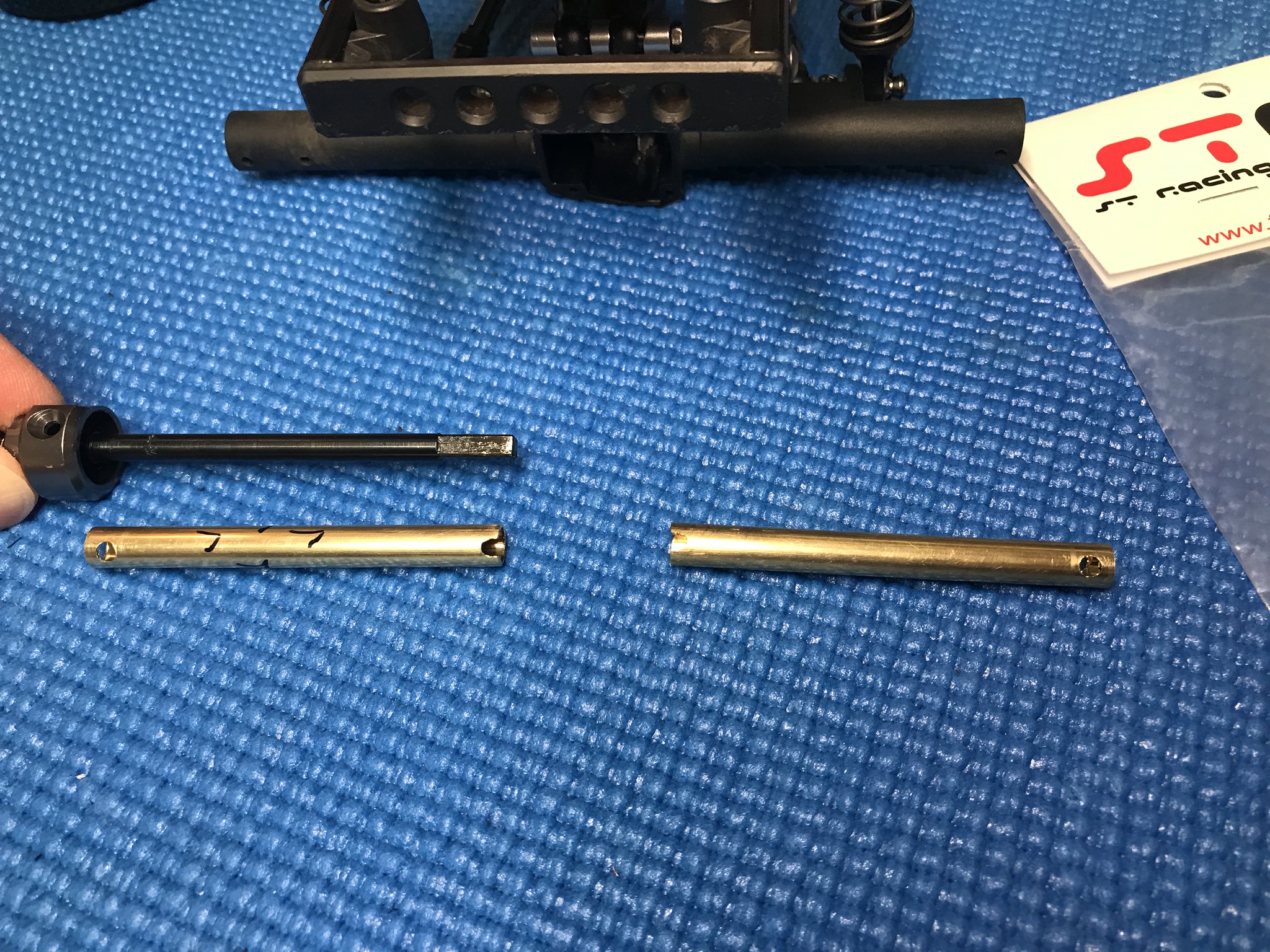

Added abpit 10 grams inside the rear axle housing, used K&S Precision Metals stock# 1150, Round Brass Tube 9/32" x 0.014" thickness ( 7.14mm x 0.355mm) cut to 70mm length and notched at inner ends for rear upper link mount screws, drilled two holes on outer ends for axle/bearing retainer screws. After test fitting, slid them almost all the way in and put tiny dab of E6000 to keep any potential rattles at bay, easy enough to remove later. No axle housing drilling or machining needed and accentuates the Vaterra brass brake rotors I'm using. :)

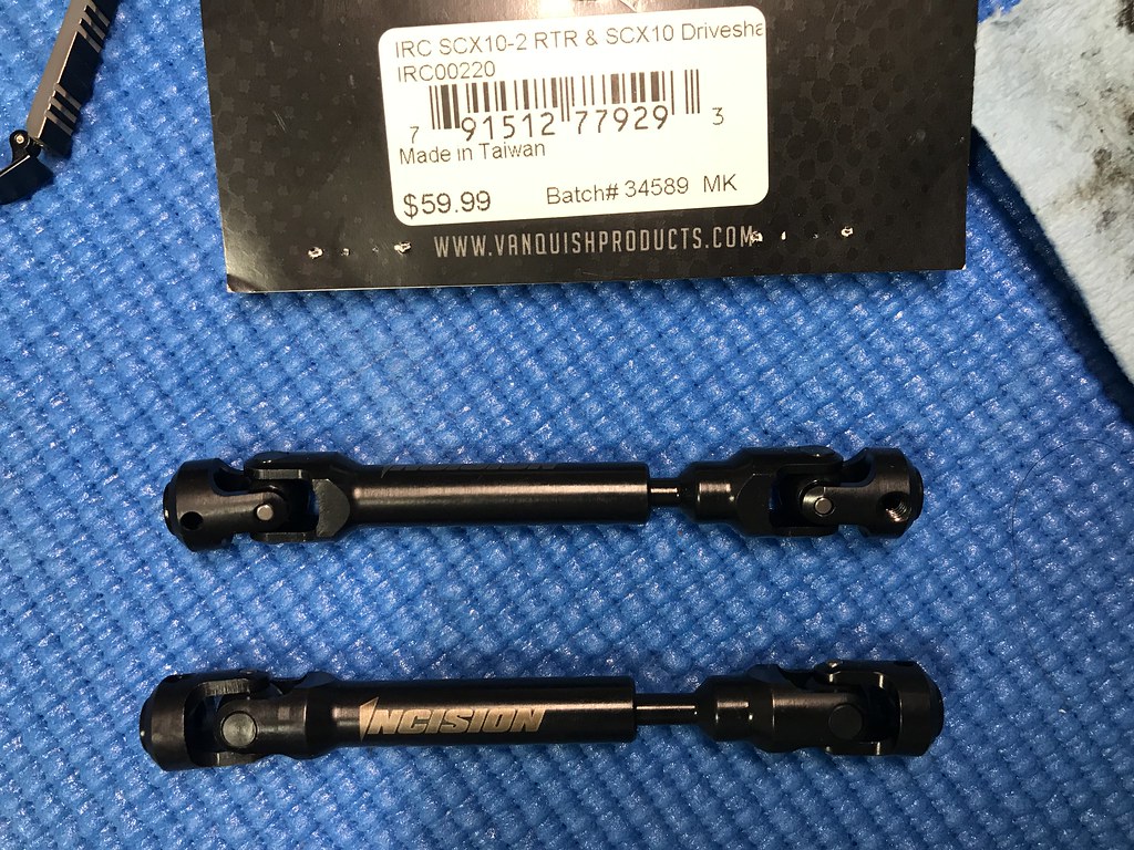

Also bought a set of these sweet looking shafts! They will fit WB4 looking like no trimming needed, but when the adapters arrive we'll see. :)
INCISION DRIVESHAFTS FOR SCX10-2 RTR & SCX10
SKU: IRC00220
https://www.vanquishproducts.com/incision-driveshafts-for-scx10-2-rtr-scx10/

Started fitting the Incision SCX10ii scale steel driveshafts by reaming out transmission case output shaft holes (they are very small to help keep dirt out of the bearings, unlike SCX), which helped. However, I still need to grind the little lip off the ends of the shafts next to the screwpins that retain them. There's enough steel there, but hate to modify such beautiful parts! Soooo...bought RC4WD

Fitting Incision scale driveshafts, had to open up lower transmission case hole slightly.
Using the new through-hole output shaft, still need to grind off some of the lip at end of driveshaft, wish the hole was a couple millimeters closer to the shaft end.
I haven't looked at those driveshafts. Pretty happy with the Junfac's. The Incision's look very tough though.
