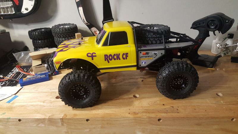

So i figured i should start a build thread of my ascender. I've had a couple of SCX's, a couple of night crawlers, (still do) a sawback, etc. I bought this thing and man i love it. it's just so solid.
anyway, I wish i had taken pics of how it came... but i didn't. but you guys have all seen stock ascenders before. So it showed up and i immediately knew this was the one i wanted to build.

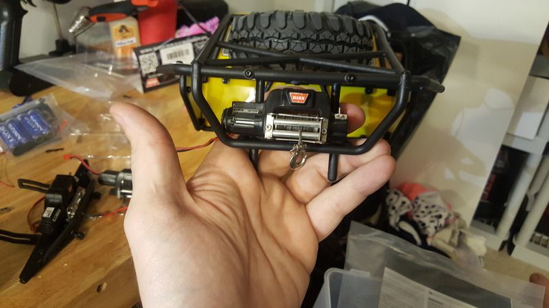

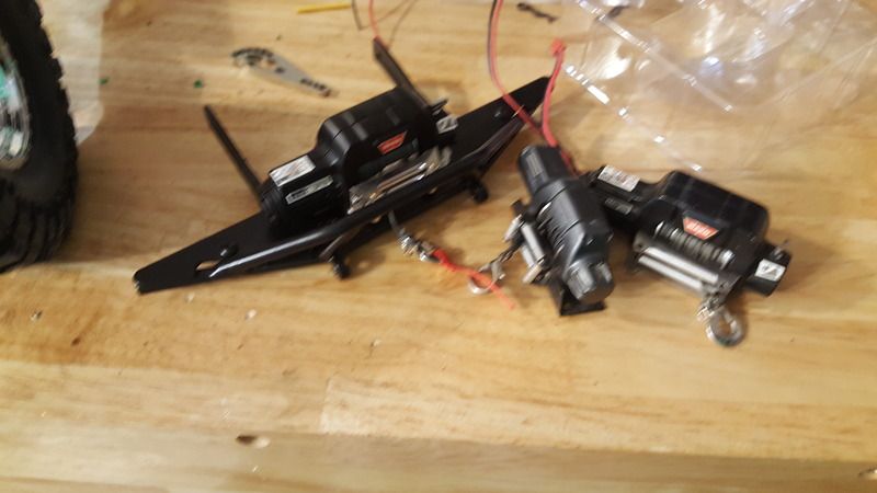

I started out addressing the front bumper. Servo winches are cool but i like the look of a scale winch hanging off the front. I wasn't wild about the ascender bumper options out there so i bought this SCX10 bumper. I thought the tube look fit the look of the rig. And i got to building.
i had to lower the body slightly in the front but otherwise it was basically a bolt on.
In the rear i made a small plate from a stock Traxxas slash front skid lol. i just needed a piece of flat plastic. and i mounted the rear winch into that little spot.
next i used some scx10 shock keys i had laying around and relocated the upper shock mounts:
also i grabbed some method beadlocks and proline swampers off a buddy of mine that needed to thin his tire bin out some. i think it sits pretty good right here...

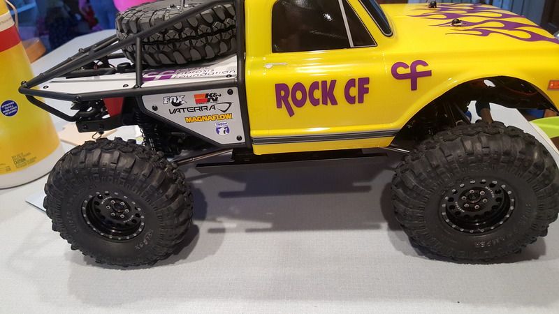

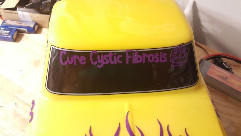

so anyway, since CF ends up becoming your life (as with any terminal illness) i figured i'd use the vinyl cutter and do some custom stickers for the ascender.
need to shrink this a bit but that rose is SO fine it's hard to make smaller

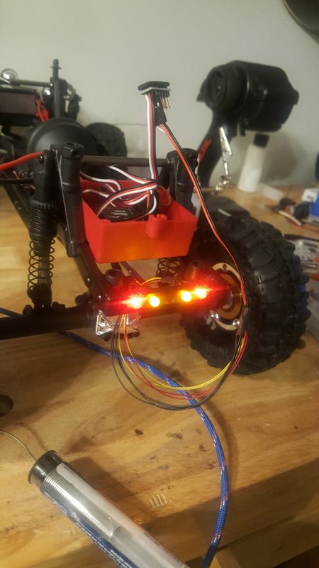

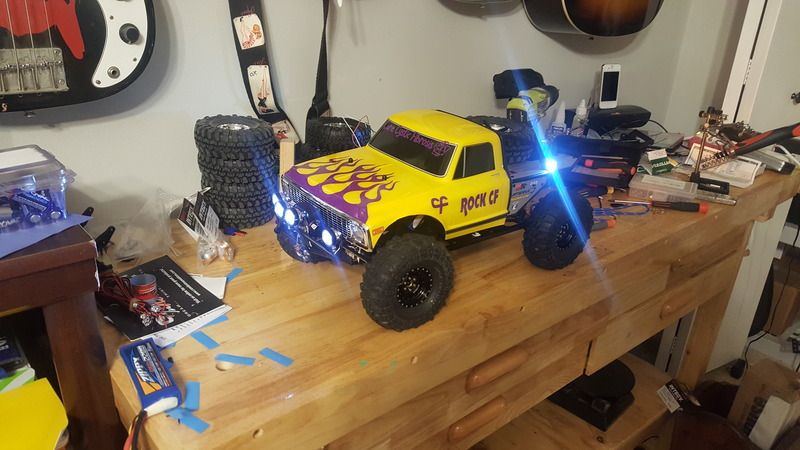

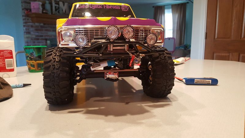

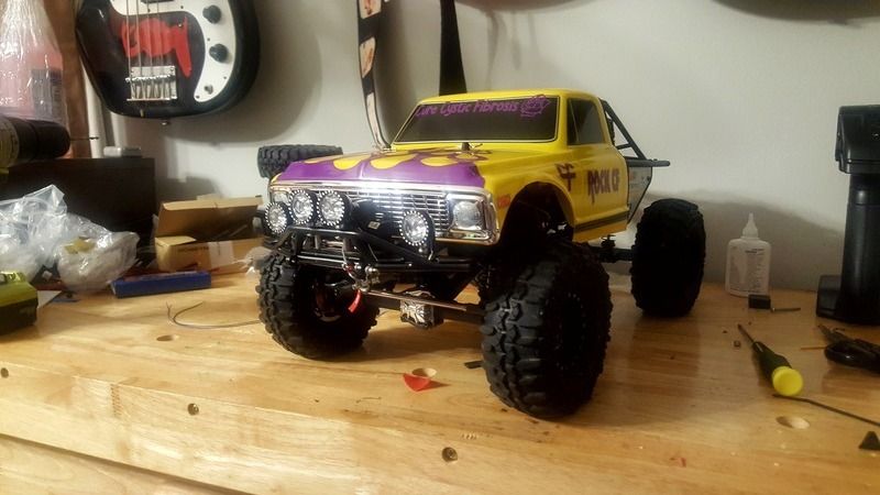

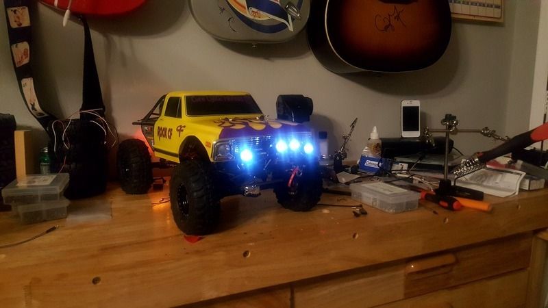

So i'm also a big fan of lights on crawlers... I know function wise they're just added weight. But i enjoy the heck out of them. so I started to do the lighting. Still not sure how i'm going to deal with the buckets for headlights but figured i'd start on the chassis.
I added 4 integy lights to the front bumper. drilled out the metal bar (that was fun) and added 2 up there, and then 2 on the flat part of the bumper:
The rear cross member actually holds 5mm LED bulbs perfects. a dab of CA glue and they're in there solidly.
and another look at the side:

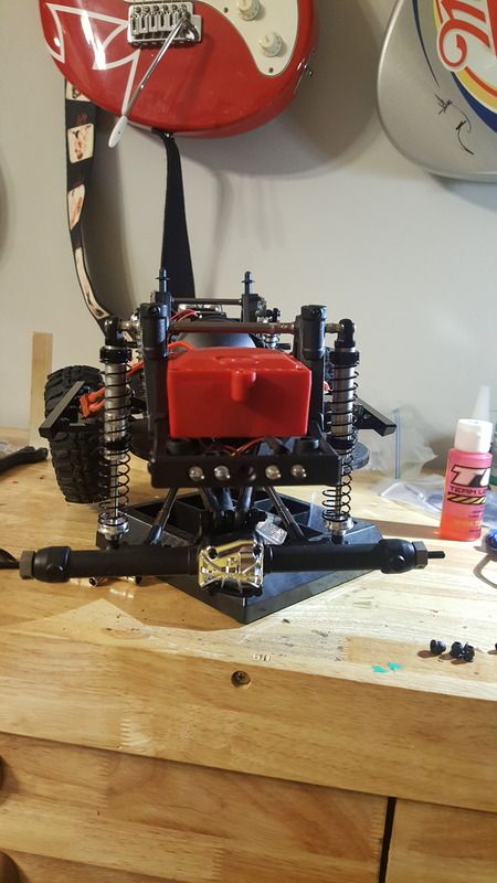

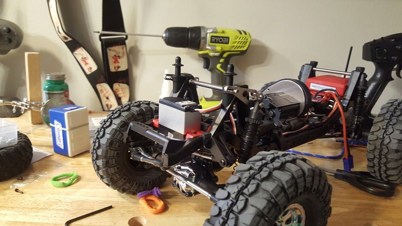

Last night i started working on some of the mechanical parts of the crawler.

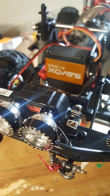

110 mm rrd shocks front and rear. Rears are outboarded. Fronts are on keys
also, to handle the 10 oz wheel/tire on each corner, i upgraded the steering servo to a 500oz Savox with adjustable no brainer BEC:

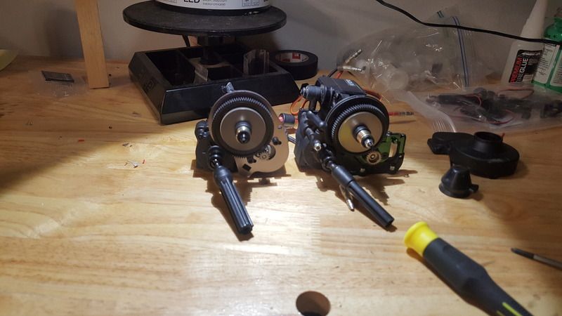

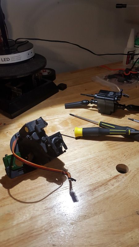

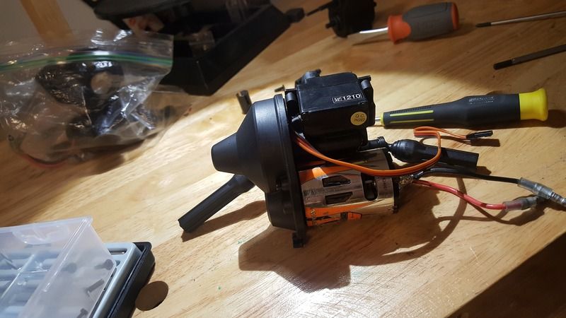

and then got on to the interesting stuff... I traded an SCX for a twin hammers the other day. i was 150 bucks into that scx so why not. I yanked the trans from the twin hammers and the swap fun began:
1 freaking screw. 1 little tiny 1.3mm screw is the reason i had to pull the case apart to swap the mounts.

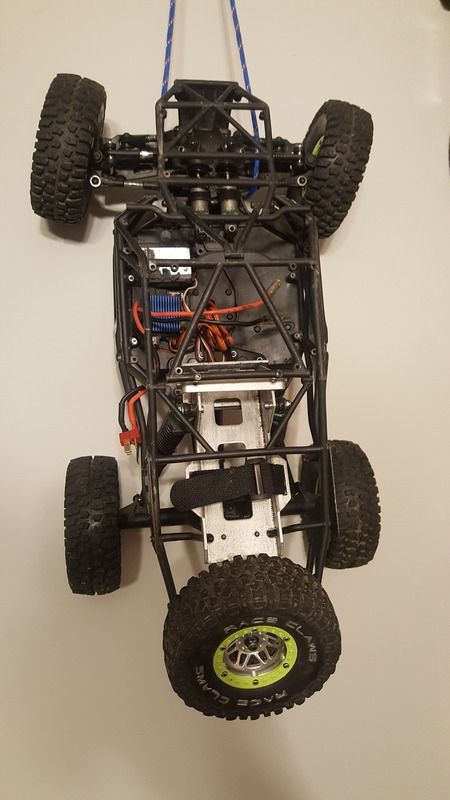

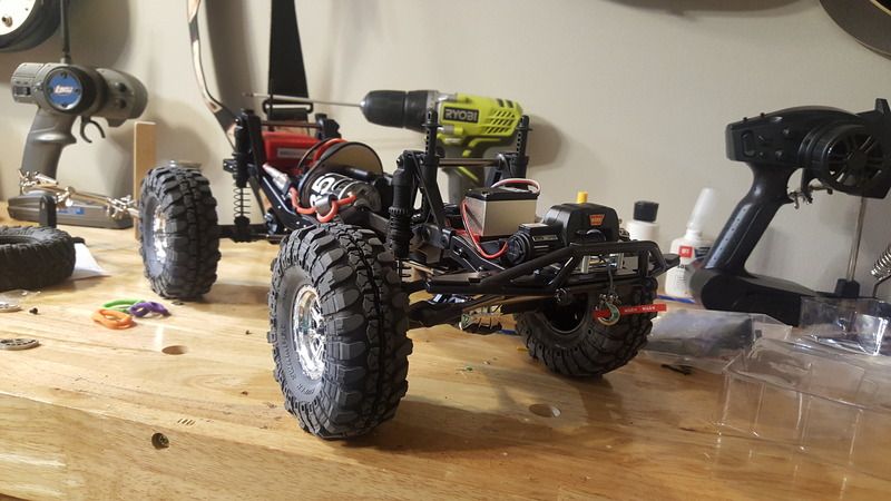

Success! swapped in a 55 turn motor i had laying around (that i did NOT solder the wires to... wherever i got it, the previous owner did that mess). I just wanted to check proof of concept for the rig. Then work out gearing/motor. What i want is high gear to be very close to stock, with low gear being VERY low. 55T wasn't bad. But I ordered an 80t rebuildable to try out.
2 am this was where i was at:
and i was wrecked. the wiring is just laying there. it's all just to test everything out. once my JCAD battery tray FINALLY gets here (they were out of stock when i ordered... but you know how it is... impatience!!!) i'll be able to move everything forward on the chassis.
also now the twin hammers is sadly hanging on the wall. with it's heart ripped out lol:

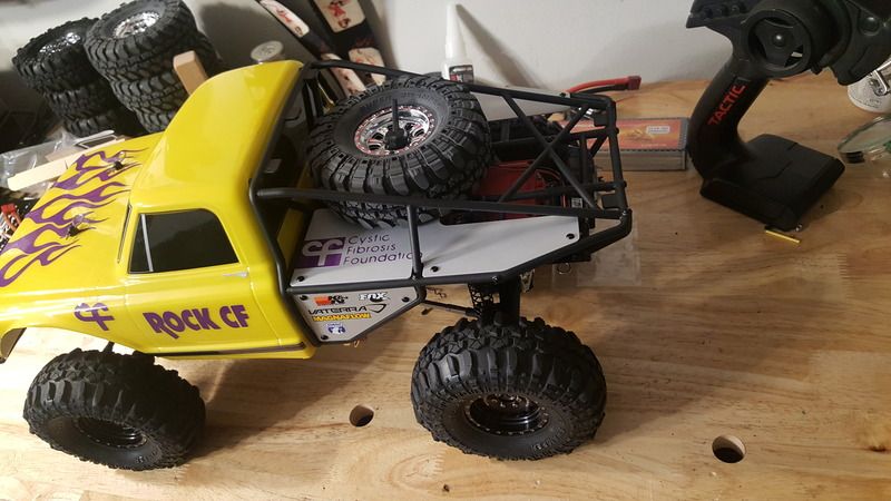

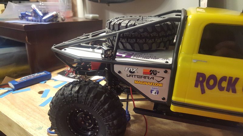

oh something i forgot to add. added some work lights to the bed the other day.
you can also see the rock rails i forgot to mention earlier as well.

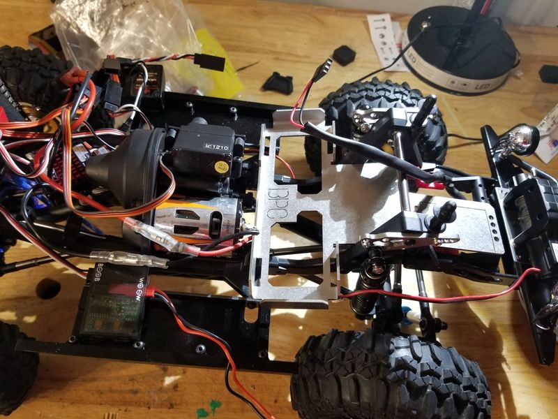

Battery tray came in. Ended up with a bpc because jca can't seem to get their parts to work. I ordered a setup 2 months ago and it's not here. So I ordered this bpc and am very happy with it...
Unfortunately I can not find the piece that turns my servo 90 degrees. I don't know why the k10 came with it set up horizontally not length wise... So I ordered an aluminum mount... from Hong Kong. Sigh.

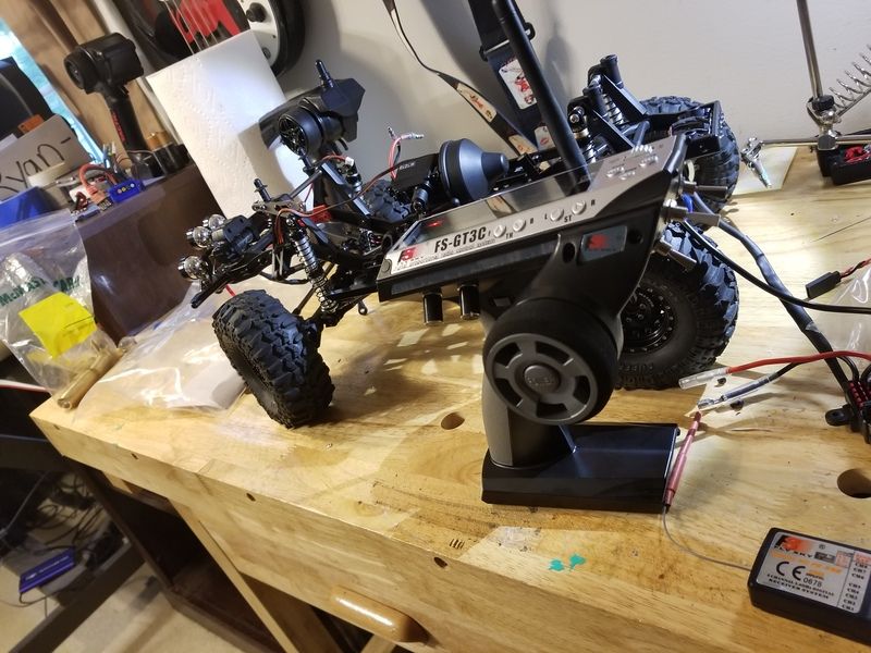

The 8 Channel radio...
S many switches
Also got the 80 turn in.
Yes, I wish the rx box was 1/4" deeper, little longer wouldn't hurt either so that we don't have to be so careful to not smash the wires where they enter the back side of the servo plugs into the rx.
If you could get away with a six channel receiver the hobby king ones have the plugs pointing upwards and fit really well in the box �� And they bing no problem with the gt3c. Or de case the 8 channel to gain a few mm �� That's how I'm running one in a summit looks good dipped in plastidip ��
