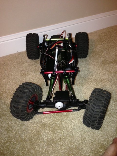

I am going to build this in here.
Specs:
Gmade R1 Chassis sides with aluminum belly plate
Gmade/Junfac driveshafts
Gmade Bighorn tires
Junfac 13mm wheel wideners
Twin Hammers Trans
SCX10 steering axles for 4WS
CC 3800KV motor with a 19t pinion
CC MMP ESC with 10A BEC
Futaba 3pmx radio
2 HPI SF-50 servos with savers
Venom Creeper Aluminum Shocks with internal springs
Venom Creeper beadlocks
Various Venom Creeper link pieces
The goal is to have a rig that can crawl, bounce, hill climb, FOFF, trail ride, jump, race, and be fairly reliable while doing all that.
Here are some pics:

I reworked the front shocks a bit and am working on the hood and roof today. If I get the 2mm bolts in this week it will get its first drive this weekend!!

The only reason for the chassis to be wide is to fit the battery on the belly plate. I had to turn the trans up to get it this narrow and I could have bought smaller packs and did some things different but getting the battery in and out of this thing is gonna be a bit of work I think so its built to fit the 5000MAH venom battery. The receiver is going to mount under the hood and the ESC will mount behind the spur on the back side.
The TH trans has a 4.05 1st gear and a 2.27 2nd gear. Its a little bit smaller then the ae-2 trans which helps to fit it in the chassis. With the way the TH is going there should be steel gears soon for it. But as it is right now the ae-2 trans is stronger. I'm not sure on the ae-2 ratios.
