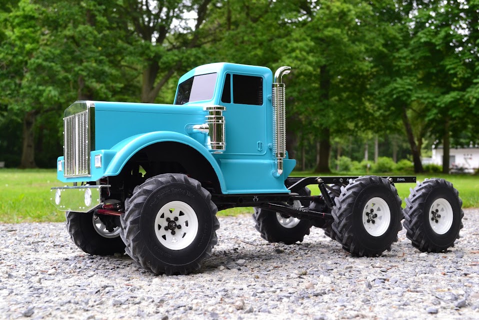

Kraz-255, full metell.
Scale 1/10
weight 8.3 kg
Axle- Wheely King
Transmission- Wheely King
Wheels- 2.2
Motor- 60T
My attempt

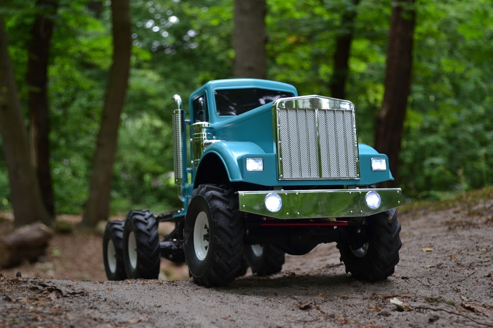

scx10 based
each axle has panhard bar
overdriver front gearing, middle stock gearing, rear underdrive
HH brxl and torquemaster 35t
7:1 trans
hitec 7950 cms
heyok servo winch
