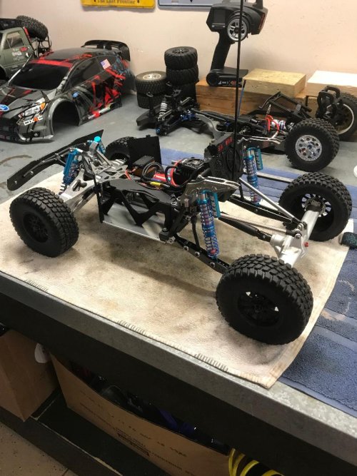

She is now "officially" as clean as she's been since NEW! Finished up the complete service with total shock rebuild. Got everything buttoned back up and dialed. I've confirmed the RC4WD aluminum SC wheels do stick out too far with the body on, even with the narrower of the two sets of hubs they come with. I won't be seeing my buddy who can machine them down for at least another month or two, so in the meantime I ordered some LOSI SCBE wheels with beadlock ring to mount up the new rubber.
Still have to get the new "basher" body painted up, but not quite warm enough out in the garage with the door open for ventilation. As far as bodies and paint go, does anyone know of, or have a good source for scale decals for Trophy Trucks? I've found Monster Energy stuff online, but I'm just NOT going to be the guy that does another Monster Energy themed vehicle.:shock:

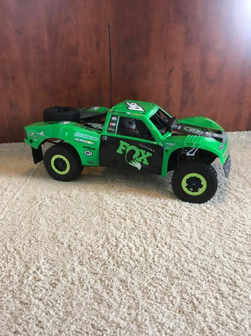

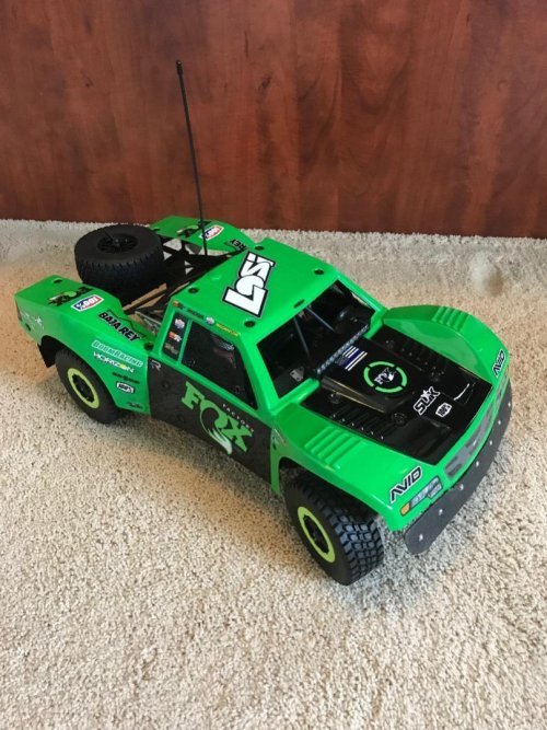

Got the new SCBE wheels and bead locks on the B-Rey. Quick shout out to JDM74 for the deal on the wheels and tires. The green is a little brighter on the bead-locks than the body, but it still looks pretty sweet. I've also got an orange set for the new daily driver body i'm going to be painting up. I decided I'm going to do K&N Filter livery on the new body. Black, orange, and maybe a bit of white.

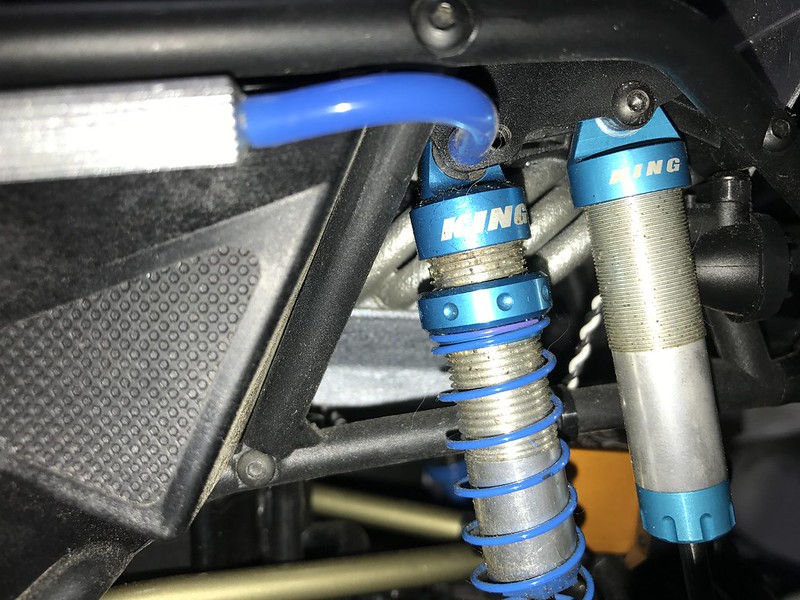

On another note, is anyone else running / tuning KING shocks on their Baja Rey? I've played around with mine 'till I'm about nuts and still just can't get them where I want them. The biggest issue I've had is the stock spring rates suck for this truck, and they're a dual stage design. I can't seem to find a tuning kit/springs anywhere for these shocks. The closest I got was running the stock Baja Rey single springs with the pre-load adjuster wound way down to meet the spring as it's a good bit shorter than the 2 springs on the Kings. It has to come so far down though that it leaves me nowhere to go but up with the pre-load for adjustment which leaves the spring jangling loose on the shock body. I've also run everything from 35w oil, which was way to light and had them "pogo-sticking" to 85w which just gave them a dead feel.:cry: Absolutely love the look of the Kings on this truck, but If I can't get them sorted they're going to the parts pile!

Maybe try the Yeti TT kit shocks? I'm pretty sure they are kings also. You can get he option shock caps that are Al and say "King" on them if you want. They look pretty nice on my bomber
Untitled by JASON MCKIMMEY, on Flickr
The front shocks with no springs are RC4wd and the back ones with the springs are Axial Bomber kit shocks. The same caps that you can get for the Yeti TT rear shocks.
