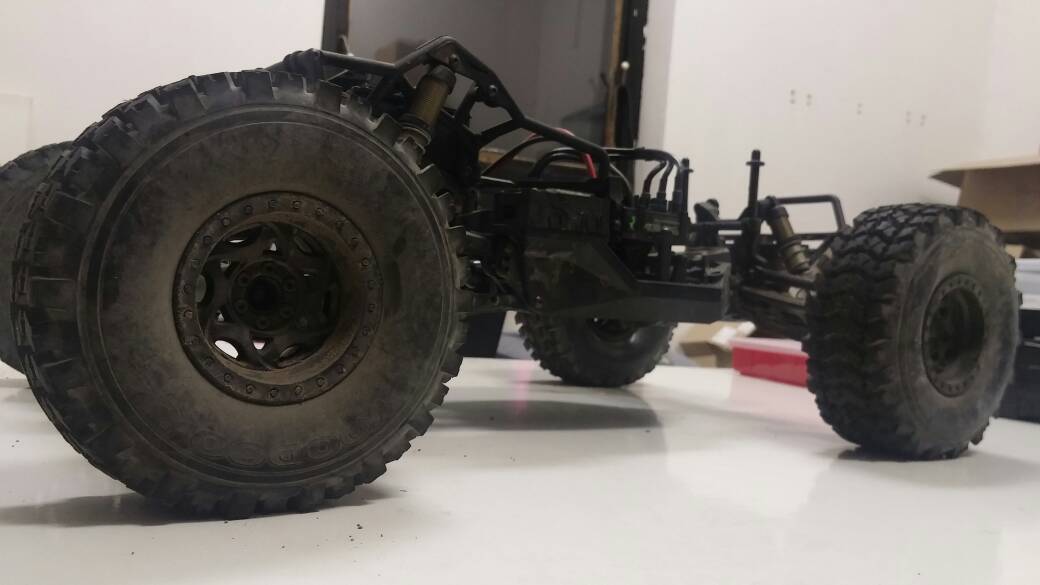

Here goes the Voodoos U4 with Deuce's Wilds inside - feels like completely different car on the road ;) Much better handling, not too prone to rollovers in highspeed turns. Nice!
Yep, I lost right swaybar plastic piece right during my first ride :-D Waiting for replacement. New MIP C-Drive looks very solid! I was able to install it only this way - was not able to slide other end on transmission output shaft - very tight fit - I hope this way everything will be OK...

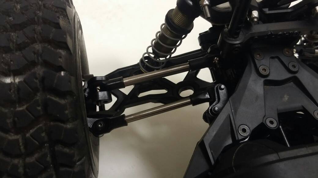

Titanium front links installed:
