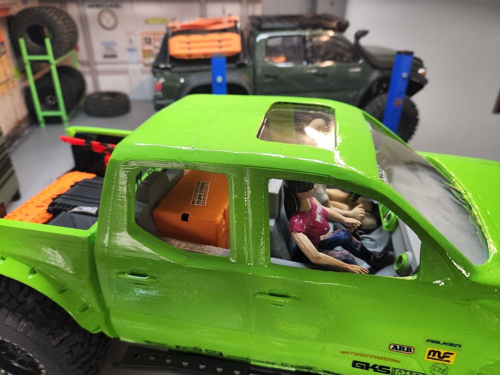

So being my lame skills with PETG thus far, I gave up trying to perfect the body. Instead now (except some of the seams not being as clean as I'd like due to being too uneven) I'm going with its got "trail damage" lol. Once paint dries cause I found paint in the green I wanted which was only a couple shades more green than the print, I can add stickers and clear coat.
Today's real progress:
I'll let the pics do the talking. One note, petg and model paint don't play nice together along with rather thinned new jars of paint, getting clean lines with layer lines wasn't happening.

Wow! Great job on the interior!"thumbsup" That turned way better than I would have imagined! Your 3D design and print skills are top notch!
I'm not sure how similar PLA and PETG is, but I've had great luck with the cheap Walmart acrylic craft paint. I coat it with a clearcoat spray to keep the elements off of it and make it last.
Thanks!
Credit for the design goes to Knight Customs. Knightrunner interior, of course seriously tweaked to fit. The decals for gauges and the head unit are actually from the GK kit decals lol. Fit perfectly.
I don't have a good understanding of the differences myself other than PETG handles much hotter temps without warping. But it's a much bigger PITA to get to print decently. I just happened to find that Model Masters paint sticks better to PLA when applying. Seems fine as the paint starts to dry, like it takes a bit of time for the paint to bind to PETG at all.
