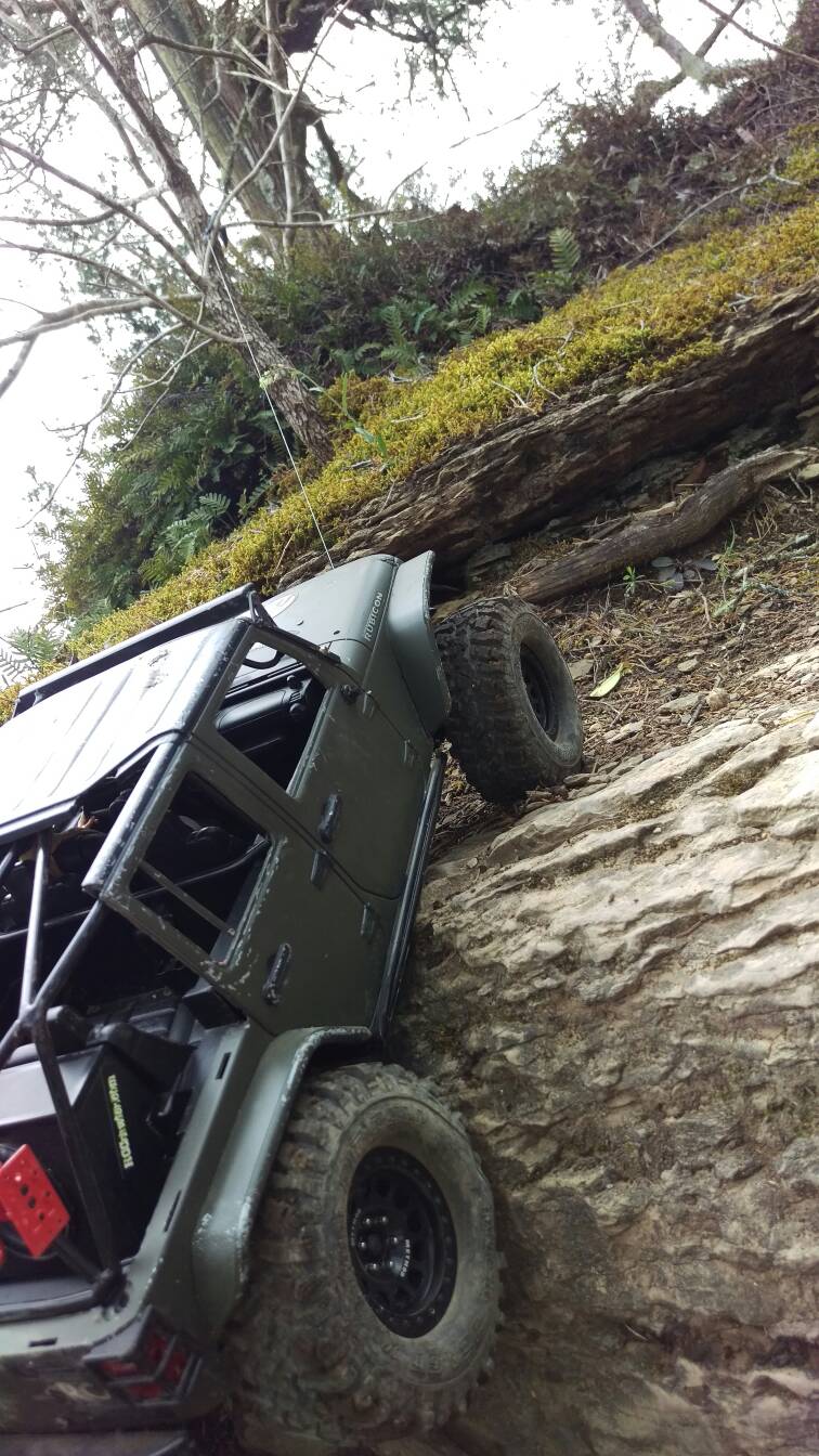

Thanks Matt. It's definitely got some character now after hitting the cave at cedars. Gonna attack the trock Saturday with it.

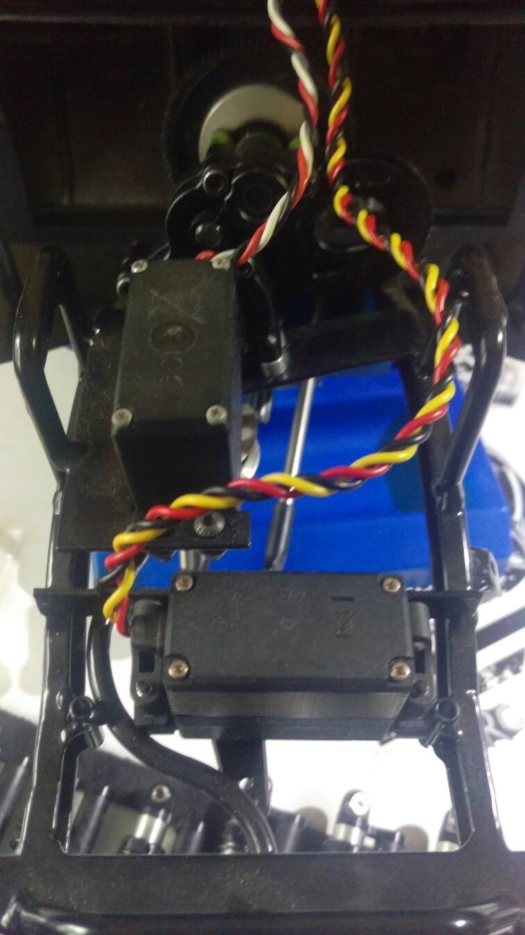

Hooked up my heyok light controller. It's definitely bright on 3s. Still need to figure out which light kit I want to get for the headlights and taillights. Swapped to some .725 hubs and threw some VP knuckle weights on it for this weekend.

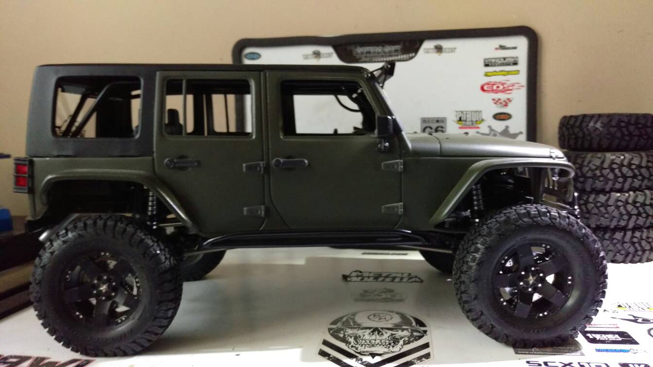

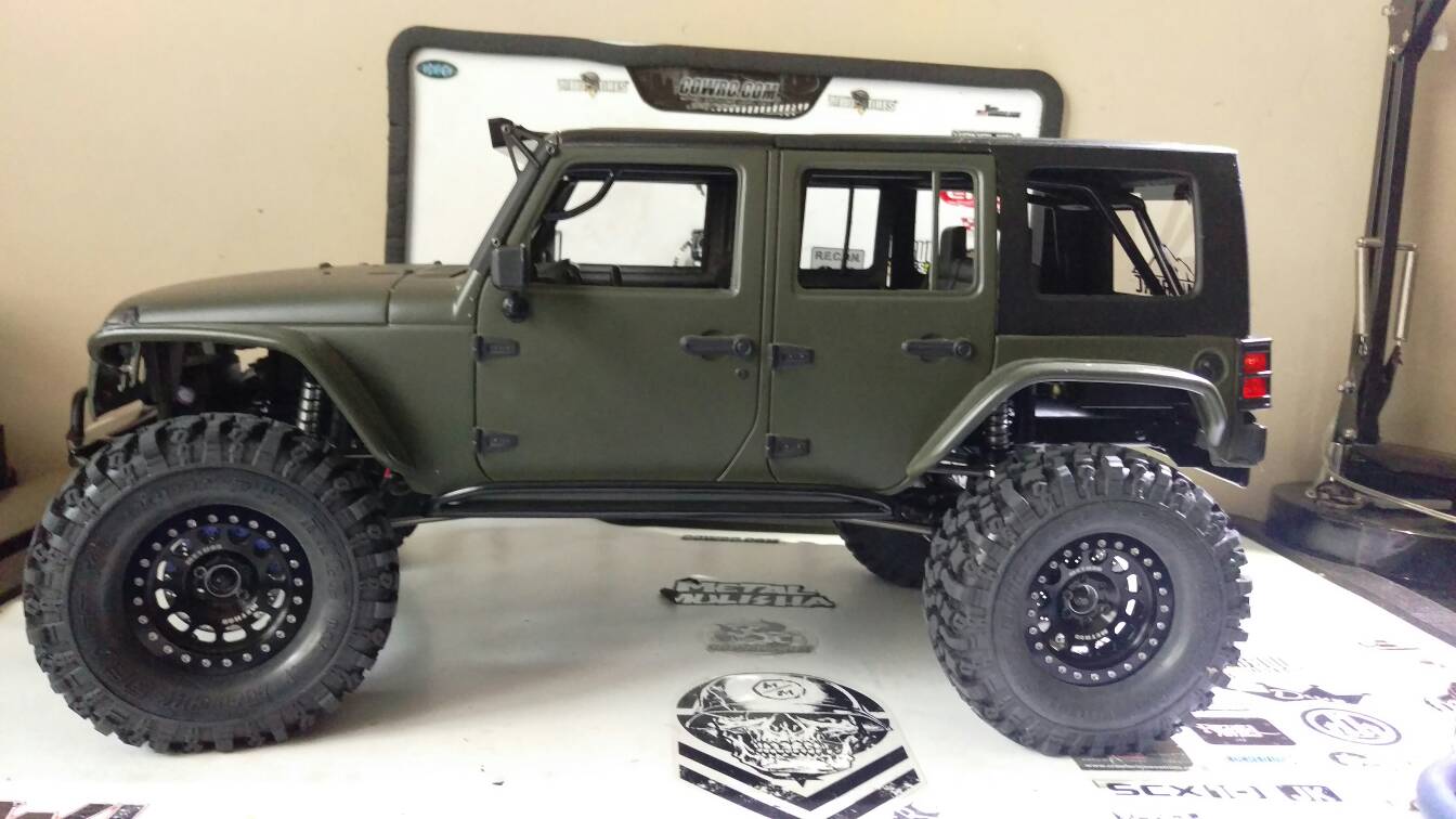

JK looks great, best with the Pitbull Rockbeasts and wheels, nice place to play too! What a score on the body and chassis. 8)

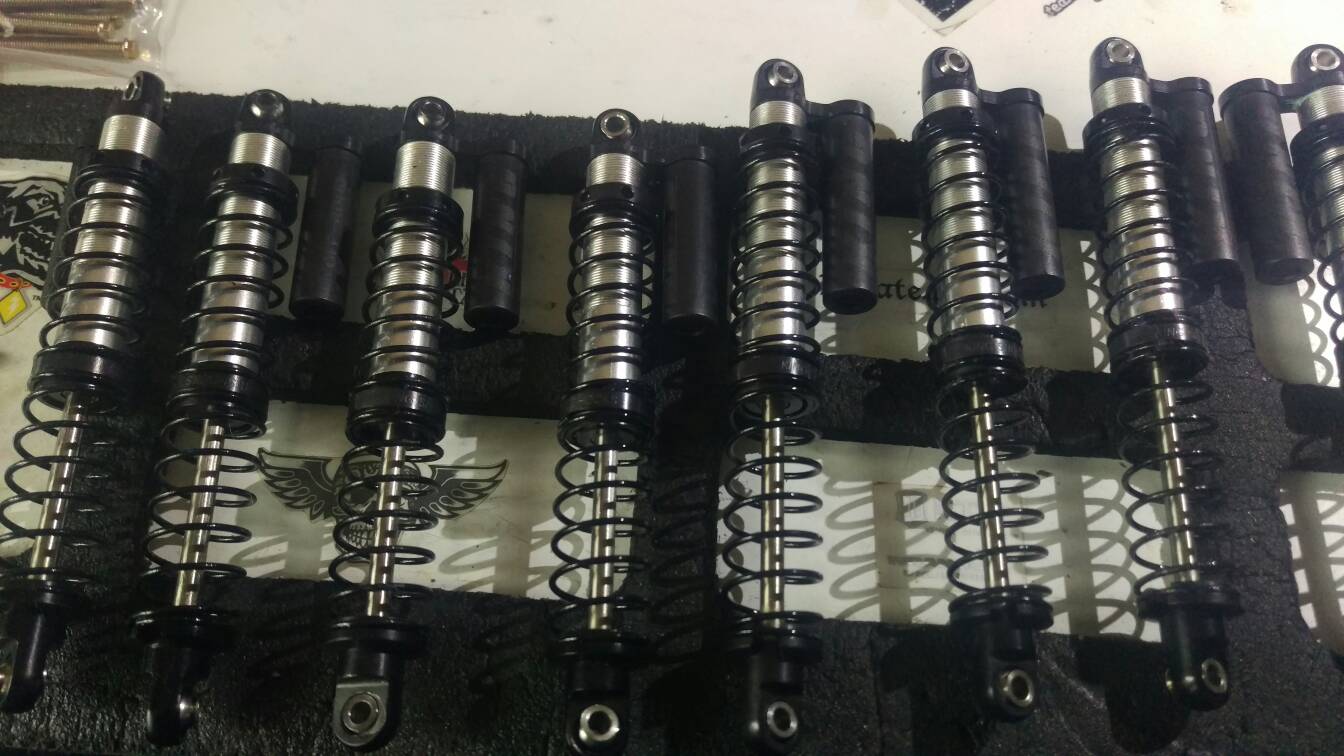

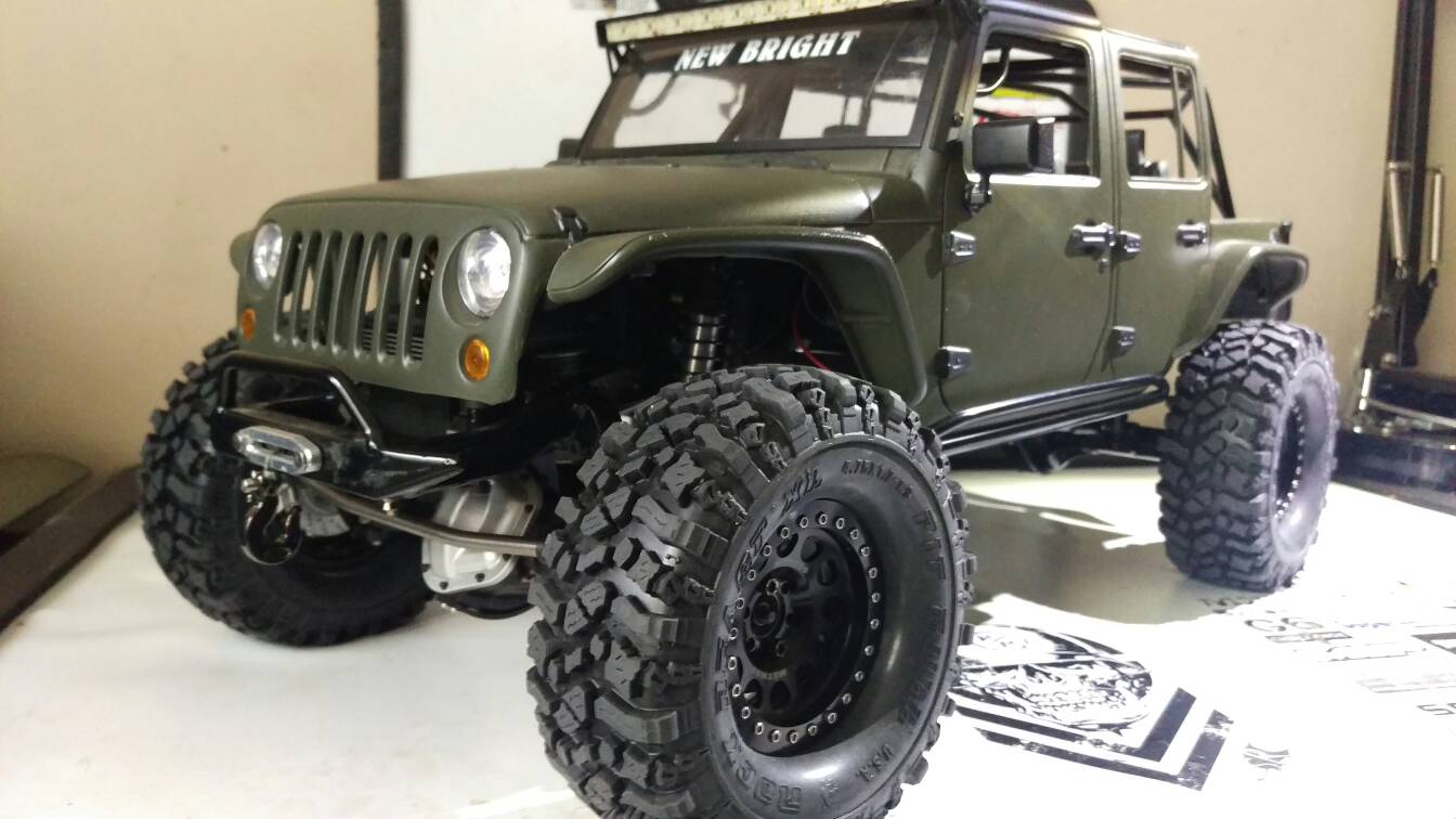

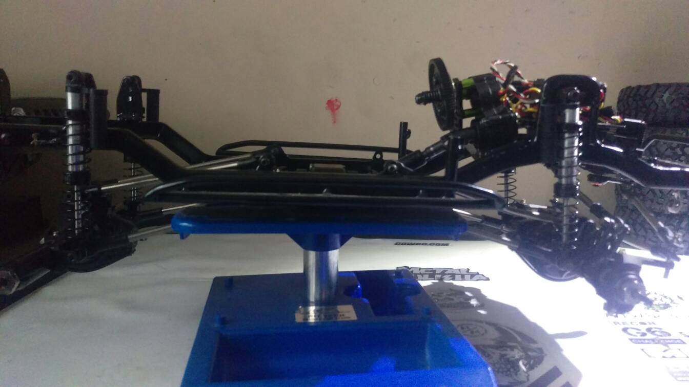

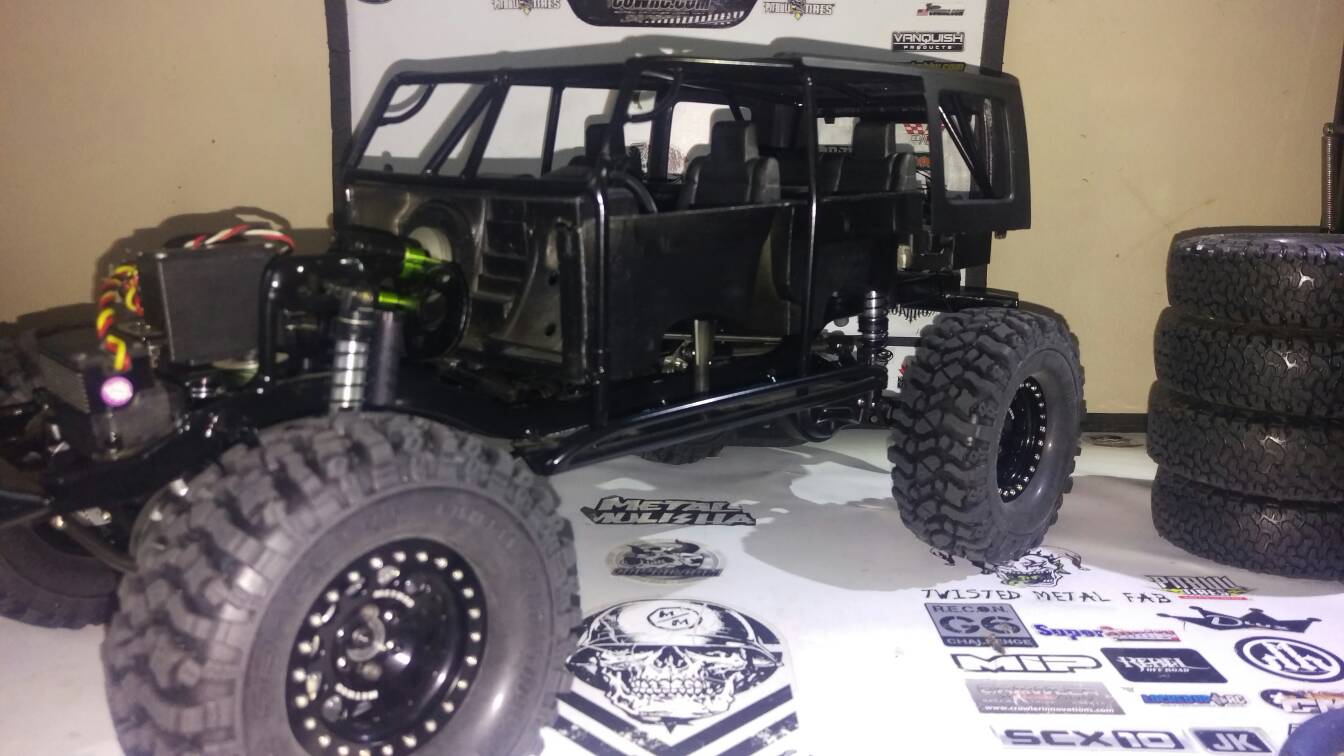

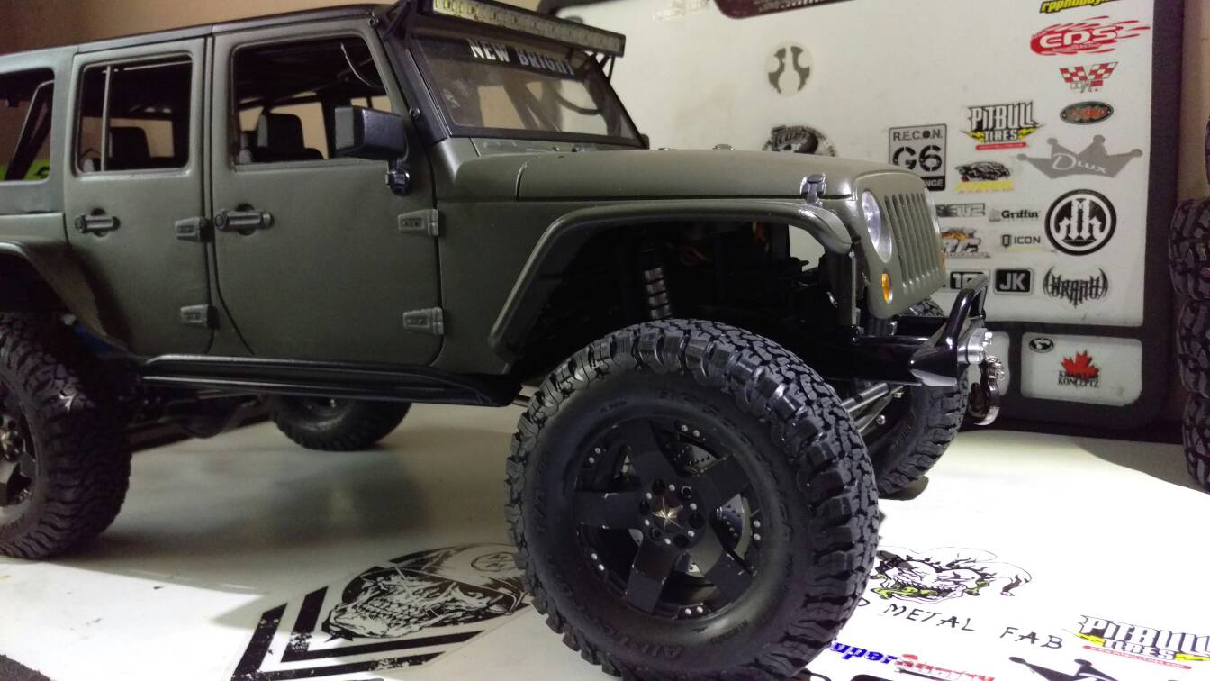

So I figure buy another almost complete rig and cut out all the build :lmao: So I'm building another new bright jeep. But this time it has a chassis and cage built by one of my favorite builders from a few years back ScaleReady. So many options were offered in my wanted add but this stood out, it was well built, with nice parts, most of which I would have done myself if I was piecing it together. So Much so that i didnt need the wheels and tires because i already had the same set waiting. I am super excited to get started on this and see where this Jeep will take me. I got it in today and tore right into it Mounting up the 100mm king shocks, made some link adjustments and lowered the body about 3/8 of an inch. Sits really nice now. Got some limiting straps on the way for it to limit some flew and keep it low. needs a couple more things and it will be ready to rock

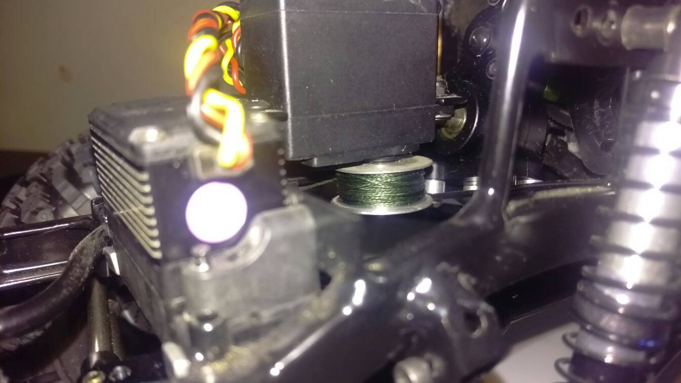

TowerPro Servo winch

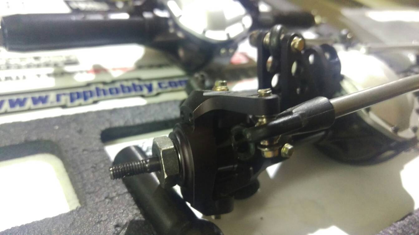

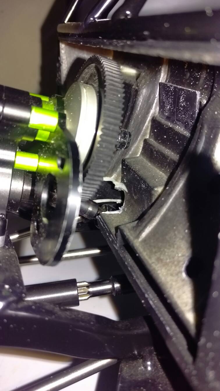

Got to take out the Jeep for a little bit today. Crawled great till I broke the xvd shaft where the hex pin goes though. Guess I need to find something stronger. It really needs some scale accessories.

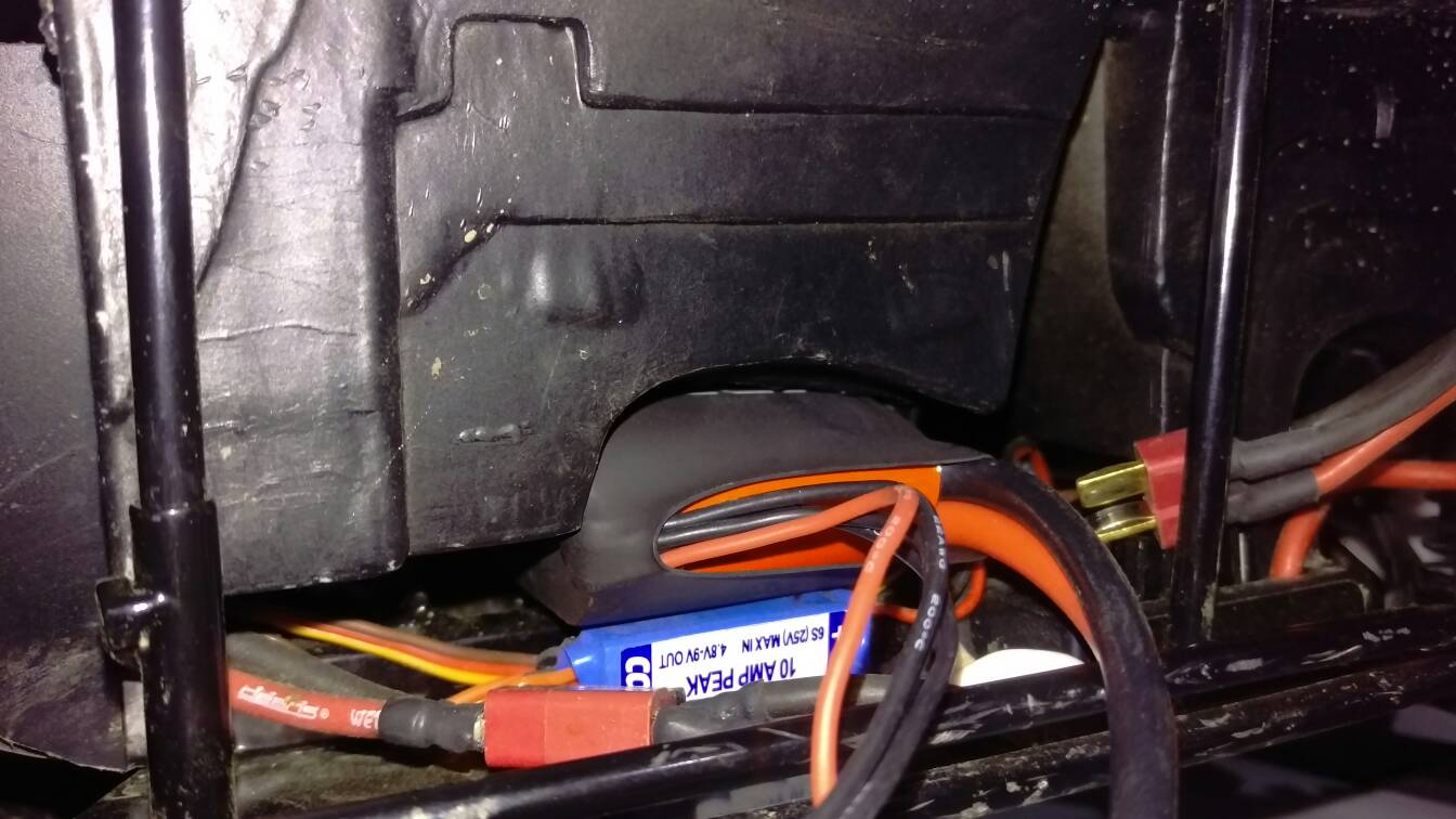

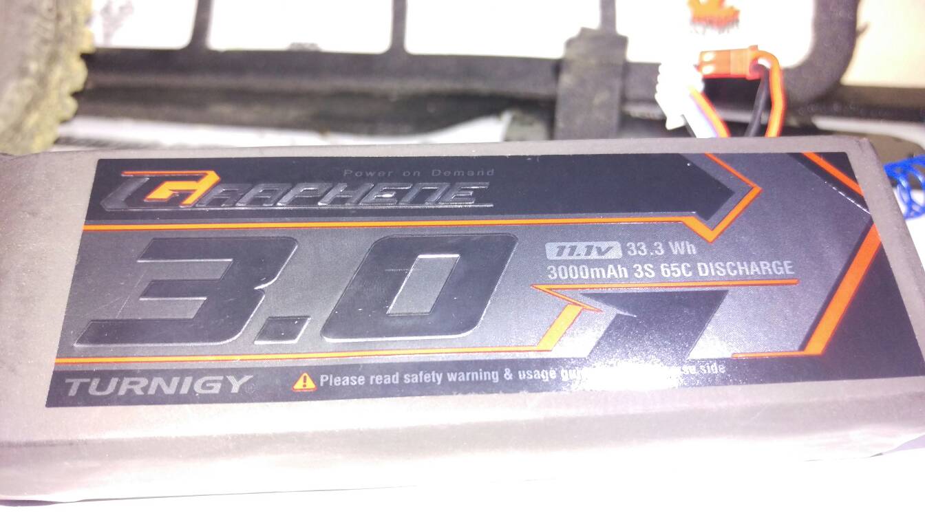

Finally got my batteries in today. Some Turnigy Graphene 3s 65-130c 3000mah that fit perfectly under the front seat. Also got in my little 3s battery for my lights. Don't plan on using it much so hopefully 370mah will last. Might be a little to small. Now I just need to make a battery tray and swap these over to deans.
Sent from my HTC6535LVW using Tapatalk
Swapped out my broken RC4WD XVD’s to some new vanquish VVD's. Shouldn't have anymore driveshaft issues.

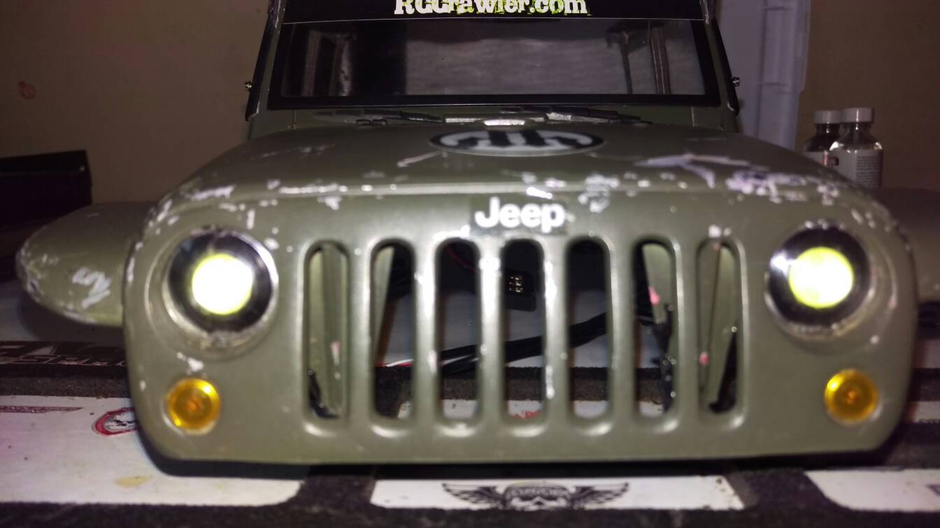

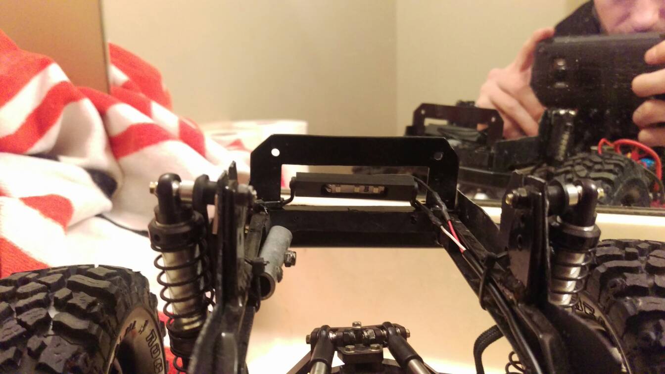

Hooked up some eagle eye headlights and a 2" light bar under the drop bed. It's pretty bright setup with the lightbar up front. Love the heyok controller and being able to cut it on and off with my 4pls.

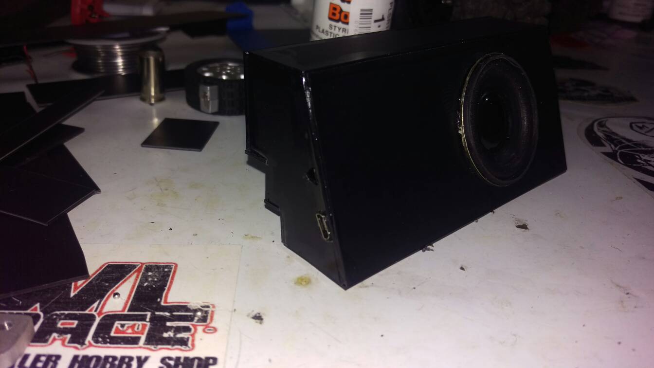

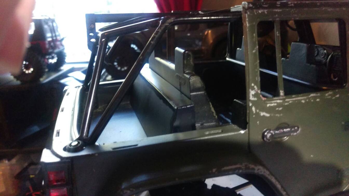

Worked on the bed a little more. Decided to take a different route and put in a bigger box. Started off with a simple speaker from the dollar store, cut it up and rewired it. Mounted it up in a styrene box.

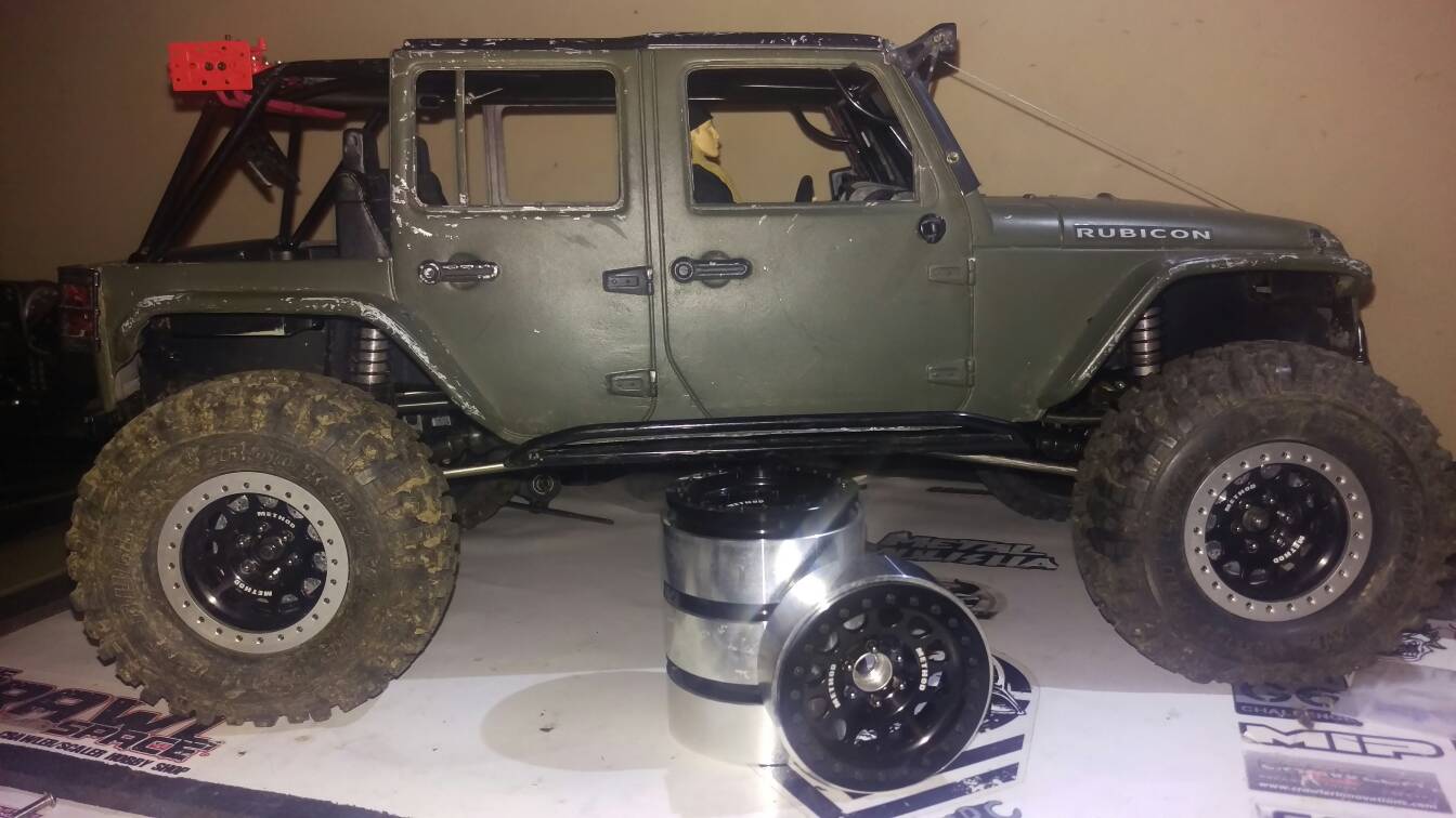

Picked up a spare set of wheels and some silver beadlock rings. Never really been a fan of silver rings but I'm liking this. Might have to swap one set over.

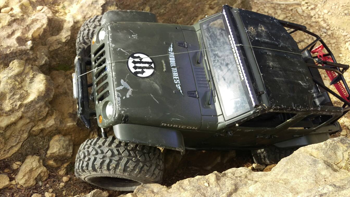

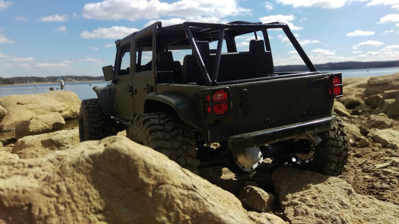

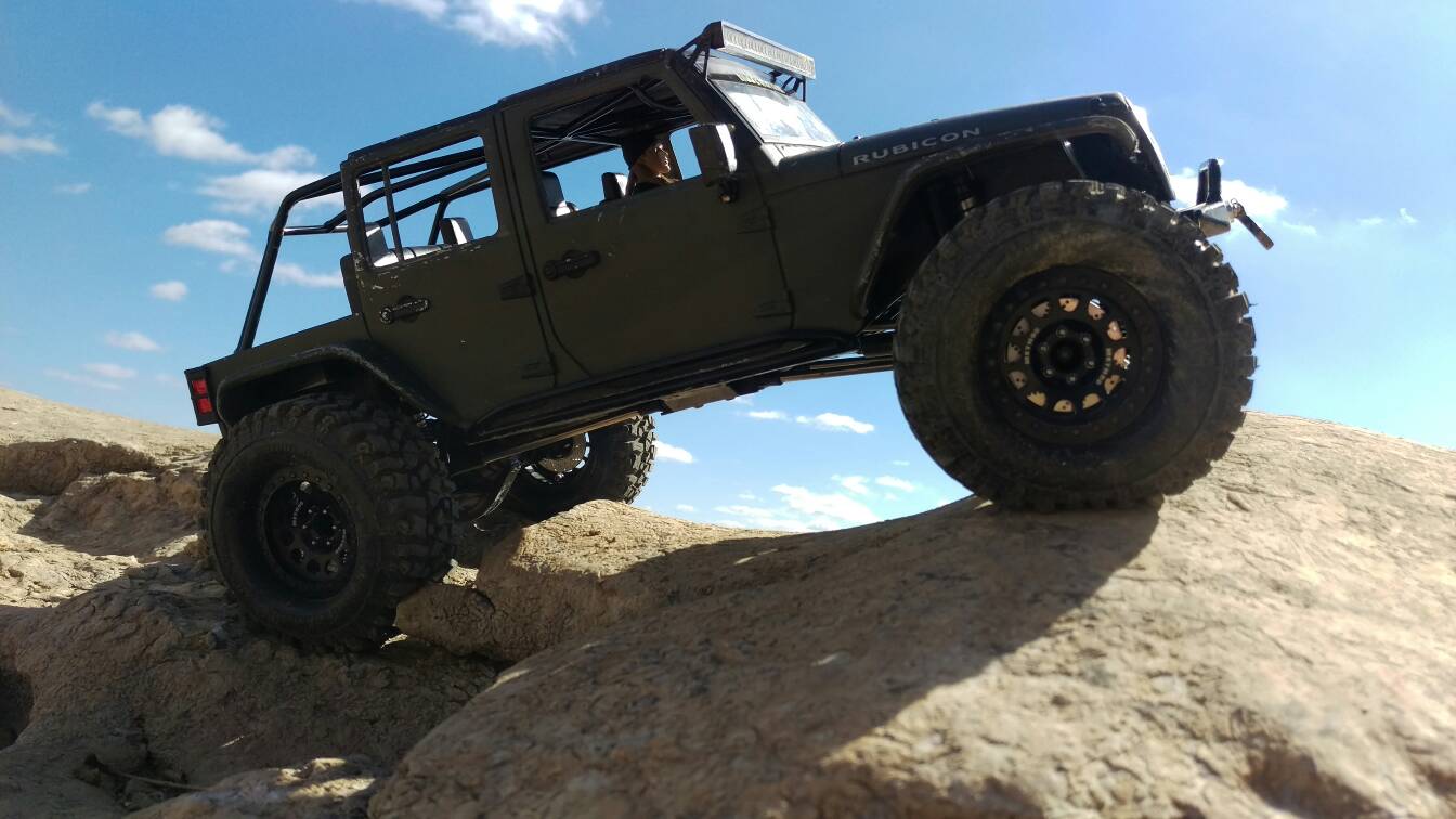

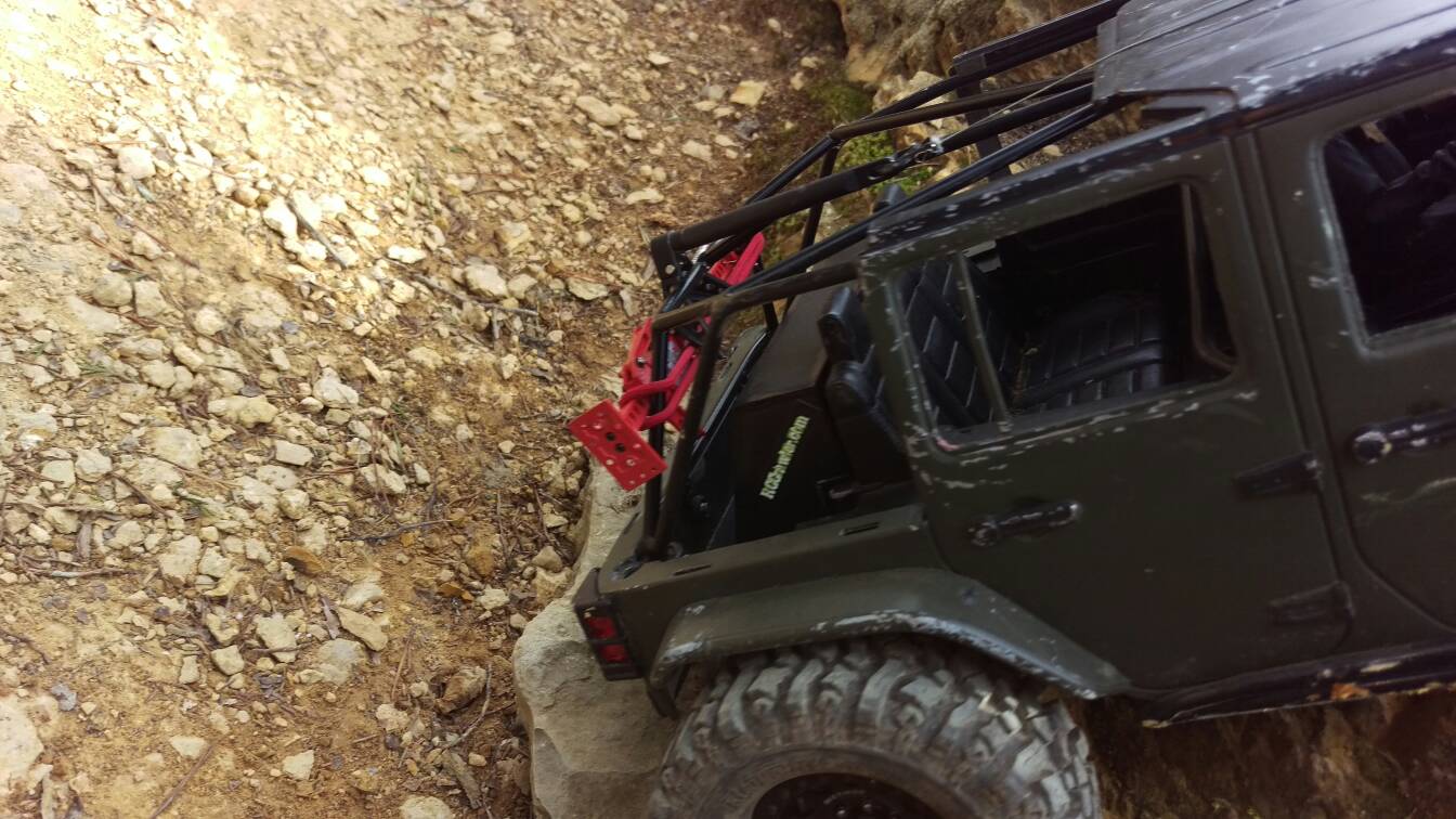

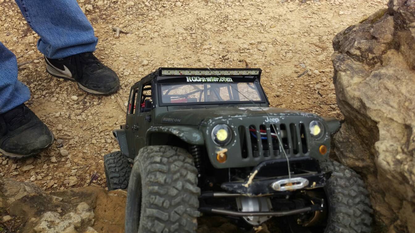

I got to take this out and beat on it today. It's such fun lil jeep. It's way to heavy so it makes everything a challenge. I need to get it on a scale, I may try to do that this week. Anyways, here's some pics from today.
