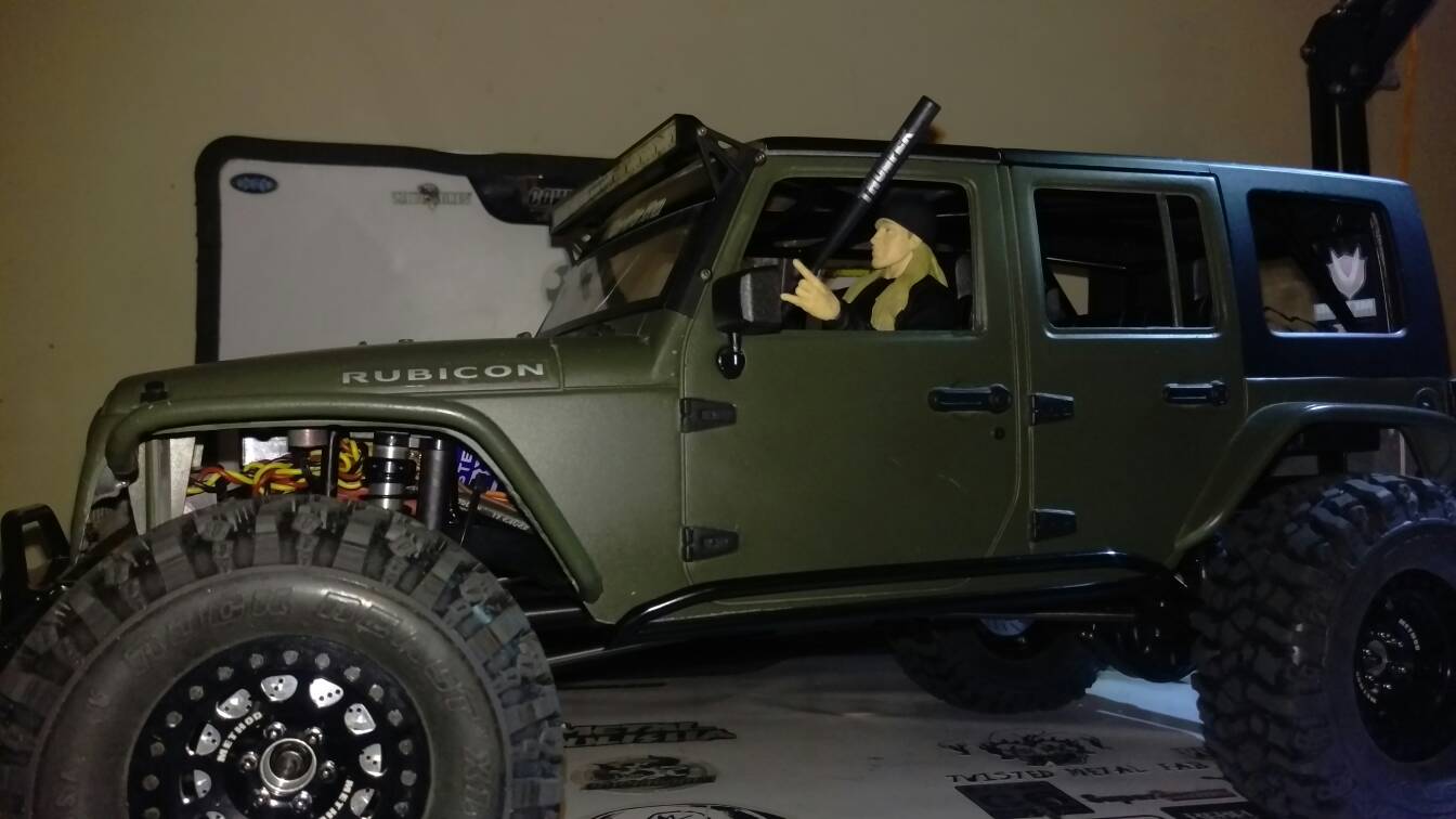

So I figure buy another almost complete rig and cut out all the build :lmao: So I'm building another new bright jeep. But this time it has a chassis and cage built by one of my favorite builders from a few years back ScaleReady. So many options were offered in my wanted add but this stood out, it was well built, with nice parts, most of which I would have done myself if I was piecing it together. So Much so that i didnt need the wheels and tires because i already had the same set waiting. I am super excited to get started on this and see where this Jeep will take me. I got it in today and tore right into it Mounting up the 100mm king shocks, made some link adjustments and lowered the body about 3/8 of an inch. Sits really nice now. Got some limiting straps on the way for it to limit some flew and keep it low. needs a couple more things and it will be ready to rock

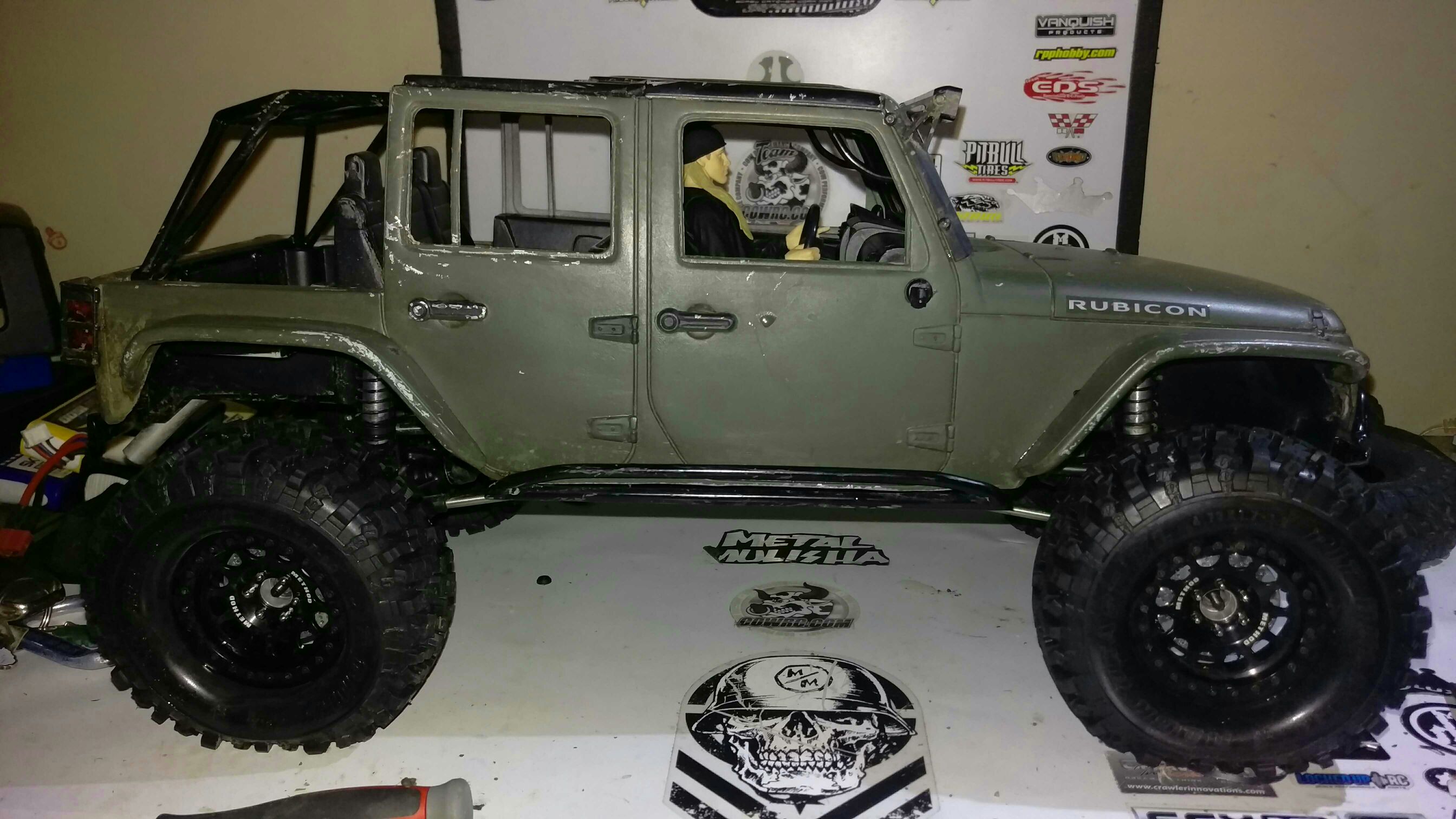

Had to dremel off what was left of these body mount tabs. The king reservoirs were to close for my liking. Got them off and hit the raw metal with a quick little coat of paint. Reworked how the trans was mounted to allow for a little more motor room. Then started changing out all the hardware on the chassis to scale hardware. Motor and receiver will be in today. It could actually move under its own power today. [emoji2] now I just need to order some 4000 or 5000 3s batteries to sit under the front seat across the chassis

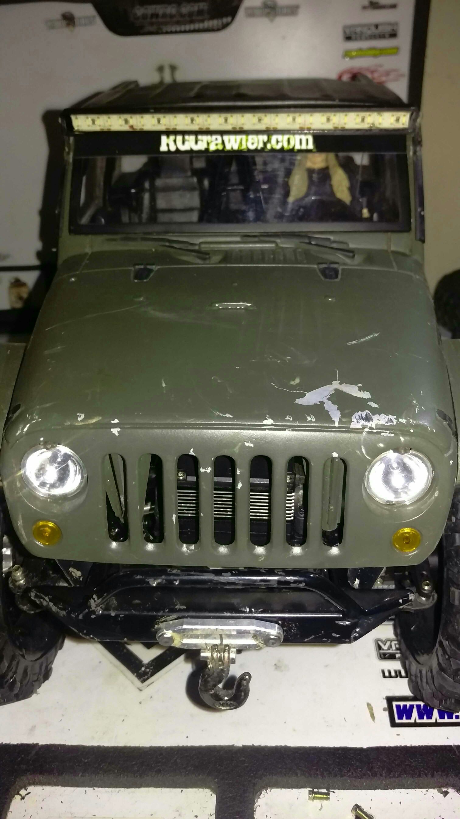

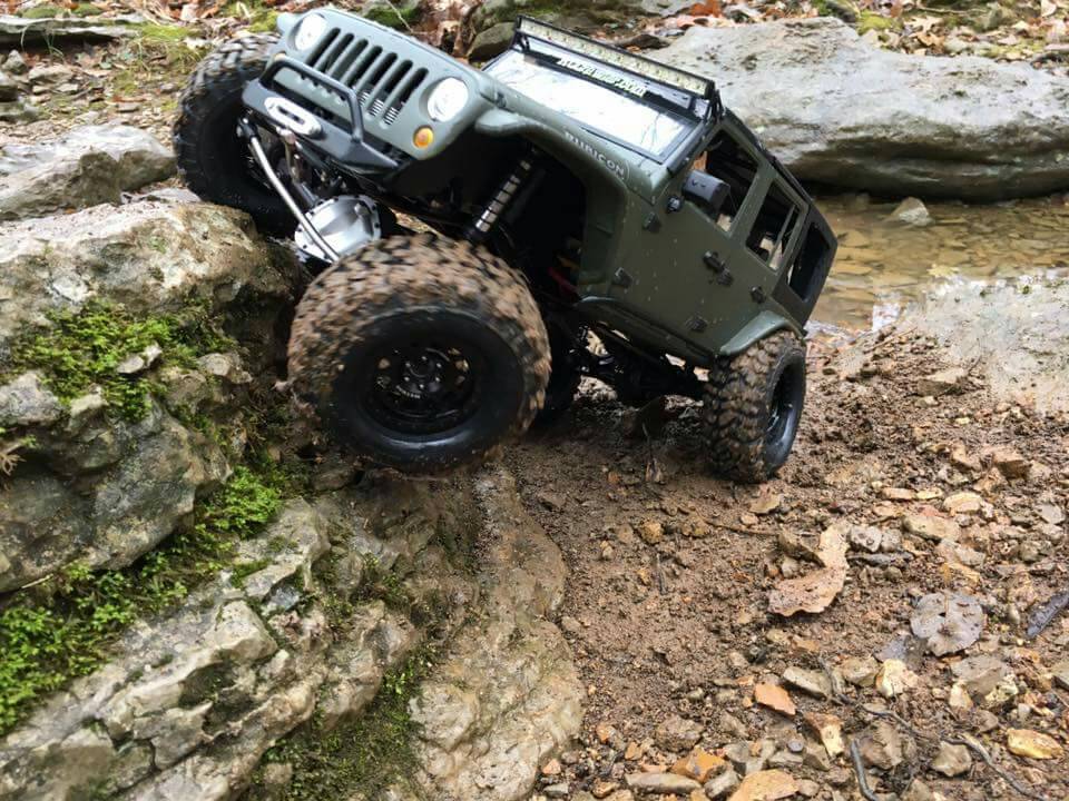

Well it's officially not a shelf queen and definitely not new now lol. Took it out with some friends to test it out. It crawled pretty well. Sidehill was one of the first things I notice needed attention. I came home and installed the limiting straps to help with this. Otherwise it needs a little weight up front, not much. I'll address that later. It could use a little more power. The 13t is quick but it was wet and muddy today and more wheel speed would have helped a few times. The body took a beating today. A couple hard falls and the body already needs shoe goo. I had a blast with it. Super happy with it and can't wait to see what some tuning can make it do.
Sent from my HTC6535LVW using Tapatalk
Re: Kj's Jeep JK "Holy Grail"

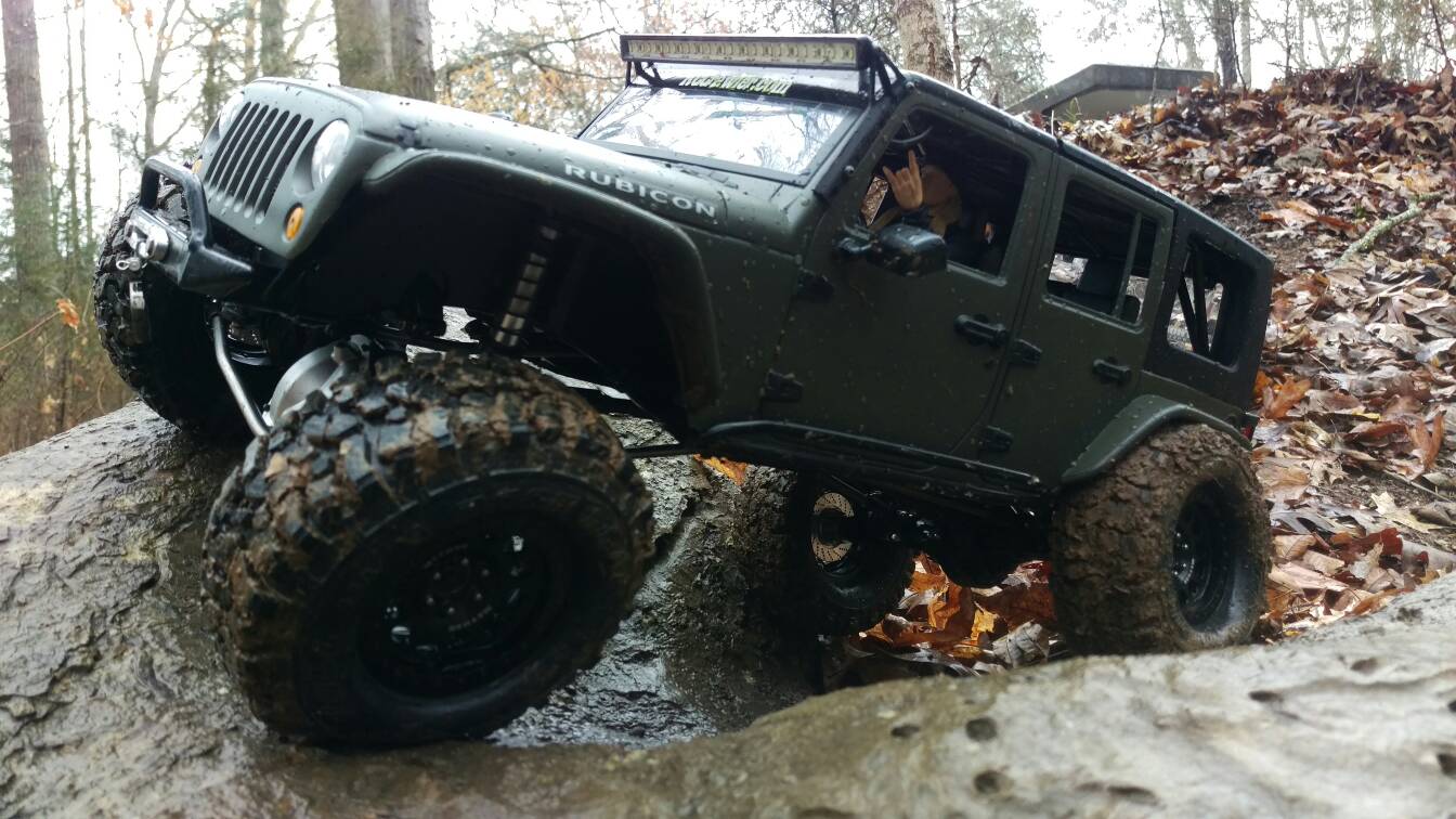

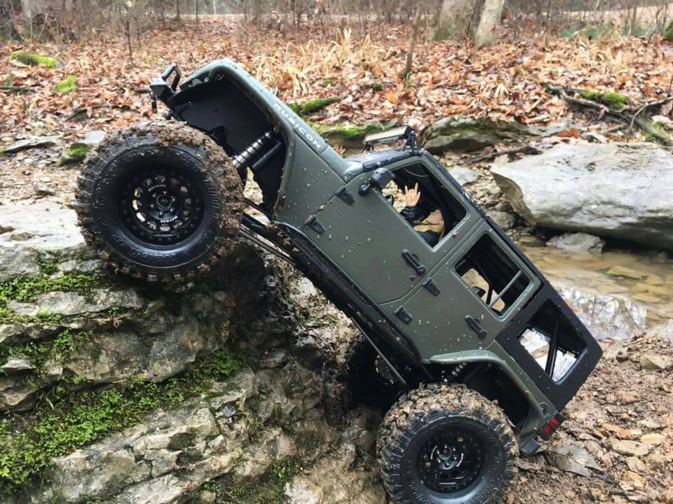

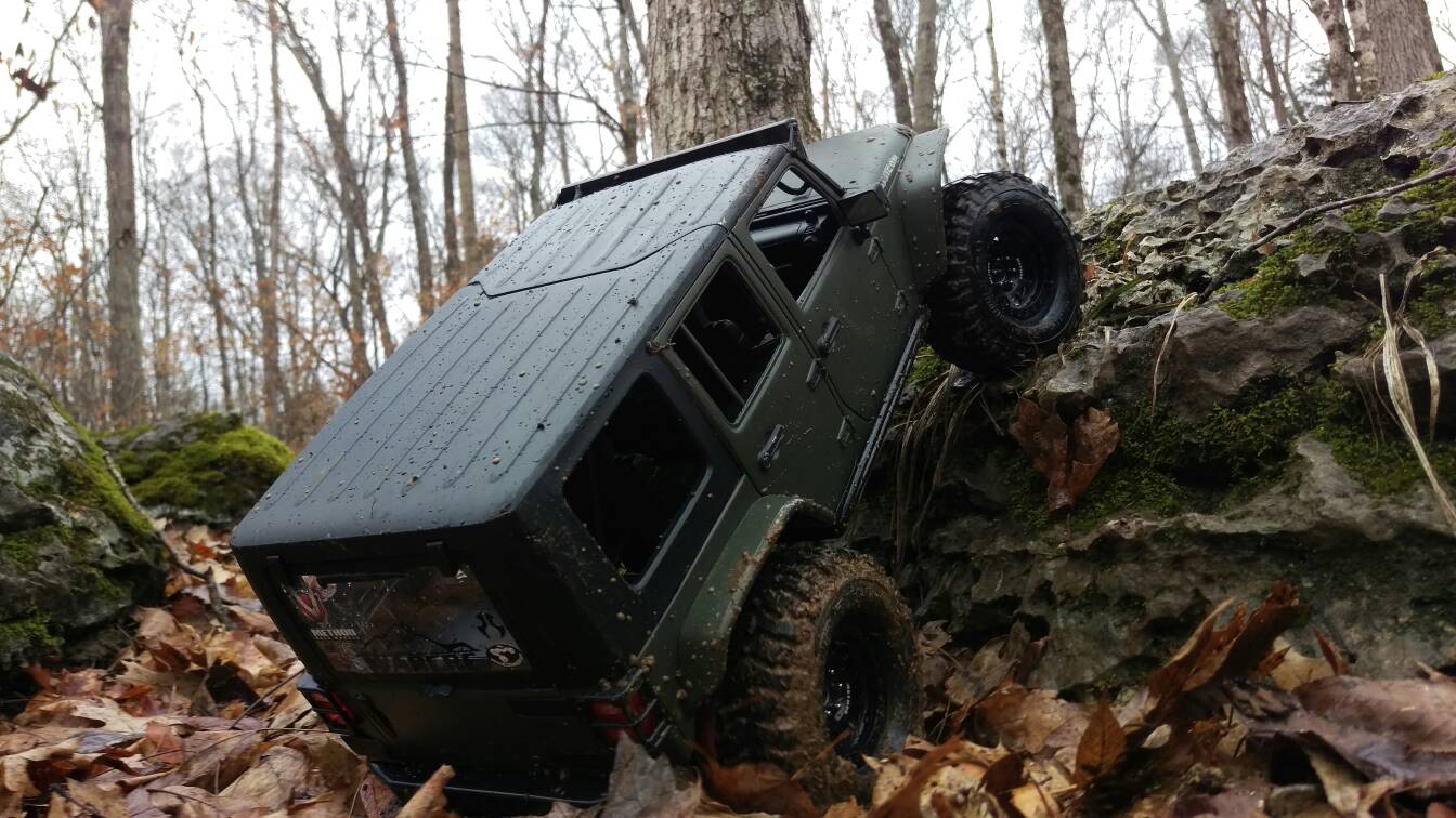

A couple of pics a buddy took from yesterday.
