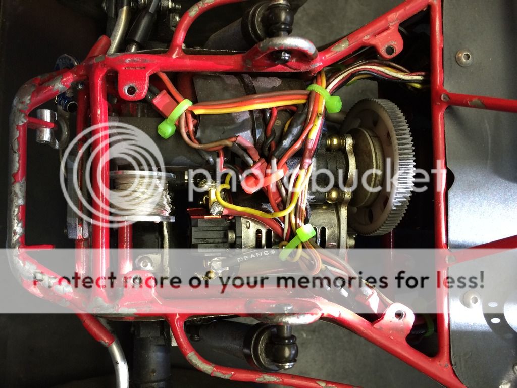

Scott-- my winch was a home brew savox 1230 with a locked up spool. I cut the uneeded part of the case away to make it all fit. Savox servos are cool for this because the lower part of the case doesn't really support the motor like on hitek. There's two screws that go in through the top gear case into the motor. The 1230 is a cheap torque monster as well.
The other thing you asked about was the battery location. At one point I had it skid mounted but it seemed dangerous since it took so damn long to dissconnect in the event of an electrical issue. I moved it to the center removable console, just use a little piece of foam to make it snug in there. It's fit around a max amps 900 but fits all the common 850 ish mah packs as well.

I was looking at it last night, I have a preliminary layout in my head for the electronics. Looks like there is just enough room.
Gotcha, that makes sense with how the space is there for the winch. I was thinking about just running a KMS winch the other way. I will take a second look at that tonight before I strip it down for powder coating.
That location makes sense, nice and easy access. Good thing I have some 850s lying around!!

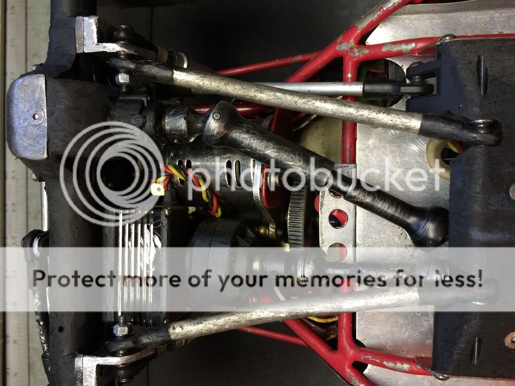

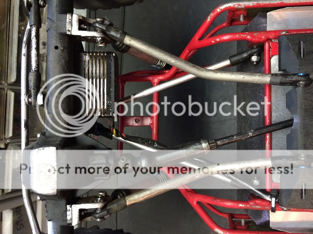

Hey Scott, here are some "packaging" pics I dug up. Now that I look at these, make sure you mount the front shocks similar to this, otherwise you may have clearance issues.
Can wait to see this all cleaned up with your own spin on it"thumbsup"
