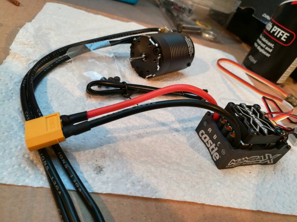

The 3800kv combo arrived so im keen to get it in and tested today if I can.

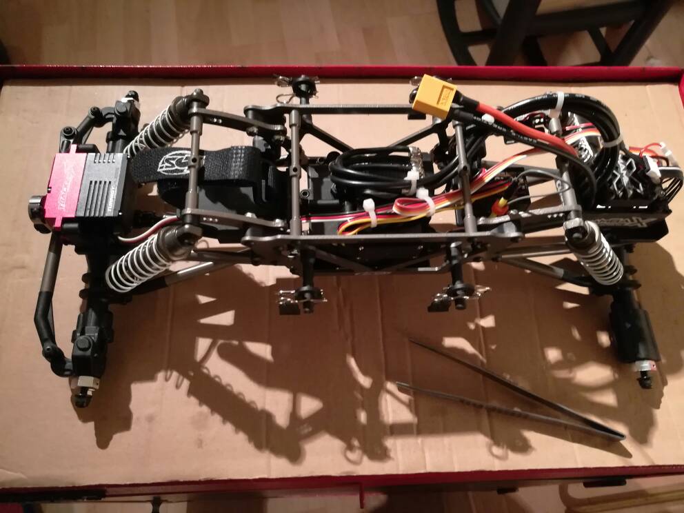

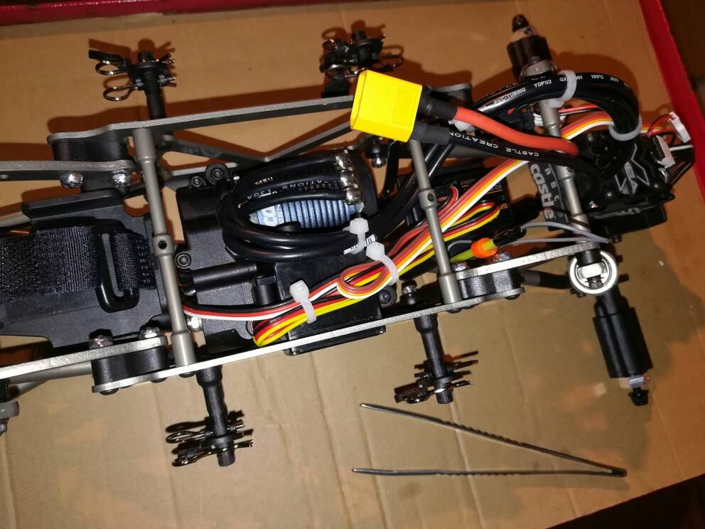

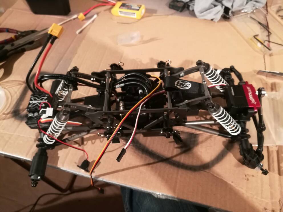

Its almost done,want to try some spiral binding wrap or something to get the loom secure but its quite tidy.
The ESC is a fair size and the supplied power lead is just long enough to be comfortable,this might get moved yet....thats an expensive piece of kit to be hanging off the diff housing.
Ive had a tinker with the castle link programming too,very nice,some great settings for all sorts of setups.
If it can supply the torque it suggests I might stick with it but ive got a feeling the lower 2850kv on its way will be the better option.
Its still totally stock running a 13t pinion,no weight has been added as of yet anywhere so ive lots to do in time.
Gonna stick some wheels on it later and see what I think.
