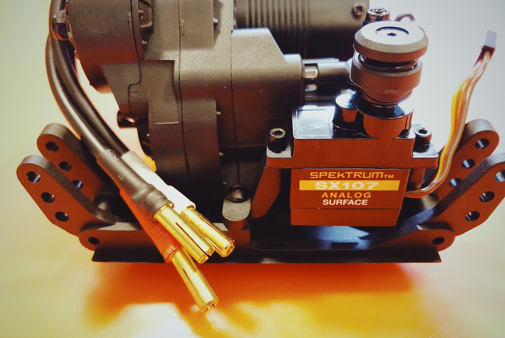

I went with a Holmes Hobbies Stubby Puller Pro 2200KV brushless motor. I had this for another build, but I think it will do well here. I got that little Spektrum servo in there for the dig. Let's see how it holds up.
