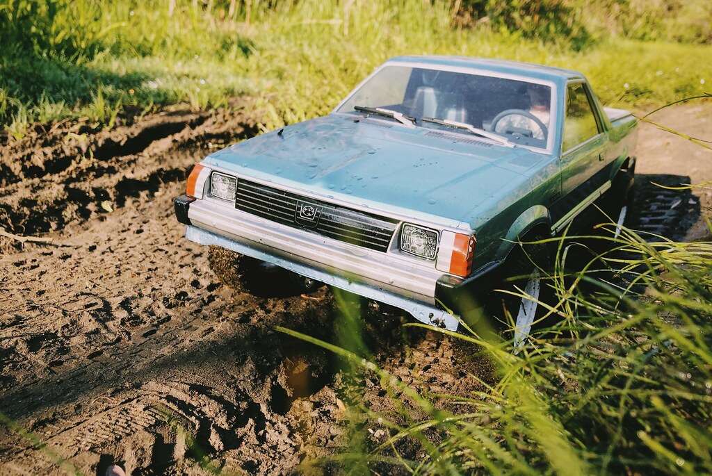

I've got some shots of this thing on my kitchen table, but no one wants to see that. Here are a few glamour shots of the little blue Subaru Brat in the great outdoors before it gets chewed up out on the trails...

I never knew 1.55's could look so big! that thing looks really good for a lexan body. I like it "thumbsup"
The Brat had its first outing. With minimal ground clearance, tiny tires and big overhangs, I went to a location that I thought would be a nice easy drive.
Nope.
We had gotten some snow previously, but it had warmed up and a lot of it had melted. Then things got brutally cold. What I hadn't anticipated was that over half of the trail would be blanketed in 3 inch deep, icy, rock hard, frozen footprints. Oof.
As I started down the trail I thought about turning back. Then I had a brief conversation with Steve Man who said "We don't build shelf queens. Gimme the keys!"
The truck performed admirably in conditions that it had no business performing admirably in. The front lip of the body ended up taking some damage. There was a little chipped paint and a small crack. The cold weather certainly didn't do me any favors there. I'll make some repairs and have it back on the trails in no time.
